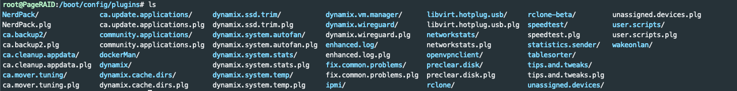

Nothing obvious. Delete all .plg files in config/plugins and see if it boots in normal mode with no plugins.
I see lots of folders as well as .plg files. Should I leave the folders and just delete the file?
Nothing from the folders will be loaded without the corresponding .plg file
