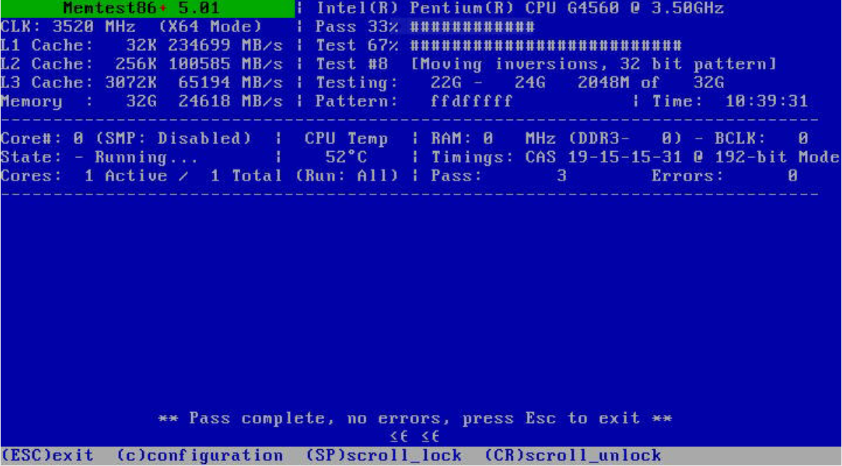

You should format but checksum errors are more likely caused by bad RAM than de NVMe device, you should run memtest.
Thank you for your help @johnnie.black. OK I will do that. I bought the more expensive ECC type of RAM hoping to avoid this kind of issues. But I guess ECC RAM can be faulty as well.
It can, but it shouldn't cause data corruption, it should correct single bit errors or halt the system if an uncorrectable error is detected, you can post the diagnostics, maybe something else visible.
OK. Here it is. Thank you in advance.
Edited by Opawesome
Deleted diagnostics

Something is corrupting the data, #1 suspect is usually RAM, but with ECC I would try another NVMe device first if possible.
OK thanks. Indeed I forgot you suggested running a memtest.
Mestest shouldn't detect any errors with ECC, since they would be corrected, unless something isn't working properly or ECC is disabled in the BIOS.
No errors after 10+ hours of memtest86. I will let it run for another 10 hours and if still no errors show up I guess I will try a new NVME SSD (hoping really hard that this is not the motherboard)
