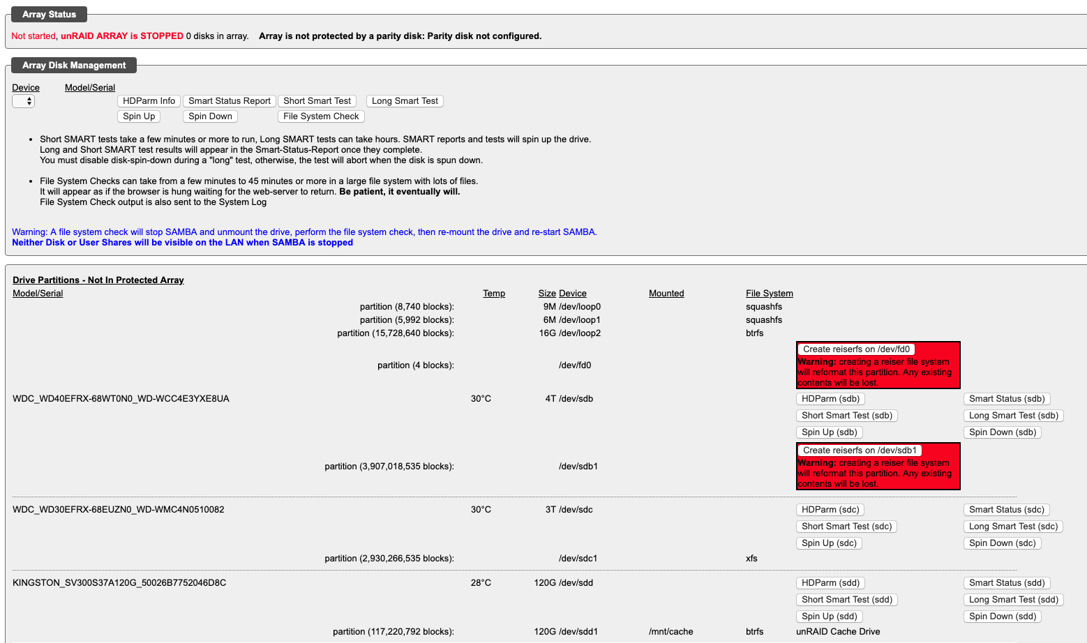

Under Disk management it warns "array management - array status"  : Not started, unRAID ARRAY is STOPPED 0 disks in array.    Array is not protected by a parity disk: Parity disk not configured. (Photo attached)

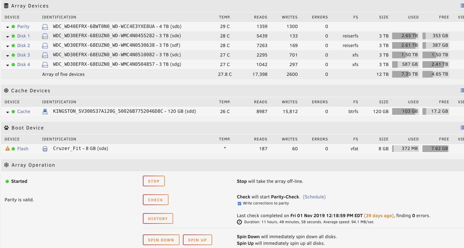

However, under "Dashboard," everything is loaded and states it is protected by my parity. (Photo attached)

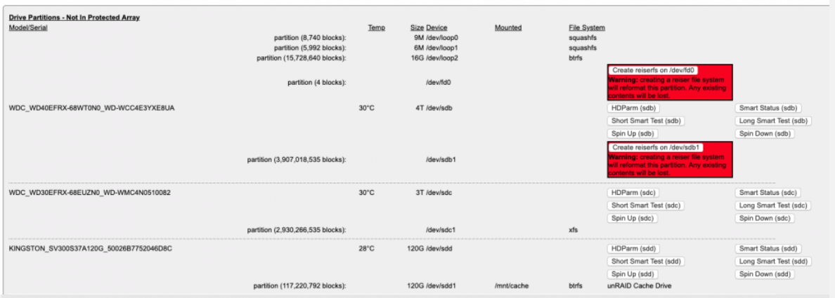

Can someone help explain this to me along with the red warning blocks? The drive that it refers to is my parity drive.

Array looks normal to me, where's this from? It's not stock Unraid.
It's saying parity doesn't have a filesystem, as it shouldn't, same for a floppy device.

I never remembered till now, but it is a very old plugin called unmenu, circa 2013 or so when I first put it together. I don't even know how to get rid of it!

UnMenu is not compatible with current versions of Unraid and has not been for some time.    I am extremely surprised if it is not causing major problems.

unMenu is not compatible with Unraid version 6 and higher.
Please remove it (edit your 'go' file)

I suspected it could be that, but it looks different from what I remember, you should definitely remove it from Unraid 6.

You only need this one line
/usr/local/sbin/emhttp &
Note: if you want the GUI to work on a different TCP port, see Settings -> Management access
(I recommend to use the regular TCP ports unless there is a port conflict)
See also this for upgrade instructions and get rid of legacy stuff
