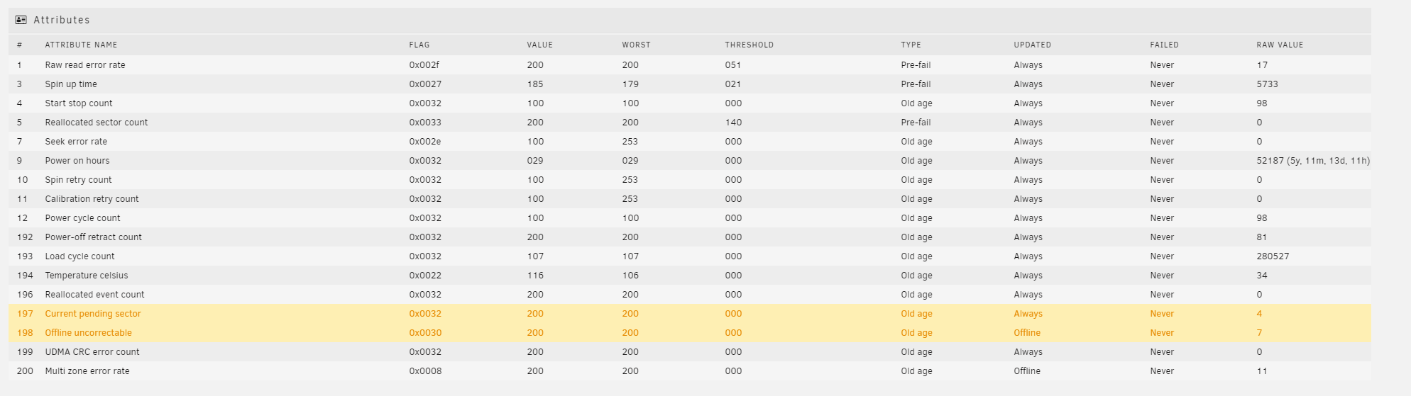

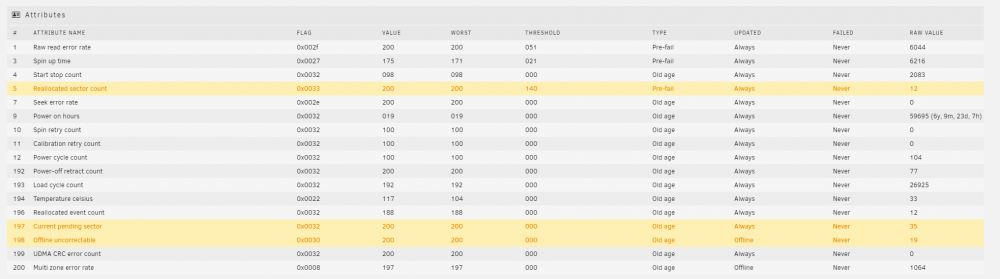

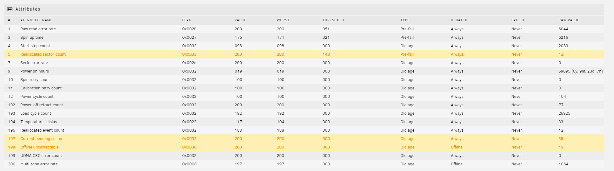

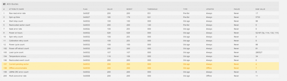

Thats fine. It will be a while before its all been used 100% Even tho my drives were find in my Synology NAS - UNRAID is showing errors with 2 drives.
So once the Parity Sync is done I will need to swap out those 2 disks which are showing as faulty.

SMART errors or read errors? Some SMART warnings can be unrelated to disk health, e.g. UDMA CRC errors, you can post the diagnostics if you want (tools -> diagnostics) so we can take a look.
Attached the errors to this reply. Copy and past didnt work to well.
From the research I have done - I think replacing them is the best option?

Usually yes, some time these can be false positives, you'll know after the parity check finishes, if there are any errors on the main GUI page for these disks they need replacing, you'll also get notified, if system notifications were configured, and it's highly recommended to do so.
Thank you for the extra advise - I have 2 x 4TB disks to swap out once the parity check is done and compleated.
