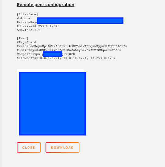

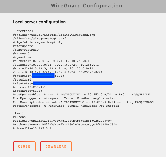

Using the wireguard plugin, i generated a tunnel and generated a client with remote access to lan. I used the iOS Mobile app to scan the config from the server. The iOS app "activates" and I can see small amounts of data sent and data received but no handshake occurs, and nothing is asseciable over the tunnel.
My server has a Ethernet bond that is set to bridge. Maybe network adjustments need to be made at the pfsense level?
Configs are attached.
