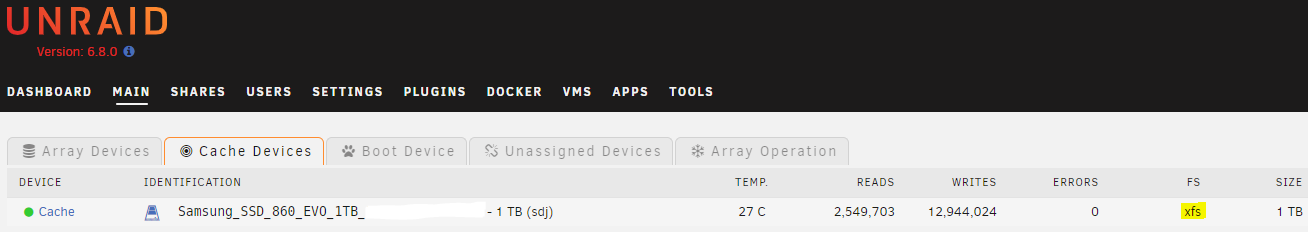

This may or may not be related, but it seems since installing 6.8.0 (12/27). I have been getting the following email from unRAID.
fstrim: /mnt/cache: the discard operation is not supported
I have had the Dynamix SSD Trim for some time w/o issues.
Could anything related to 6.8.0 cause this?  The only other thing I've done to my server recently is install this expansion card to add two more HDD's but I did not move my SSD off the MB controller.
https://www.ebay.com/itm/162958581156?ViewItem=&item=162958581156
Are you sure? That error suggests SSDs are on a controller without trim support, like that LSI.

my SSD is definately not plugged into the external. I just verified. It's plugged into 1 of the two SATA ports labeled as "ASMedia® PCIe SATA controller".  I'm 99.85% sure I didn't touch any existing drives when installing the card. Just for the two new 4TB Red's I added.  I have 1 spot open on the other set labeled "AMD SB950 controller 6 x SATA 6Gb/s port(s), brown"  I could swap too.
Trim doesn't work correctly on some older Asmedia controllers, and that might have changed with the newer kernel, try the board chipset ports instead.
I'd already started that process just to see.  It appears it did not change anything.
~# fstrim -v /mnt/cache
Please start a new thread on the general support forum and post the diagnostics.
