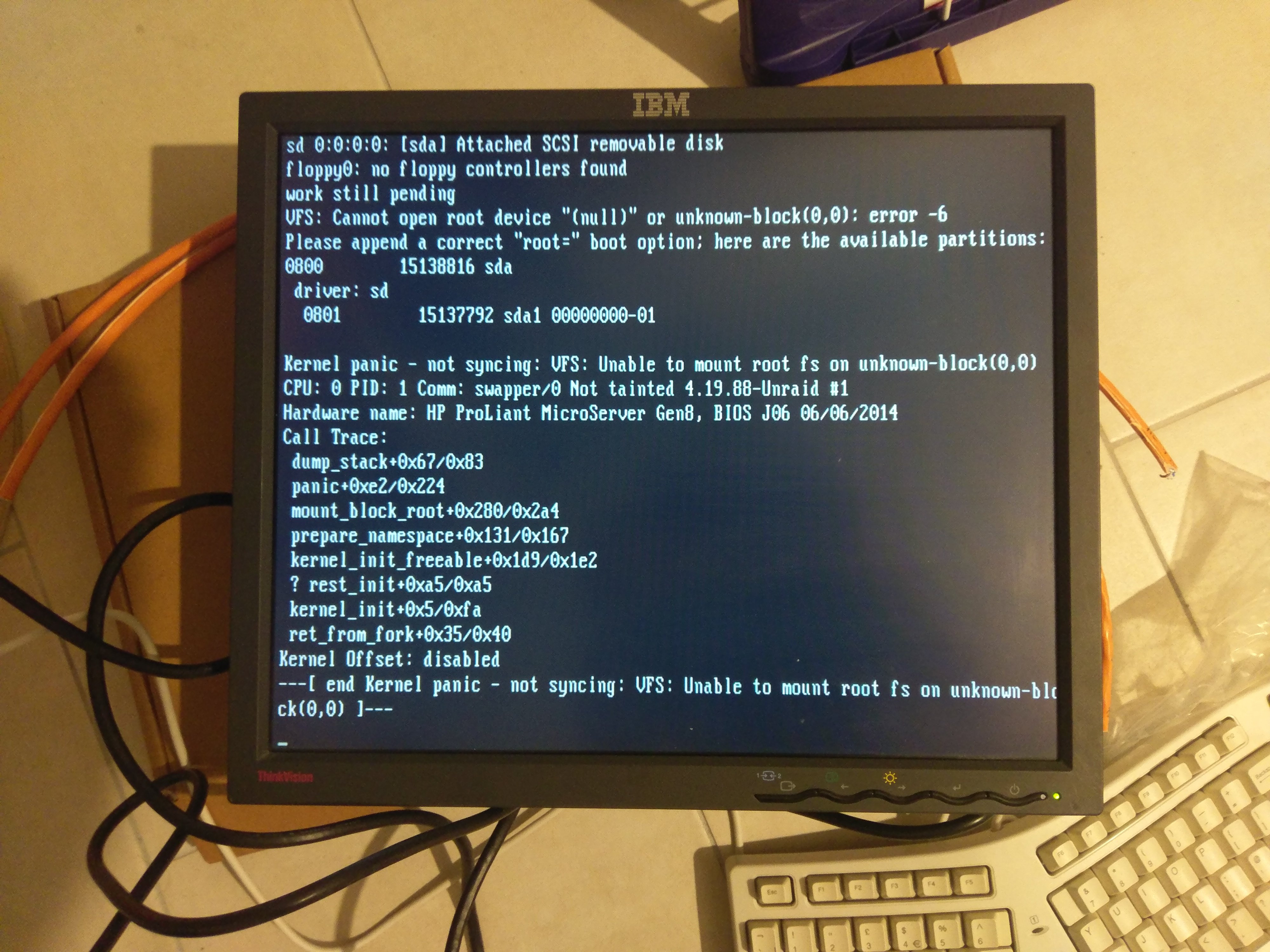

10 hours ago, johnieutah said:
This unfortunately lead to the next problem...
11 hours ago, johnnie.black said:
if it still doesn't boot try recreating the manual way.

22 hours ago, johnieutah said:
Here you go, live from the technik room...
Have recreated the flash drive and this issue still persists. How can this happen? How can I roll back? Never had any issues with Unraid updates till this one.
Worth trying this, if it still doesn't help you can roll back by copying the bz* files in the flash drive's previous folder overwriting existing ones.
Thanks. I tried the root=sda option, and no luck. I copied the contents of the backed-up "previous" folder and now it is back to normal.

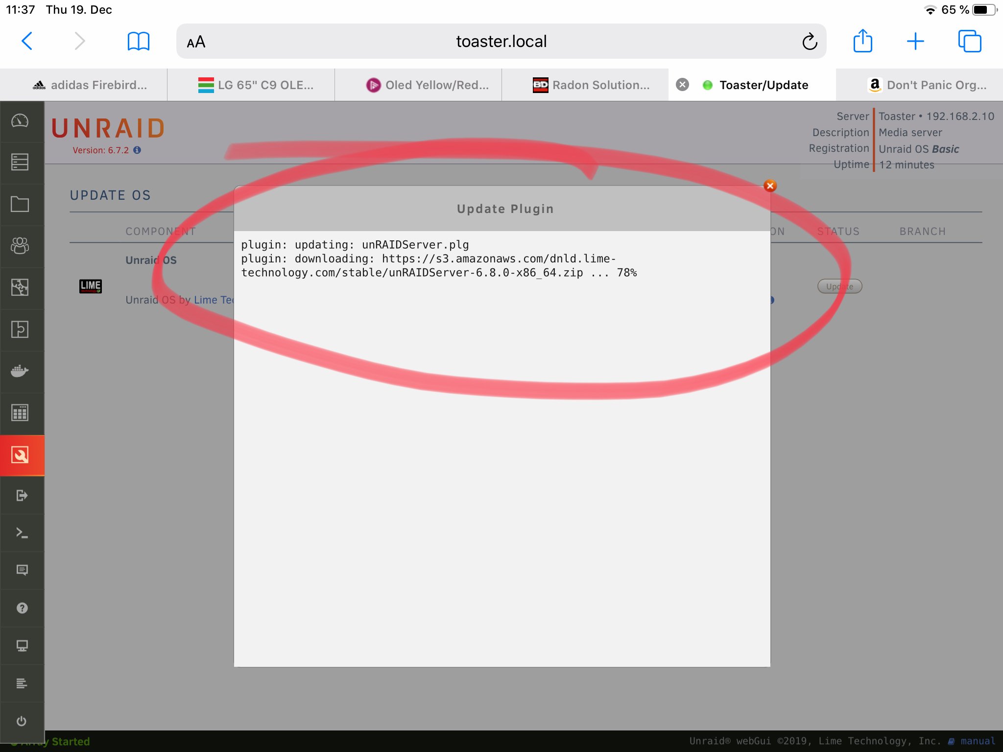

Trying to download again but it’s just hanging...
I have to say the whole update process isn’t very stable in my opinion. Now I’m in a situation where I have no idea if it’s actually doing something or not. Also I turn my server off after using it. Each time I have to check for new versions, I.e. it doesn’t persist when I’ve already checked, there is a new version but I’ve not downloaded it. Seems like an obvious thing to fix or check for updates quickly on boot?
Edited by johnieutah
