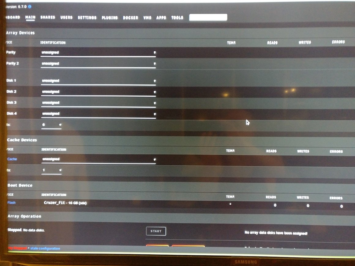

Ok, I booted into unraid-gui and it looks like all my array config is gone! This is insane. The box had been working fine, didn't do anything to it; came home one day and couldn't access it.
I'm attaching a picture of the screen I took with my cellphone.
How to salvage this?!?!?!?! Can I simply reassign the disks and hope everything will work? The problem is I don't remember which hdd is assigned to Disk 1, 2, 3, etc besides the obvious SSD used for Cache.

Just now, vurt said:
Even though the disks aren't assigned, this doesn't explain why I can't access the web gui? I've been searching the forums about missing array assignment and it looks like people are still able to access the web gui.
That photo you took in GUI mode is actually the webUI, but on the "localhost" it is able to access it with the "loopback" IP 127.0.0.1
That's cos I booted into unraid-gui at bootup as @TQ suggested. What started all this is because I can't access the gui at 192.168.1.252 nor tower.local.

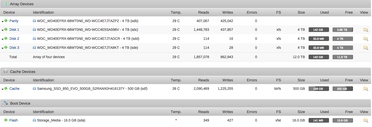

Great, so that solves that. I'm gonna start up the array and hope everything goes back to normal ...
Nope, started the array, got an email notification for "parity sync / data rebuild started" but I STILL CAN'T ACCESS the IP and tower.local.
With the array started, I can access all the Shares.
