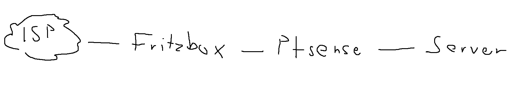

maybe it is a problem with my nestet nat (i know thats not realy good but i have no choice)
This is my network:

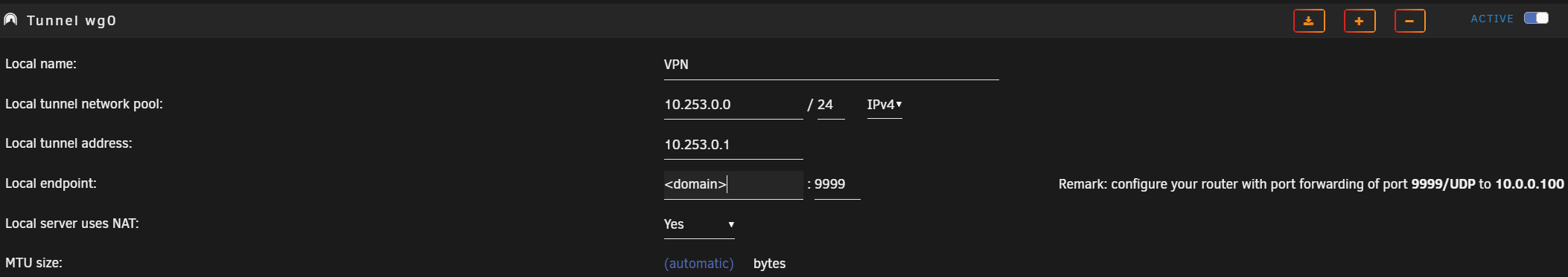

and  here my settings on unraid
my dyndns works because i can reach my docker container via letsencrypt docker container.

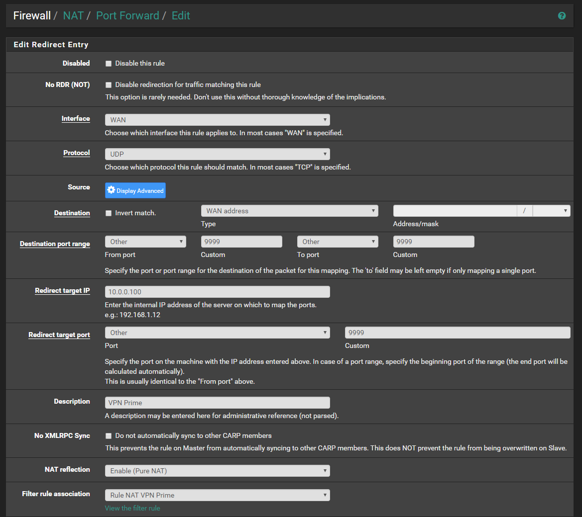

Here my PFsense conf:
First i tried the default port but thats the same thing.
Nmap from an outside server shows "filtered"

Since your Fritzbox is connected to the Internet, it needs to do port forwarding as well before it can reach the pfsense firewall.
my fritz box has "exposet host" active to the PFsense router

Your pfsense config looks alright to me. The only thing not applicable is NAT reflection. I would switch that off.
