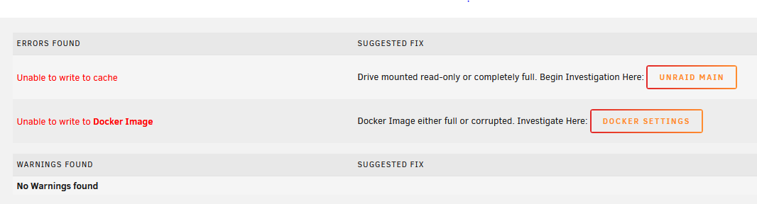

I have had this error three times  now so it must be something I'm doing wrong. When trying to manage my dockers, I am unable to delete them or make any changes to them. It just throws a system error. If I reboot my entire server everything works fine for a while but then if I starting installing or removing dockers I get the errors again.  I looked in the "fix common problems" plugin and it shows the following messages:

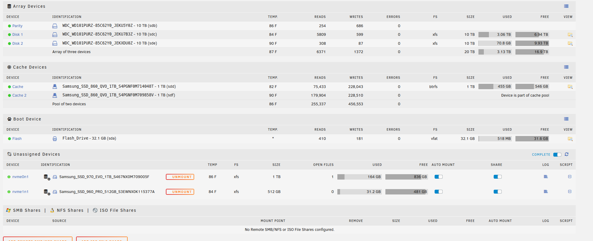

Here are my drives, they are not full or even close to full. Does anyone have any suggestions?

There's filesystem corruption on the cache pool, best way forward is to backup, re-format and restore data.
