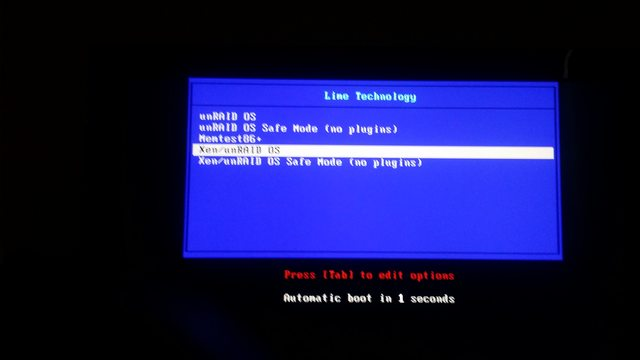

Okay is there a command to boot into safe mode, like i said the GUI is basically impossible to get up
2nd boot option:
It is an option on the boot menu.
if you do not have a keyboard+monitor plugged into your server, you can edit the syslinux/syslinux.cfg file on the flash drive and move the ‘default’ line to the Safe Mode section and then put it back into the server and it will boot into Safe Mode.
