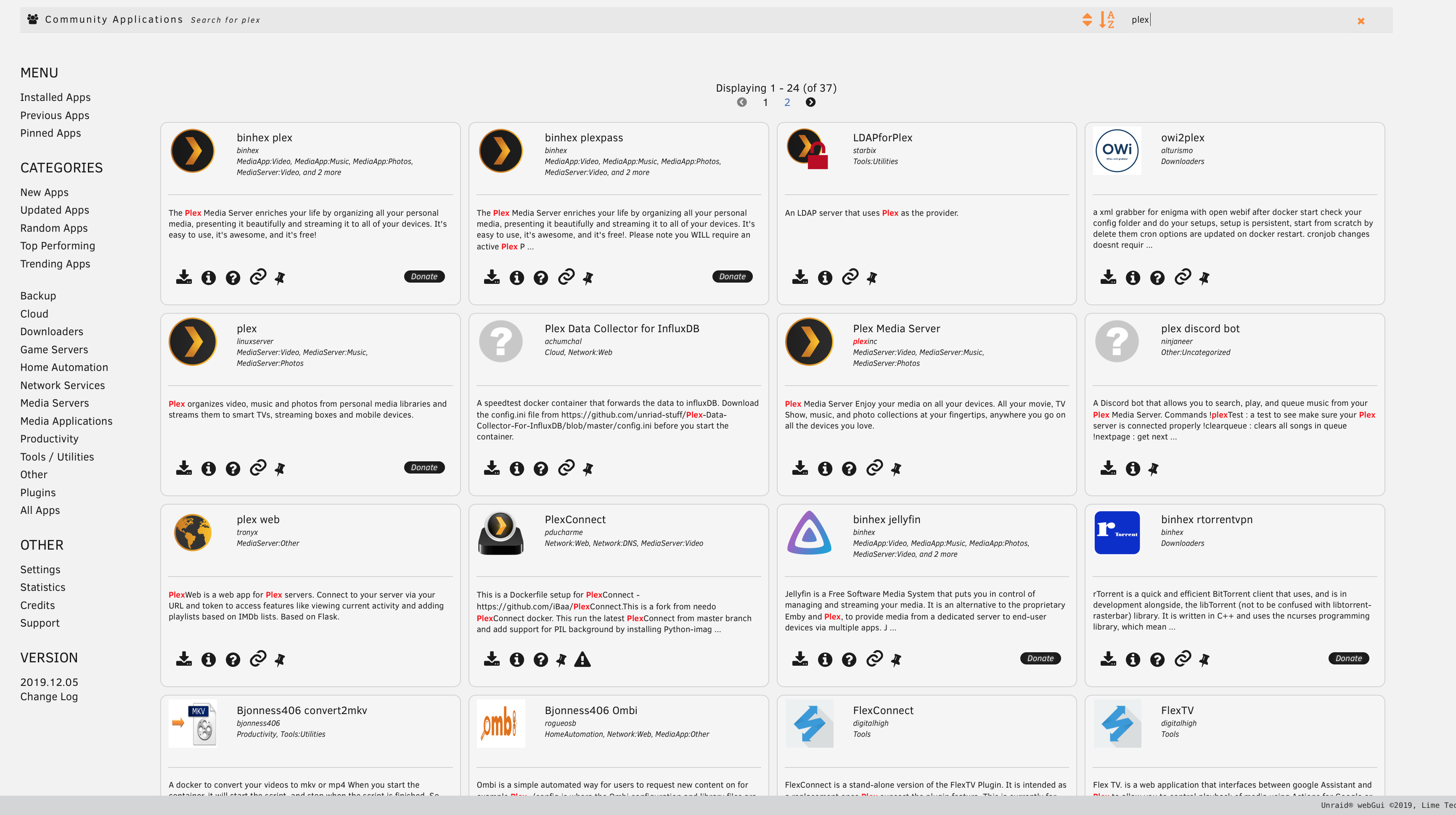

Thats it, I did not press the Plex icon, but the text. Now I got the menu and deleted Plex.
Now I lost track a bit. Shall I go to apps and download again (a new version?) I can see there are several to choose from...

Those all match "plex" in their descriptions, but they are not all plex. Some are things to be used with plex, and some are other things similar to plex.
I use linuxserver.io plex so that is the one I am most familiar with. If you have other linuxserver.io dockers then there is some benefit to staying with them. On the other hand if you have other binhex dockers then there is some benefit to staying with them.
If you don't have a preference just choose linuxserver.io plex. It is the first one on the second row of your screenshot.
Whichever you choose you need to edit some things on the Add Container page so post a screenshot when you get to that page.
