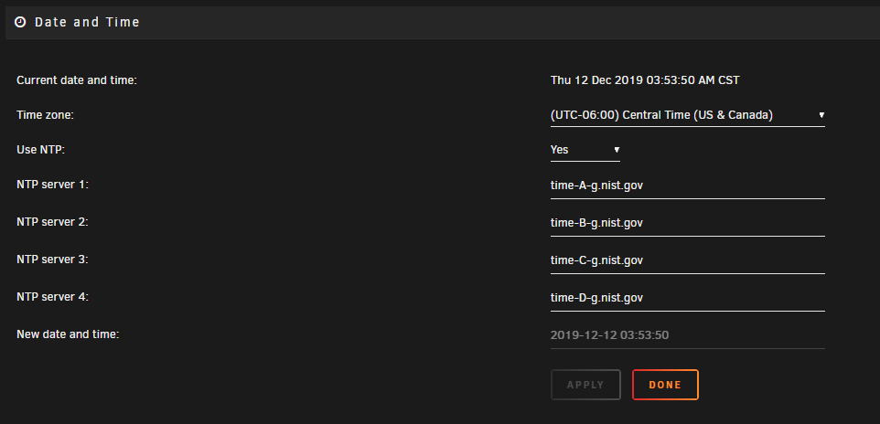

My clock in Unraid will not stay sync'd with the current time, I have tried setting it manually and using available NTP servers, nothing works.
I did have to replace the mainboard battery and the clock in the BIOS is current as of my last reboot.

   https://tf.nist.gov/tf-cgi/servers.cgi
You might want to read this noting this statement.
3. The generic name      time.nist.gov      will continue to point to all of our servers on a round-robin basis, and users are encouraged to access the service using this name.
Even after taking that into account and making the change, unraid clock still lost 2 hours overnight.
Will verify the BIOS clock again with a reboot and set the unraid clock 1 more time.
