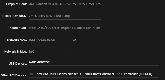

The PCI device that I Passthrough is:
Intel C610/X99 series chipset USB xHCI Host Controller | USB controller (00:14.0)

I do not have the option to passthrough only the Mouse for example because the USB devices are not at all visible under that section as you can see bellow.image.png.f4585121cfed6b0cc7be8b2618872610.png
That is why i pass-though the entire USB controller to the VM.
