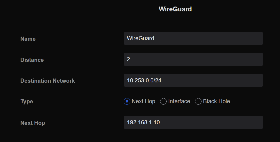

Thanks Hoopster!  The one other issue I have to sort it is how to change the Wireguard config to be able to access dockers with a Custom:br0 network type.  I have seen the docs on that, but I haven't got around to trying that yet.
It's not so much a change in the WireGuard configuration as it is the router configuration.  I have most of my docker containers on br0.3 (dedicated Docker VLAN) and I needed the static route (as explained in the Complex Networks section of the WireGuard Quickstart linked above) to be able to access the WebUIs of docker containers on br0.3 via WireGuard.
Here's what it looks like in my router config:
Edited by Hoopster

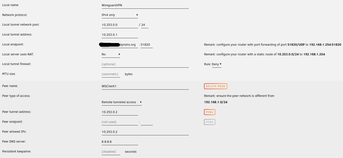

I am not successful in getting this working.  My unRAID server has an IP of 192.168.1.254.  My router is a Unifi USG.  Here is the static route that I created.
On my iPhone I am not able to address a docker on this server with a br0 network setting that has an IP of 192.168.1.245.  From my phone via VPN I can access other IPs that are on my LAN so the core VPN functionality is working.
Here is my Wireguard Config:
Any ideas on how to troubleshoot.
I think I may have found a potential issue - it appears that you have to change a docker setting - Host access to custom networks:.  Do I have to enable this?  It looks like right now I can't change this setting.  Is that because the dockers are running?  Do I have to shut down the dockers to change this setting?
I shut down the docker service.  Changed the setting to allow Host access to custom networks, but still it does not work.  Any advice on how to troubleshoot this?
edit - I eventually got everything working but I am not sure what did it.  I updated to unRAID 6.11.5 from an earlier version and I had to reboot a few times, and when I tried it I am able to access the br0 website from my phone while on the cell network and connected via VPN.
