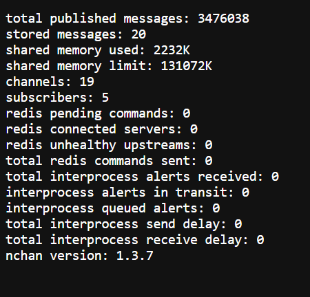

nginx running out of shared memory
total published messages: 2681425
stored messages: 0
shared memory used: 130308K
shared memory limit: 131072K
channels: 0
subscribers: 0
redis pending commands: 0
redis connected servers: 0
redis unhealthy upstreams: 0
total redis commands sent: 0
total interprocess alerts received: 0
interprocess alerts in transit: 0
interprocess queued alerts: 0
total interprocess send delay: 0
total interprocess receive delay: 0
nchan version: 1.3.7

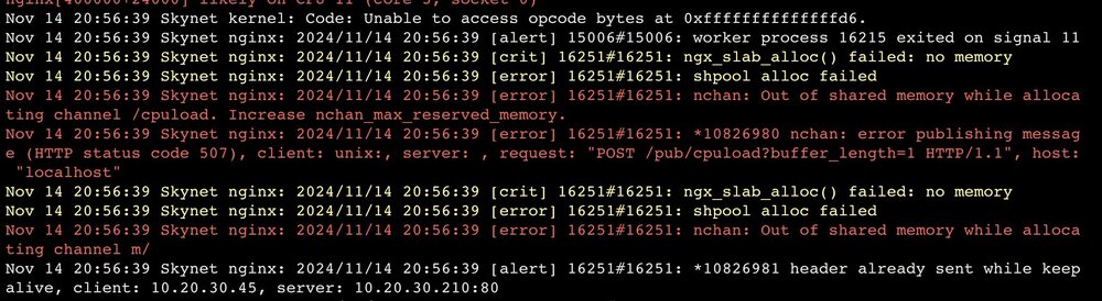

syslog:
Feb 17 23:21:18 server nginx: 2025/02/17 23:21:18 [crit] 3495097#3495097: ngx_slab_alloc() failed: no memory
Feb 17 23:21:18 server nginx: 2025/02/17 23:21:18 [error] 3495097#3495097: shpool alloc failed
Feb 17 23:21:18 server nginx: 2025/02/17 23:21:18 [error] 3495097#3495097: nchan: Out of shared memory while allocating channel /cpuload. Increase nchan_max_reserved_memory.
Feb 17 23:21:18 server nginx: 2025/02/17 23:21:18 [error] 3495097#3495097: *3131170 nchan: error publishing message (HTTP status code 507), client: unix:, server: , request: "POST /pub/cpuload?buffer_length=1 HTTP/1.1", host: "localhost"
Feb 17 23:21:18 server nginx: 2025/02/17 23:21:18 [error] 3495097#3495097: nchan: Out of shared memory while allocating channel /disks. Increase nchan_max_reserved_memory.
Feb 17 23:21:18 server nginx: 2025/02/17 23:21:18 [error] 3495097#3495097: *3131171 nchan: error publishing message (HTTP status code 507), client: unix:, server: , request: "POST /pub/disks?buffer_length=1 HTTP/1.1", host: "localhost"
Feb 17 23:21:18 server nginx: 2025/02/17 23:21:18 [error] 3495097#3495097: nchan: Out of shared memory while allocating channel /devs. Increase nchan_max_reserved_memory.
Feb 17 23:21:18 server nginx: 2025/02/17 23:21:18 [error] 3495097#3495097: *3131172 nchan: error publishing message (HTTP status code 507), client: unix:, server: , request: "POST /pub/devs?buffer_length=1 HTTP/1.1", host: "localhost"
Feb 17 23:21:19 server nginx: 2025/02/17 23:21:19 [crit] 3495097#3495097: ngx_slab_alloc() failed: no memory
Feb 17 23:21:19 server nginx: 2025/02/17 23:21:19 [error] 3495097#3495097: shpool alloc failed
Feb 17 23:21:19 server nginx: 2025/02/17 23:21:19 [error] 3495097#3495097: nchan: Out of shared memory while allocating channel /cpuload. Increase nchan_max_reserved_memory.
Feb 17 23:21:19 server nginx: 2025/02/17 23:21:19 [error] 3495097#3495097: *3131173 nchan: error publishing message (HTTP status code 507), client: unix:, server: , request: "POST /pub/cpuload?buffer_length=1 HTTP/1.1", host: "localhost"
Feb 17 23:21:19 server nginx: 2025/02/17 23:21:19 [error] 3495097#3495097: nchan: Out of shared memory while allocating channel /disks. Increase nchan_max_reserved_memory.
Feb 17 23:21:19 server nginx: 2025/02/17 23:21:19 [error] 3495097#3495097: *3131178 nchan: error publishing message (HTTP status code 507), client: unix:, server: , request: "POST /pub/disks?buffer_length=1 HTTP/1.1", host: "localhost"
Feb 17 23:21:20 server nginx: 2025/02/17 23:21:20 [crit] 3495097#3495097: ngx_slab_alloc() failed: no memory
Feb 17 23:21:20 server nginx: 2025/02/17 23:21:20 [error] 3495097#3495097: shpool alloc failed
Feb 17 23:21:20 server nginx: 2025/02/17 23:21:20 [error] 3495097#3495097: nchan: Out of shared memory while allocating channel /cpuload. Increase nchan_max_reserved_memory.
Feb 17 23:21:20 server nginx: 2025/02/17 23:21:20 [error] 3495097#3495097: *3131179 nchan: error publishing message (HTTP status code 507), client: unix:, server: , request: "POST /pub/cpuload?buffer_length=1 HTTP/1.1", host: "localhost"
Feb 17 23:21:20 server nginx: 2025/02/17 23:21:20 [error] 3495097#3495097: nchan: Out of shared memory while allocating channel /disks. Increase nchan_max_reserved_memory.
Feb 17 23:21:20 server nginx: 2025/02/17 23:21:20 [error] 3495097#3495097: *3131180 nchan: error publishing message (HTTP status code 507), client: unix:, server: , request: "POST /pub/disks?buffer_length=1 HTTP/1.1", host: "localhost"
Feb 17 23:21:21 server nginx: 2025/02/17 23:21:21 [crit] 3495097#3495097: ngx_slab_alloc() failed: no memory
Feb 17 23:21:21 server nginx: 2025/02/17 23:21:21 [error] 3495097#3495097: shpool alloc failed
Feb 17 23:21:21 server nginx: 2025/02/17 23:21:21 [error] 3495097#3495097: nchan: Out of shared memory while allocating channel /cpuload. Increase nchan_max_reserved_memory.
Feb 17 23:21:21 server nginx: 2025/02/17 23:21:21 [error] 3495097#3495097: *3131181 nchan: error publishing message (HTTP status code 507), client: unix:, server: , request: "POST /pub/cpuload?buffer_length=1 HTTP/1.1", host: "localhost"
Feb 17 23:21:21 server nginx: 2025/02/17 23:21:21 [error] 3495097#3495097: nchan: Out of shared memory while allocating channel /disks. Increase nchan_max_reserved_memory.
Feb 17 23:21:21 server nginx: 2025/02/17 23:21:21 [error] 3495097#3495097: *3131182 nchan: error publishing message (HTTP status code 507), client: unix:, server: , request: "POST /pub/disks?buffer_length=1 HTTP/1.1", host: "localhost"
Feb 17 23:21:22 server nginx: 2025/02/17 23:21:22 [crit] 3495097#3495097: ngx_slab_alloc() failed: no memory
Feb 17 23:21:22 server nginx: 2025/02/17 23:21:22 [error] 3495097#3495097: shpool alloc failed
Feb 17 23:21:22 server nginx: 2025/02/17 23:21:22 [error] 3495097#3495097: nchan: Out of shared memory while allocating channel /cpuload. Increase nchan_max_reserved_memory.
dmesg:
[Mon Feb 17 23:20:06 2025] Code: Unable to access opcode bytes at 0xffffffffffffffd6.
[Mon Feb 17 23:20:06 2025] nginx[3495093]: segfault at 0 ip 0000000000000000 sp 00007ffdb7dbe498 error 14 in nginx[400000+24000] likely on CPU 10 (core 2, socket 0)
[Mon Feb 17 23:21:06 2025] nginx[3495097]: segfault at 0 ip 0000000000000000 sp 00007ffdb7dbe498 error 14 in nginx[400000+24000] likely on CPU 1 (core 1, socket 0)
[Mon Feb 17 23:21:06 2025] Code: Unable to access opcode bytes at 0xffffffffffffffd6.
[Mon Feb 17 23:21:07 2025] nginx[3496422]: segfault at 0 ip 0000000000000000 sp 00007ffdb7dbe498 error 14 in nginx[400000+24000] likely on CPU 3 (core 3, socket 0)
[Mon Feb 17 23:21:07 2025] Code: Unable to access opcode bytes at 0xffffffffffffffd6.
[Mon Feb 17 23:22:07 2025] nginx[3496423]: segfault at 0 ip 0000000000000000 sp 00007ffdb7dbe498 error 14 in nginx[400000+24000] likely on CPU 1 (core 1, socket 0)
[Mon Feb 17 23:22:07 2025] Code: Unable to access opcode bytes at 0xffffffffffffffd6.
[Mon Feb 17 23:22:08 2025] nginx[3497690]: segfault at 0 ip 0000000000000000 sp 00007ffdb7dbe498 error 14 in nginx[400000+24000] likely on CPU 9 (core 1, socket 0)
[Mon Feb 17 23:22:08 2025] Code: Unable to access opcode bytes at 0xffffffffffffffd6.
[Mon Feb 17 23:23:07 2025] nginx[3497742]: segfault at 0 ip 0000000000000000 sp 00007ffdb7dbe498 error 14 in nginx[400000+24000] likely on CPU 11 (core 3, socket 0)
[Mon Feb 17 23:23:07 2025] Code: Unable to access opcode bytes at 0xffffffffffffffd6.
[Mon Feb 17 23:23:08 2025] nginx[3498986]: segfault at 0 ip 0000000000000000 sp 00007ffdb7dbe498 error 14 in nginx[400000+24000] likely on CPU 3 (core 3, socket 0)
[Mon Feb 17 23:23:08 2025] Code: Unable to access opcode bytes at 0xffffffffffffffd6.
[Mon Feb 17 23:24:07 2025] nginx[3499049]: segfault at 0 ip 0000000000000000 sp 00007ffdb7dbe498 error 14 in nginx[400000+24000] likely on CPU 9 (core 1, socket 0)
[Mon Feb 17 23:24:07 2025] Code: Unable to access opcode bytes at 0xffffffffffffffd6.
[Mon Feb 17 23:24:10 2025] nginx[3500248]: segfault at 0 ip 0000000000000000 sp 00007ffdb7dbe498 error 14 in nginx[400000+24000] likely on CPU 11 (core 3, socket 0)
[Mon Feb 17 23:24:10 2025] Code: Unable to access opcode bytes at 0xffffffffffffffd6.
[Mon Feb 17 23:25:20 2025] nginx[3500304]: segfault at 0 ip 0000000000000000 sp 00007ffdb7dbe498 error 14 in nginx[400000+24000] likely on CPU 8 (core 0, socket 0)
[Mon Feb 17 23:25:20 2025] Code: Unable to access opcode bytes at 0xffffffffffffffd6.
[Mon Feb 17 23:25:20 2025] nginx[3502195]: segfault at 0 ip 0000000000000000 sp 00007ffdb7dbe498 error 14 in nginx[400000+24000] likely on CPU 11 (core 3, socket 0)
[Mon Feb 17 23:25:22 2025] nginx[3502196]: segfault at 0 ip 0000000000000000 sp 00007ffdb7dbe498 error 14 in nginx[400000+24000] likely on CPU 10 (core 2, socket 0)
[Mon Feb 17 23:25:22 2025] Code: Unable to access opcode bytes at 0xffffffffffffffd6.
[Mon Feb 17 23:25:22 2025] nginx[3502201]: segfault at 0 ip 0000000000000000 sp 00007ffdb7dbe498 error 14 in nginx[400000+24000] likely on CPU 2 (core 2, socket 0)
