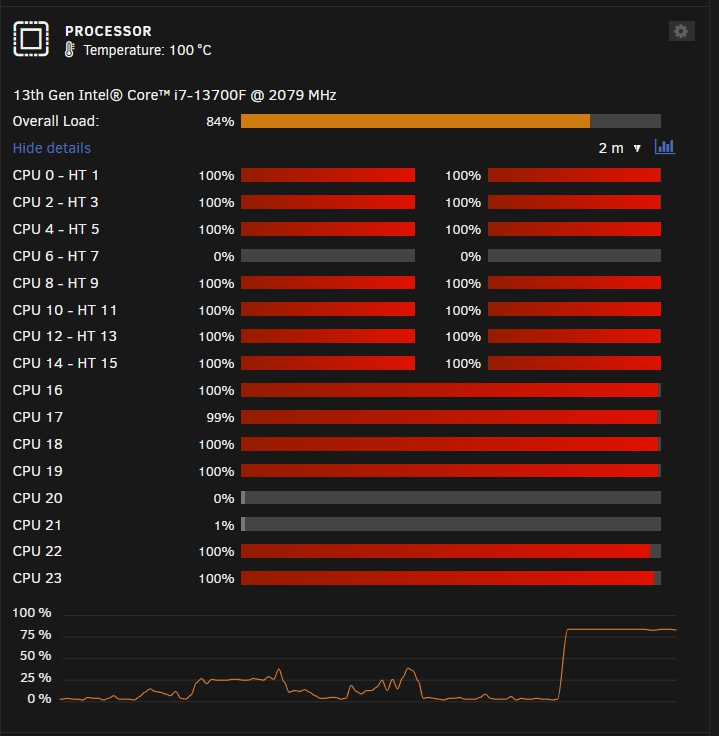

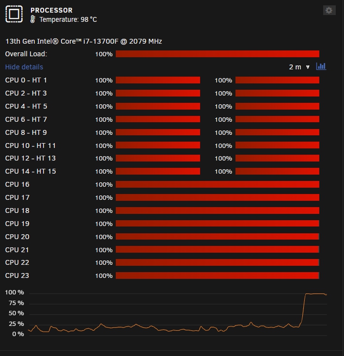

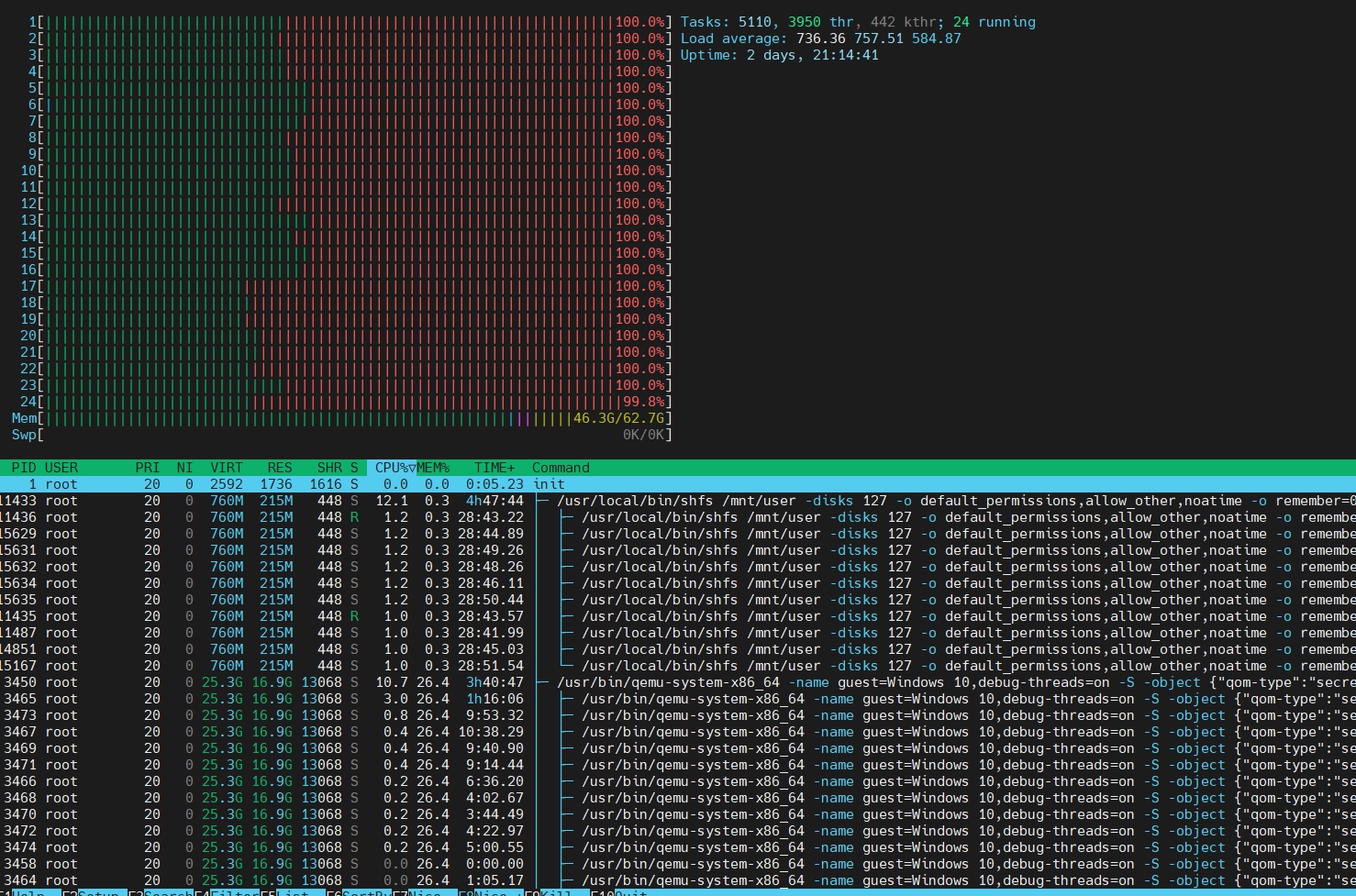

Last month I updated from 6.9.2 (after staying on it for ages) to 6.11.5 then updated to 6.12.0 then 6.12.1.
Since this time I have had ongoing issues with massive spikes in CPU usage. Usually 100% and it cannot recover. I have updated plugins, read 100 forum threads, changed settings within Tips & Tweaks (vm.dirty_background_ratio to 3, vm.dirty_ratio to 6, changed the CPU scaling governor to performance), changed my MB & CPU, changed SATA card, removed a HDD, pinned all dockers to various CPU cores, removed unraid access to a few cores, among various other things suggested in these forums... Still no fix.
Today I ran the "/etc/rc.d/rc.nginx restart" command. It stopped the CPU from spiking, then maxed out my RAM?! Then the server froze after that and I had to hard reboot.
Generally these spikes occur about once per day. Diagnostics attached.
Does anyone have any other ideas?

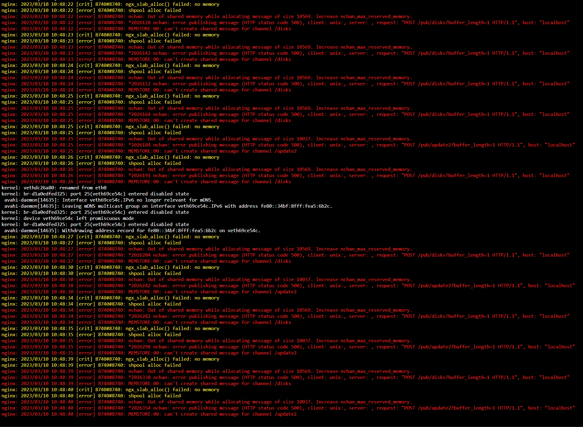

On 6.12.2 and similar error:
Jul 13 17:34:17 kasumi nginx: 2023/07/13 17:34:17 [crit] 35027#35027: ngx_slab_alloc() failed: no memory
Jul 13 17:34:17 kasumi nginx: 2023/07/13 17:34:17 [error] 35027#35027: shpool alloc failed
Jul 13 17:34:17 kasumi nginx: 2023/07/13 17:34:17 [error] 35027#35027: nchan: Out of shared memory while allocating message of size 233. Increase nchan_max_reserved_memory.
Jul 13 17:34:17 kasumi nginx: 2023/07/13 17:34:17 [error] 35027#35027: *5835100 nchan: error publishing message (HTTP status code 500), client: unix:, server: , request: "POST /pub/wireguard?buffer_length=1 HTTP/1.1", host: "localhost"
Jul 13 17:34:17 kasumi nginx: 2023/07/13 17:34:17 [error] 35027#35027: MEMSTORE:01: can't create shared message for channel /wireguard
Restarted nginx but no luck, will restart the OS next.
