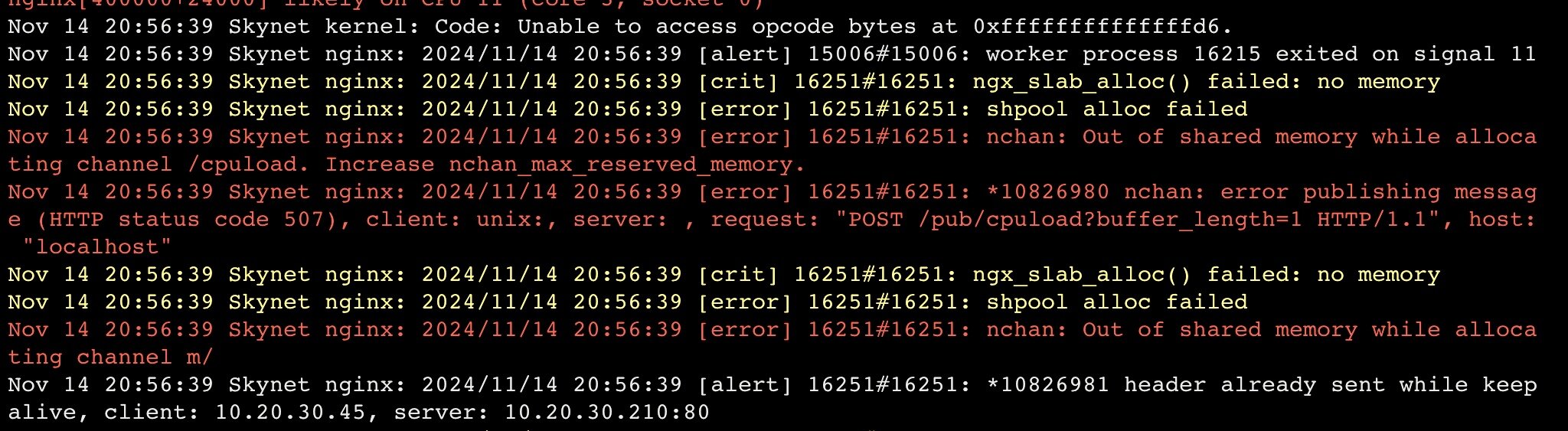

I'll add my hat to the ring of people who just had "nchan: Out of shared memory....." errors flood my log as well (V: 6.12.10).
As well:
- nchan: error publishing message (HTTP status code 507), client: unix:, server: , request: "POST /pub/cpuload?buffer_length=1 HTTP/1.1", host: "localhost"
- [alert] 47896#47896: *3521146 header already sent while keepalive, client: 10.253.1.4, server: 192.168.11.11:80
- kernel: nginx[47896]: segfault at 0 ip 0000000000000000 sp 00007ffc40c39498 error 14 in nginx[400000+24000] likely on CPU 2 (core 2, socket 0)
- kernel: Code: Unable to access opcode bytes at 0xffffffffffffffd6.
- nginx: 2024/08/14 14:59:29 [alert] 14946#14946: worker process 47896 exited on signal 11
- nginx: 2024/08/14 14:59:29 [crit] 47898#47898: ngx_slab_alloc() failed: no memory
- nginx: 2024/08/14 14:59:29 [error] 47898#47898: shpool alloc failed
- nginx: 2024/08/14 14:59:29 [error] 47898#47898: nchan: Out of shared memory while allocating channel /disks. Increase nchan_max_reserved_memory.
Cant open logs or terminal through the main gui (opens and closes right away).  It says im out of memory, but this system has 384GB of ECC ram!

The logs showed mostly the same 4-6 messages:
  • ngx_slab_alloc() failed: no memory
  • shpool alloc failed
  • nchan: Out of shared memory while allocating channel /temperature. Increase nchan_max_reserved_memory.
  •  *1798536 nchan: error publishing message (HTTP status code 507), client: unix:, server: , request: "POST /pub/cpuload?buffer_length=1 HTTP/1.1", host: "localhost"
  • kernel: nginx[25247]: segfault at 0 ip 0000000000000000 sp 00007ffc32198c58 error 14 in nginx[400000+24000] likely on CPU 8 (core 4, socket 0)
  • kernel: Code: Unable to access opcode bytes at 0xffffffffffffffd6.
Both times, a full restart resolved the GUI issues, and the repeated errors in the log.

I cannot believe we are still on this issue after 3 years. Has no one on the team resolved this yet? I have had the same problem for the last 2 years and resetting the process is only a temporary fix. It's a bandaid on a bullet wound philosophy here. Also increasing the memory size is not a solution since it will just outgrow the new limit.
"nchan: Out of shared memory while allocating channel /cpuload. Increase nchan_max_reserved_memory.
Sep 12 04:40:10 Servo nginx: 2024/09/12 04:40:10 [error] 2372#2372: *1895414 nchan: error publishing message (HTTP status code 507), client: unix:, server: , request: "POST /pub/cpuload?buffer_length=1 HTTP/1.1", host: "localhost"

Oct  8 11:15:29 Tower nginx: 2024/10/08 11:15:29 [error] 4745#4745: shpool alloc failed
Oct  8 11:15:29 Tower nginx: 2024/10/08 11:15:29 [error] 4745#4745: nchan: Out of shared memory while allocating message of size 14863. Increase nchan_max_reserved_memory.
Oct  8 11:15:29 Tower nginx: 2024/10/08 11:15:29 [error] 4745#4745: *9450208 nchan: error publishing message (HTTP status code 500), client: unix:, server: , request: "POST /pub/disks?buffer_length=1 HTTP/1.1", host: "localhost"
Oct  8 11:15:29 Tower nginx: 2024/10/08 11:15:29 [error] 4745#4745: MEMSTORE:01: can't create shared message for channel /disks
Oct  8 11:15:30 Tower nginx: 2024/10/08 11:15:30 [crit] 4745#4745: ngx_slab_alloc() failed: no memory

Oct 17 13:40:23 UnRAID nginx: 2024/10/17 13:40:23 [error] 30528#30528: nchan: Out of shared memory while allocating channel /temperature. Increase nchan_max_reserved_memory.
Oct 17 13:40:23 UnRAID nginx: 2024/10/17 13:40:23 [error] 30528#30528: *9842069 nchan: error publishing message (HTTP status code 507), client: unix:, server: , request: "POST /pub/temperature?buffer_length=1 HTTP/1.1", host: "localhost"
Oct 17 13:40:23 UnRAID nginx: 2024/10/17 13:40:23 [crit] 30528#30528: ngx_slab_alloc() failed: no memory
Oct 17 13:40:23 UnRAID nginx: 2024/10/17 13:40:23 [error] 30528#30528: shpool alloc failed
Oct 17 13:40:23 UnRAID nginx: 2024/10/17 13:40:23 [error] 30528#30528: nchan: Out of shared memory while allocating channel /cpuload. Increase nchan_max_reserved_memory.
Oct 17 13:40:23 UnRAID nginx: 2024/10/17 13:40:23 [error] 30528#30528: *9842082 nchan: error publishing message (HTTP status code 507), client: unix:, server: , request: "POST /pub/cpuload?buffer_length=1 HTTP/1.1", host: "localhost"
Oct 17 13:40:24 UnRAID nginx: 2024/10/17 13:40:24 [crit] 30528#30528: ngx_slab_alloc() failed: no memory
Oct 17 13:40:24 UnRAID nginx: 2024/10/17 13:40:24 [error] 30528#30528: shpool alloc failed
Oct 17 13:40:24 UnRAID nginx: 2024/10/17 13:40:24 [error] 30528#30528: nchan: Out of shared memory while allocating channel /cpuload. Increase nchan_max_reserved_memory.
Oct 17 13:40:24 UnRAID nginx: 2024/10/17 13:40:24 [error] 30528#30528: *9842086 nchan: error publishing message (HTTP status code 507), client: unix:, server: , request: "POST /pub/cpuload?buffer_length=1 HTTP/1.1", host: "localhost"
Oct 17 13:40:24 UnRAID nginx: 2024/10/17 13:40:24 [error] 30528#30528: nchan: Out of shared memory while allocating channel /temperature. Increase nchan_max_reserved_memory.

Not addressed in 7.0.0-beta.2. Just happened to me, same nchan OOM errors.
Someone tell the dev team to leave a tab open for a week :)
It just happened to me in 7.0.0-beta4. Exact same behavior and error log.
Gave me quite an adrenalin rush to see the array entirely unpopulated in the broken web-gui.
