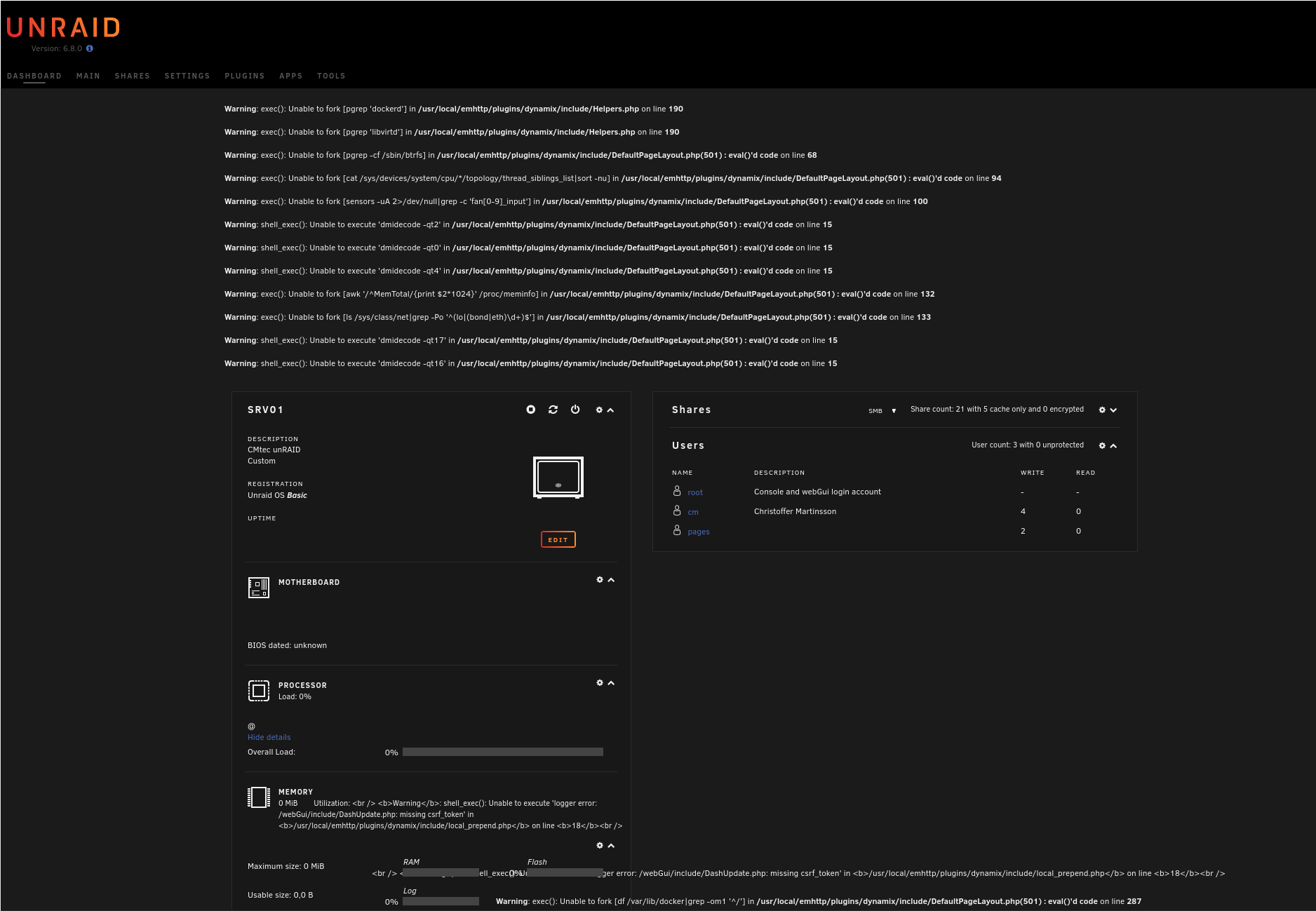

Gets gradually more and more unresponsive. Please see attached picture.
After approx one our the server is not responding at all.
Intel based platform.

Something is eating your memory, causing resource issues.
Most common reason is a misconfigured docker container, which results in storing everything in memory rather than disk.
And the fact you have allocated 40G to docker image also makes me suspect you have misconfigured docker applications. I usually recommend 20G. Have you had problems with docker image filling? Making it larger will not fix it, it will just make it take longer to fill.
There are 2 different ways you can get problems with misconfigured dockers:
  1. If you have an application that writes to any path that isn't mapped, it will be writing into the docker image, filling it up. Common mistakes are not using the same upper/lower case as in the mappings, or not using an absolute path (beginning with /).
  2. If you have a host path that is not actual storage, that path is in RAM. This includes any path to an Unassigned Device that isn't actually mounted.

Yes I increased the docker image to troubleshooting "image filling" in the past and I'm just lazy not recreating a smaller image :)
It seems to be my unifi-video container thats gets out of hand. Just trying to understand what changed in the docker engine between 18.09.2 and 19.03.5 that I need adapt to.
Thanks for the support!  I guess we can consider this issue closed for now as it is a docker issue and not an unraid issue.
