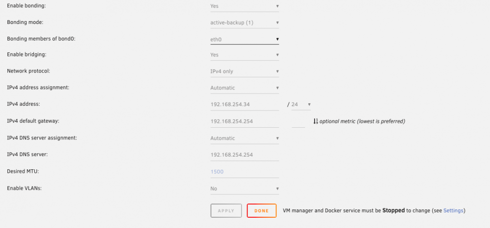

i dont think i fixed it these are my settings...
