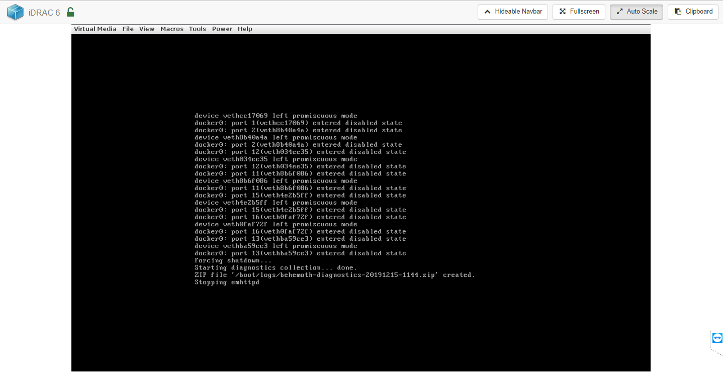

When the server hangs, i can still access the command line using my iDrac on my R710, but when I issue a powerdown -r, the server starts it reboot cycle, but hangs at 'waiting 120 seconds to gracefully shut down'. Then it's starts to collect diagnostic files, but it won't get any further than that. A warm power cycle is the only option to recover.

So after starting the reboot for the rollback, the server hangs again. Again a warm reboot is necessary get any response.
Reboot issued at 12/15/2019 11:42:29
