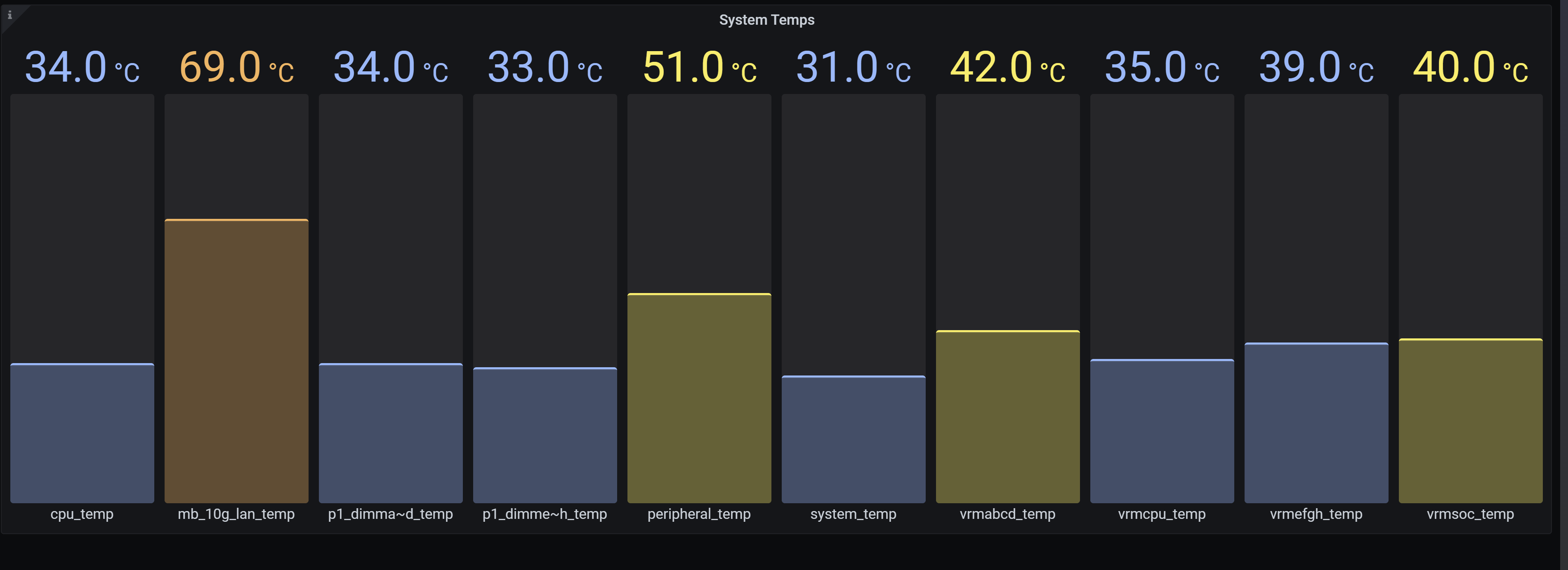

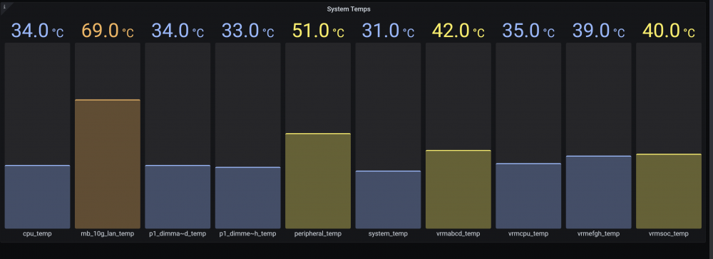

I just built an AMD Epyc, Supermicro H12-SSL Server.  I use the excellent Ultimate UNRAID Dashboard - Version 1.5 which shows my 10gb nic running ~68 Celsius all the time.  I don't push it hard (yet) so i'd image it will get warmer.

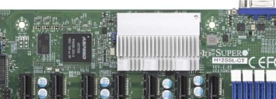

(I think) It has a heat sink on it (under the PCI-E cards) from Supermicro - https://www.supermicro.com/en/products/motherboard/H12SSL-ct.  So short of rigging up some sort of additional airflow (It's in a used CSE-846, i'm guessing it's "normal".
Welcome thoughts/feedback/suggestions!
Edited by KRK
Keep in mind many (most?) server grade boards assume a high level of airflow that rack mount cases provide. Desktop cases are mostly designed around noise levels, so you very well may want to arrange some ducting or add a circulation fan so the factory heatsinks get a constant airflow.
