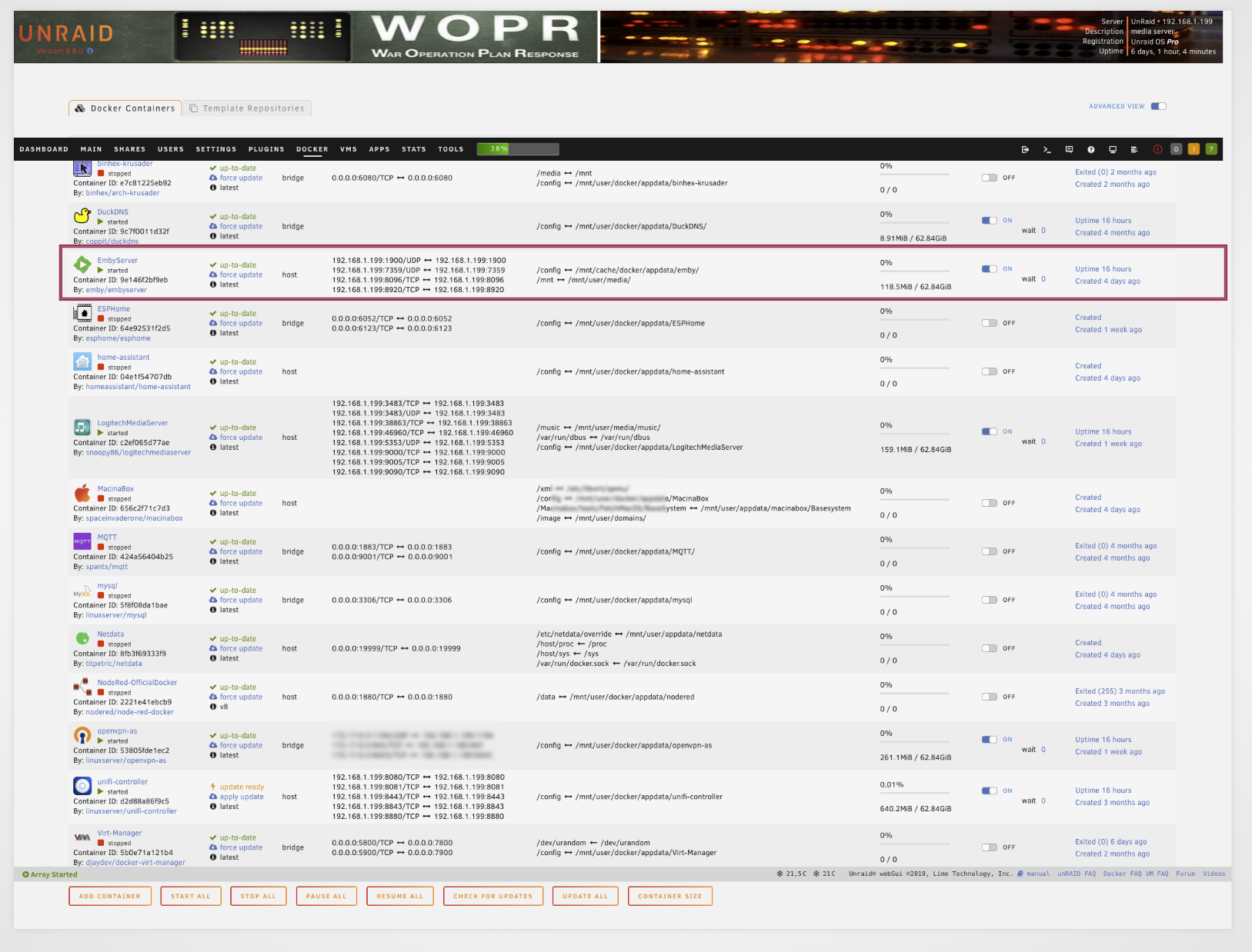

I run Emby server and can have up to 2x simultaneous clients accessing anything up to UHD video. As it happens, I use the Emby plug-in for Kodi as my front end.
The Emby Server runs in a Docker for me on a Threadripper 2950X system with 64GB RAM. The system handles handles 2x OSX VMs @ 16GB each, a couple of 8GB headless Win10 VMs and a bunch of other dockers. All of these run and can be in various  states of use when Emby is accessed, so at worst, it's got to live in 16GB which it shares with the OS and other Dockers.
The EmbyServer docker  sits at ˜100MB memory when idle. I haven't measured its activity when accessed by clients but I will and report back for you.
OK?
1419754859_Screenshot2019-12-21at16_58_53.thumb.png.37901c8c756f4b92b3b5216f3386d755.png

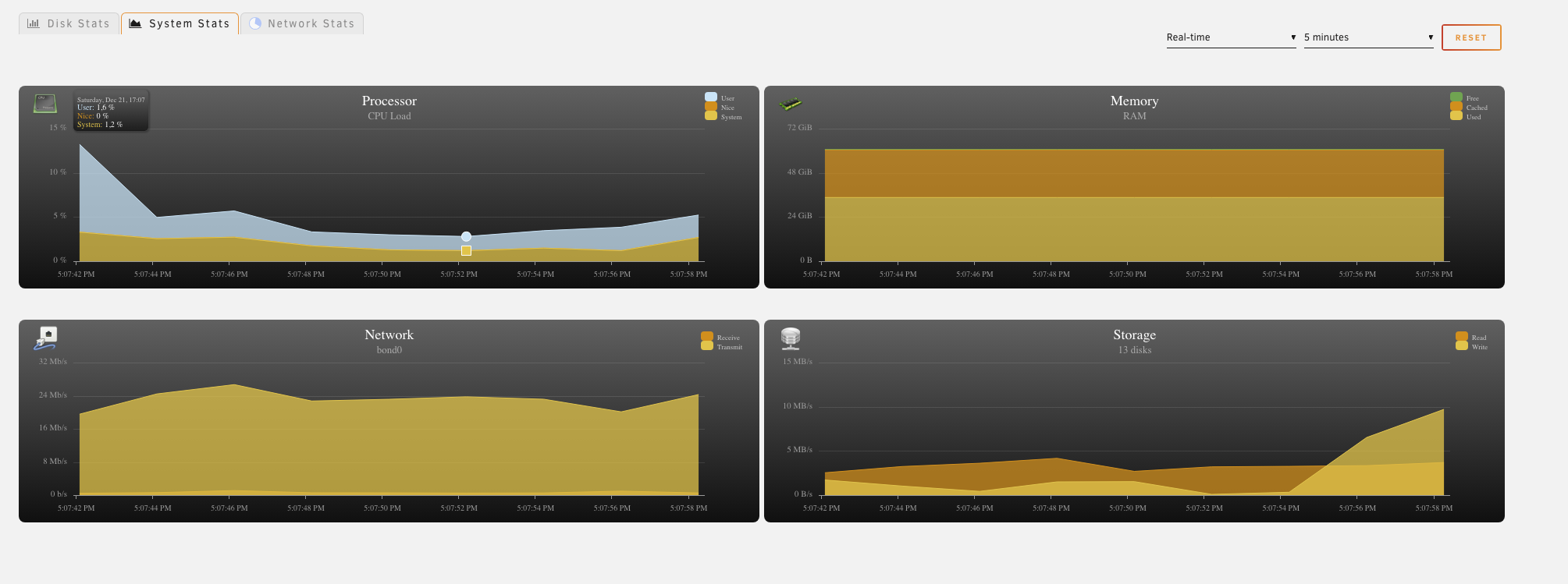

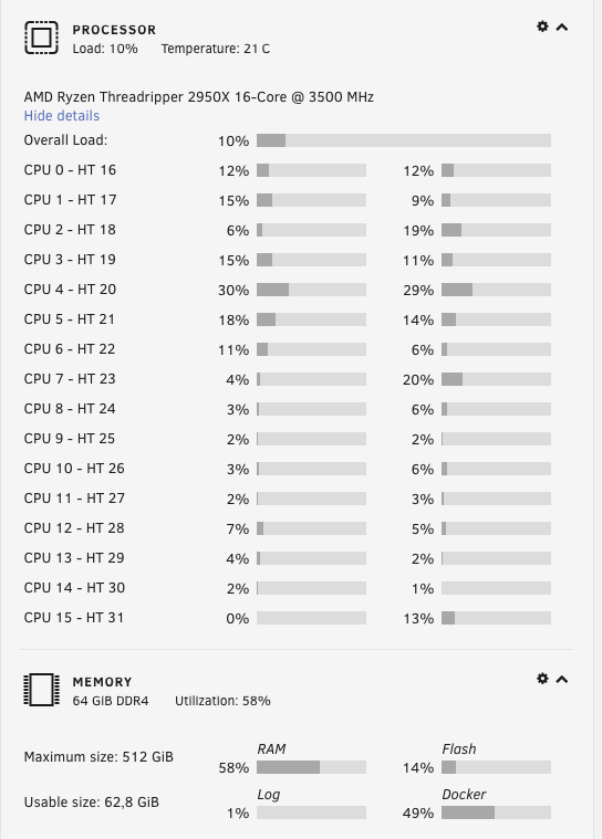

So, here's a few grabs of various metrics when I'm simultaneous streaming one 1080P movie and another 4K movie to different clients
122937035_Screenshot2019-12-21at17_05_20.thumb.png.2a26f8e4e931b560a503456df2752ecf.png
346927774_Screenshot2019-12-21at17_08_01.thumb.png.e8b05f73c0c4318b7dbc00f46840bafd.png
1207048787_Screenshot2019-12-21at17_06_01.thumb.png.7b01f40616ae60123831cf3f54c3af0f.png
Thats with the load described above running as well.
One caveat, it's entirely possible my clients are set to direct stream rather than transcode.
Hope that helps. If you need any further information, testing or opinion, please don't hesitate to ask, I'll try my best to respond, time permitting., or someone else might chip in.
