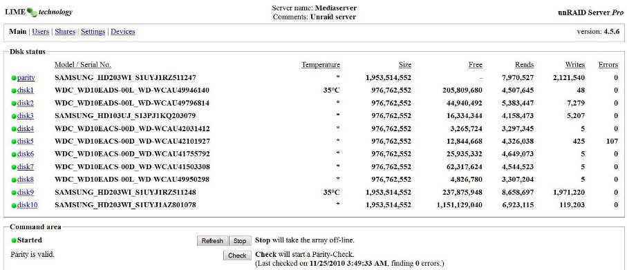

Hi guys.
Me and two other guys are running very similar setups and are all encountering the same issue.
Pro version with 10+ drives.
we have had this problem for a few months now and have serched the best we could for a solution to no avail.
We have no issues copying from the server, only to the server.
We have swapped routers,switches,network cables,sata leads and the like, we have failures with both teracopy and windows copy.
We are all running windows 7, different flavours from home premium to ultimate, OS's are legit.
When we try to copy to the server be it via the share or straight to the dis.
using terracopy the copy window will come up, then freeze, one of a few things will then happen:
The copy will stay frozen from anyware from 2-5 mins and then fail.
This may or may not write a 0kb file to the server.
The copy will stay frozen and then start copying when it gets to 100 it will fail.
This will write a properly sized file to the server but will be unplayable.
Repeating the copy will give a combination of these events and will eventually succeed.
Most of the time if a copy starts successfully, and we try to then browse the server, the copy will freeze and most likely fail.
While the copy is frozen the green bar in windows slowly tracks from left to right while this is occurring the server cannot be browsed and when it finishes the copy will either start or fail.
Error messages from terracopy are one of two.
"The file exists".
or
The network location has been lost (need to clarrify the exact wording on this one)
One note.
most of our drives are full with less than 5gig of space available.
We are using the most free setting in the share options.
One of the guys said he trasfered some data from disk to disk to free up some space on each disk and gave himself 50gig free on every disk and has not had a failure since.
Is there a mimimum amount of free space required on each disk, is this a bug or simply a coincidence?

It is not only that but the OP has a problems with one of the his HDs (identified as sdc, ata6 or md5). It may be benign and result of the "swapped routers,switches,network cables,sata leads and the like" that they did trying to pinpoint the problem or it may be falling.

I did see that post throughout my searches, but as our share allocation is set to "most free" files copied should be being dumped onto a near empty 2TB drive so one would think this would not be as issue.
