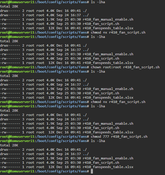

So, my fan scripts stopped working completely after update and I cannot figure out why I cannot get them back.
root@Romuserveri1:/boot/config/scripts/fans# ls -lha
total 28K
drwx------ 2 root root 4.0K Dec 16 09:41 ./
drwx------ 3 root root 4.0K Sep 24 16:37 ../
-rw------- 1 root root 1.9K Sep 25 03:30 r410_fan_manual_enable.sh
-rw------- 1 root root 4.0K Sep 25 03:30 r410_fan_script.sh
-rw------- 1 root root  12K Dec 16 09:41 r410_fanspeeds_table.xlsx
root@Romuserveri1:/boot/config/scripts/fans# chmod +x r410_fan_script.sh
total 28K
root@Romuserveri1:/boot/config/scripts/fans# chown root:root r410_fan_script.sh
total 28K
total 28K
root@Romuserveri1:/boot/config/scripts/fans# chmod 777 r410_fan_script.sh
total 28K
Ideas?
There were security changes to flash drive, it's on the release notes, you can execute your scripts with:
bash /boot/script_name
Thanks, had to just add "bash" to front of my script on crontab and again good to go.
