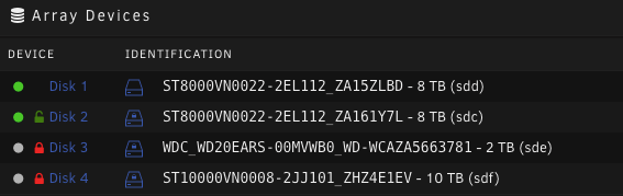

Disk 1 is XFS untouched and full
Disk 2 is now BTRFS encrypted and empty
Disk 3 is now BTRFS encrypted and "device locked: wrong encryption key"
Disk 4 is now BTRFS encrypted and "device locked: wrong encryption key"

This is how it looks like now:
I did what you recommended but it didn't worked. After that, I reformat Disk2 to match Disk3 and 4 with BTRFS encrypted and I manually selected the partition type BTRFS encrypted once the array was stopped. One things changed, both disk3 and 4 before restarting the array had an orange lock saying it will be encrypted. But result is still the same after restarting the array.

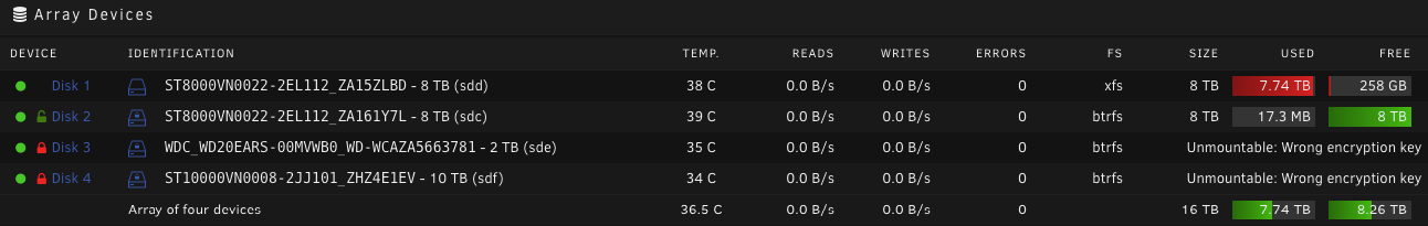

Now after changing the filesystem to encrypted I see wrong key error:
Dec 16 17:19:12 Cerebro emhttpd: shcmd (1436): mkdir -p /mnt/disk3
Dec 16 17:19:12 Cerebro emhttpd: /mnt/disk3 mount error: Wrong encryption key
Dec 16 17:19:12 Cerebro emhttpd: shcmd (1437): umount /mnt/disk3
Dec 16 17:19:12 Cerebro root: umount: /mnt/disk3: not mounted.
Which would suggest the key really is wrong, I guess that could happen if after a new config you entered a new key that is the same used in disk2 but note the one used in disks 3 and 4, but since I don't use encryption and not really familiar with how it works I'll leave it to see if someone else has any ideas.
