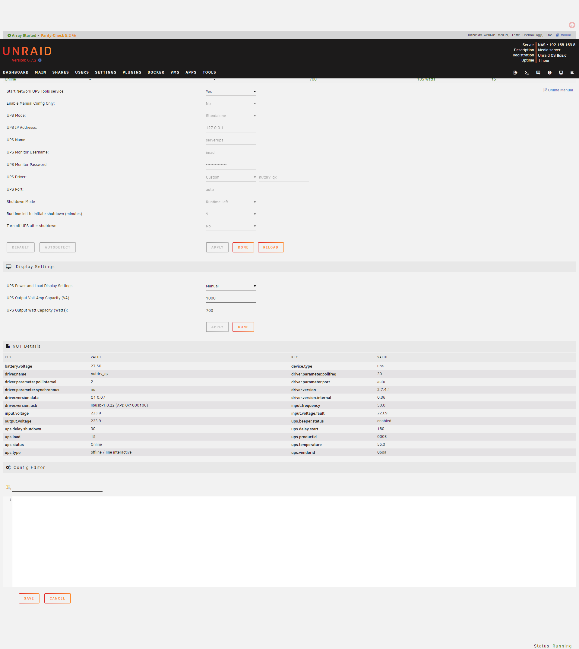

Kinda solved it, I just installed a new UPS with NUT, however I don't see the battery level being reported, can you people please help me diagnose what could be the problem?
How would I tell the server to shut down itself when its running on UPS without battery level?

Is this the same UPS model you mentioned in the OP?

Oh okay. Yes it is the same UPS. There's also an opton called "time on battery", it's basically a timer for how long the server has been without power.
