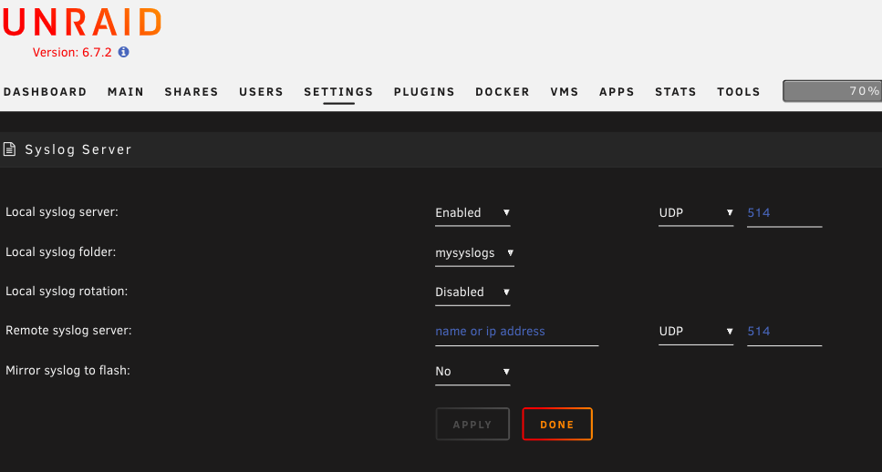

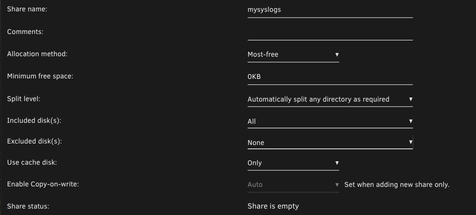

I'm trying to track down a random reboot issue I'm having.  I need to a syslog  from a time before a reboot.  I went to settings, turned on local Syslog Server, but no files show up in the share folder I selected.  It appears the GUI modified the .conf files with the share information.  Is there a step I'm missing?
Edited by krh1009
The local syslog server is for other computers on your network to send their logs to.  What you're looking to enable is mirror syslog to flash
Ohhhhhhh....I totally misunderstood that function.   Thank you.
