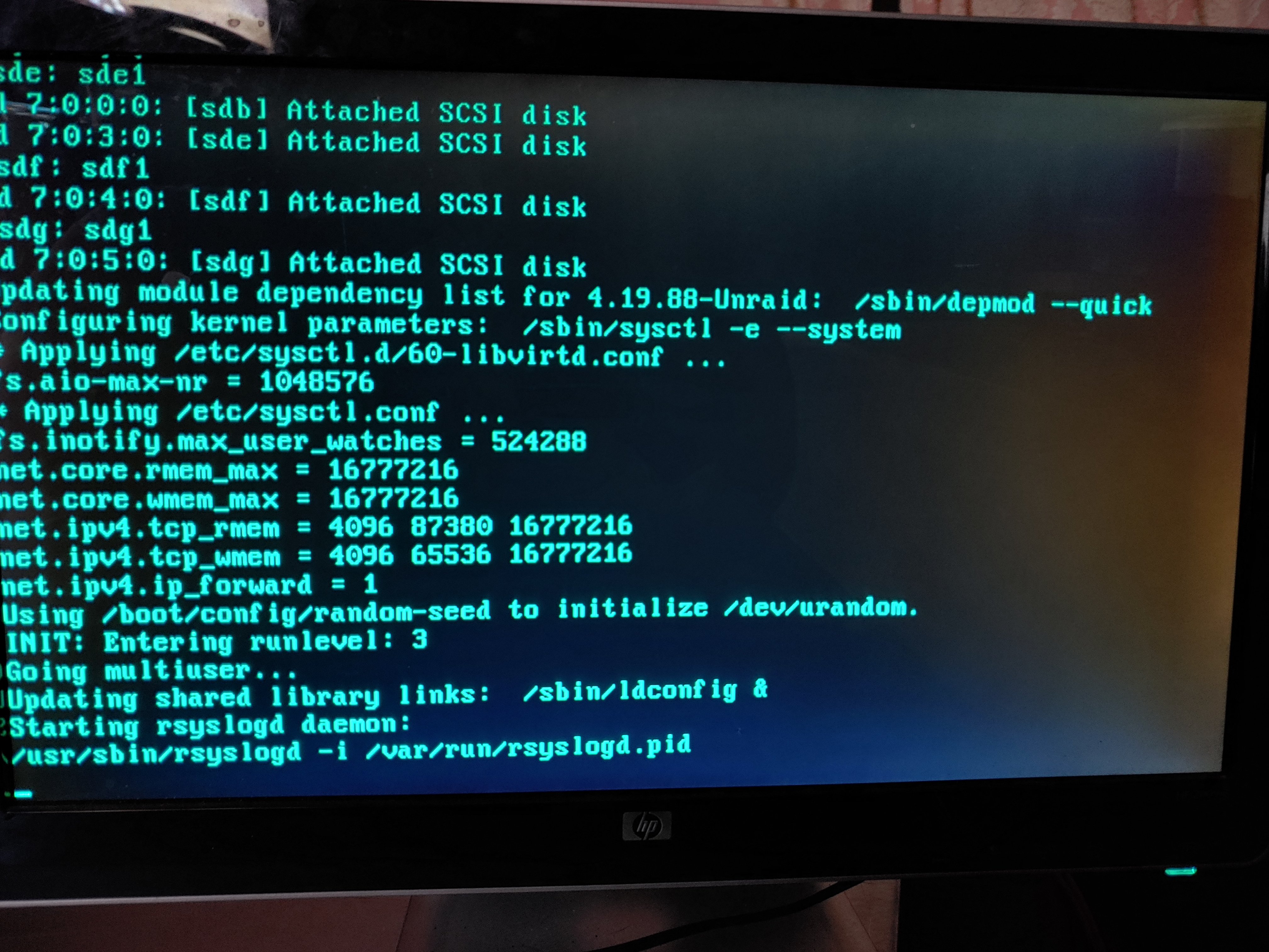

I recently purchased a HP DL380e gen8 with 14 LFF drive bays. I am having a really strange issue that I cannot seem to track down.
Unraid will not boot more than once. The first boot goes fine and all of my drives show up, but if I reboot after that it hangs at "starting rsyslog daemon". See attached screenshot for what the console looks like.
When I tried moving over my USB stick from my old server I had the same problem.
Things I have tried:
Two flash drives, one of which is basically brand new and the other worked fine in my other server.
Disconnect all storage devices
New flash drive with old config folder(from different server)
New flash drive with untouched config folder
Removed PCI-E HBA(server has onboard HP B120i that I haven't tried disabling and has no attached storage devices)
Safe mode with old config folder(from different server)
Safe mode with untouched config folder
At this point I don't know what else to try. If anyone has any suggestions I'd be happy to try them out.

Initially I wanted to transfer my array from an existing installation in a Dell R710 which only had 6 LFF drive bays to the new server. When I gracefully shut down the old server and moved everything over I had the result in the screenshot and the server wouldn't complete booting. I then tried creating a new flash drive with the official unraid USB tool and copying the config folder from my existing USB and it resulted in the same experience. When that didn't work I tried a different USB drive with the same result.
Essentially the sequence of events is this:
Existing installation -> Boot on new server fails
New Installation -> Successful boot -> next boot always fails
I have not tried a chkdisk on a USB that fails to boot. I have also not tried to boot the USB stick on a different server after it fails on the HP. I will try these things when I get home today.
Thank you all for your suggestions so far
Okay I have tried a few of the suggestions.
I tried other USB ports, none allow a proper boot.
I swapped in 2 4GB sticks of ram from another server, same issue.
The USB stick that will not boot on the HP DL380e gen8 does complete booting on my old Dell r710 so the problem does seem to be something in the HP system
I have ran chkdsk and chkdsk /f on the USB drive and Windows reported no errors.
I reset the server BIOS to defaults.
I am going to try to find which files specifically are changed during the first boot to see if I can narrow down the issue.
Edited by soja
It appears that when the file config/network-rules.cfg exists it causes the boot to hang. Anyone have any idea why that would be and how I could fix it?
network-rules.cfg
Edited by soja

Ok I *think* I have found the issue. When I disable the "Intel SATA controller" in bios(it is listed as a PCI-E device but it is onboard) unraid appears to work normally. Not sure why this Intel device causes unraids boot to hang, I'd be happy to get some more information if you can tell me what to look at.
