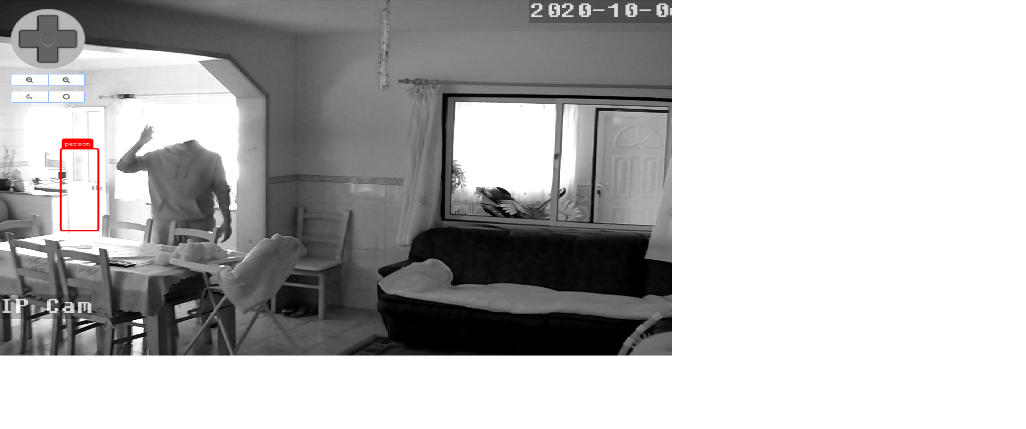

i have sucessfully mount one cam with ptz with onvif, the controls works and the cam folow person's, the problems:
my docker shinobi is using 40% cpu power :S i dont know why. i only have two cam's using yolo with gpu.
the feed of the cam have delay and the signal to move have a delay too, so the cam is always losing people, i think this problem is the cam and not shinobi.
there was been some updates to the docker shinobi gpu? because i install the gpu version and i dont see updates for very long time.

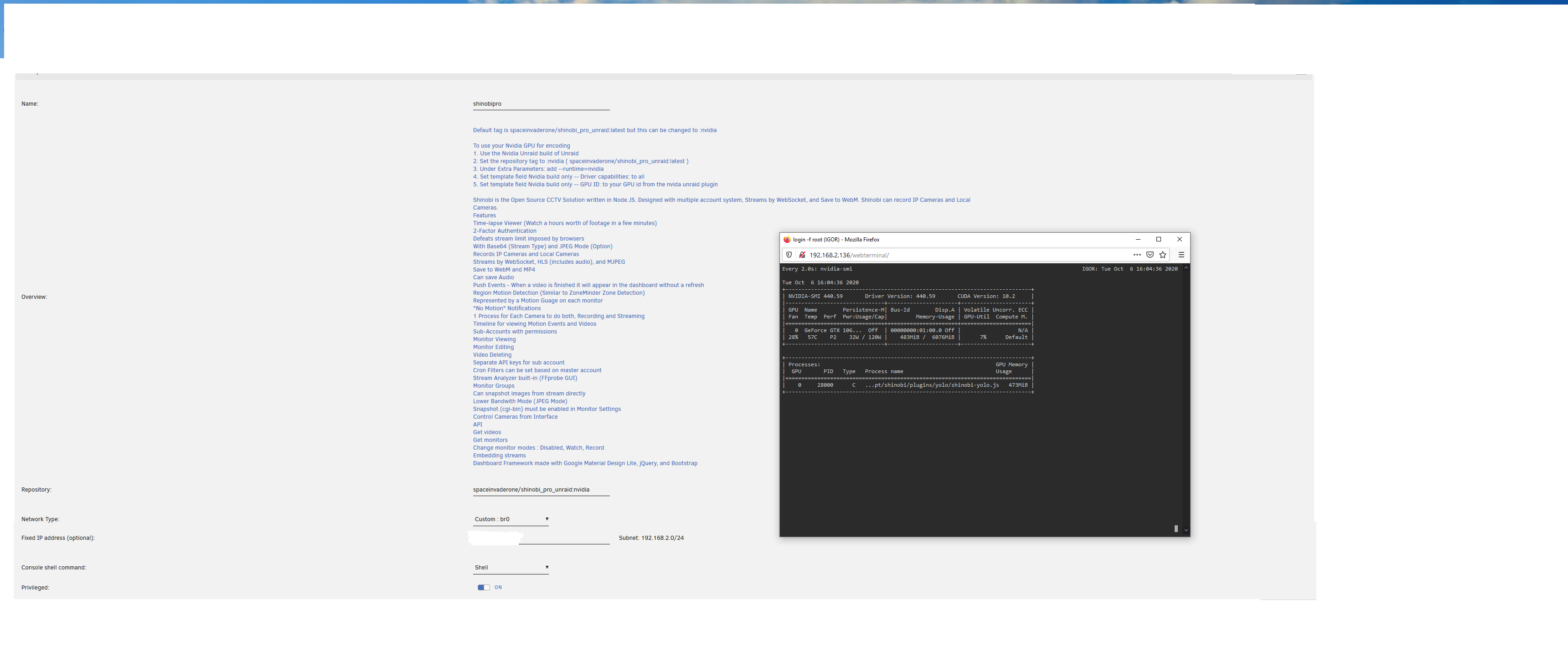

like this the exemple is on the description of the docker
i have two cam one is hikvision and the outher is escam g02 something like that, with hikvision i get 4k and send to yolo 1920x1080 without problem and the docker uses 6% cpu, but with this chineses camera i cant get to work properly uses to much cpu like 20% dont acept h264 but on the site it is h264, and have a great delay, and the reason the cpu is high is this camera need decoding and transcoding with cpu, i cant put the gpu to decode or transcode the feed of this camera.
i advise you do not buy cheap cameras, only gets you problems..
my next step is to change the weights, because this weights dont detect object detection at night. if someone could me advise on better weights, i appreciate.
Yeah that could be it, mine doesn't work with ONVIF so I set it up manually to send GET requests to my camera's PTZ endpoints. But Shinobi fails to send any HTTP request with this message
UnhandledPromiseRejectionWarning: ReferenceError: controlURL is not defined
which is not true because everything is set up correctly, as the issue on Gitlab says, this is already fixed on the latest dev version. All we need is to get the image update to Shinobi's latest

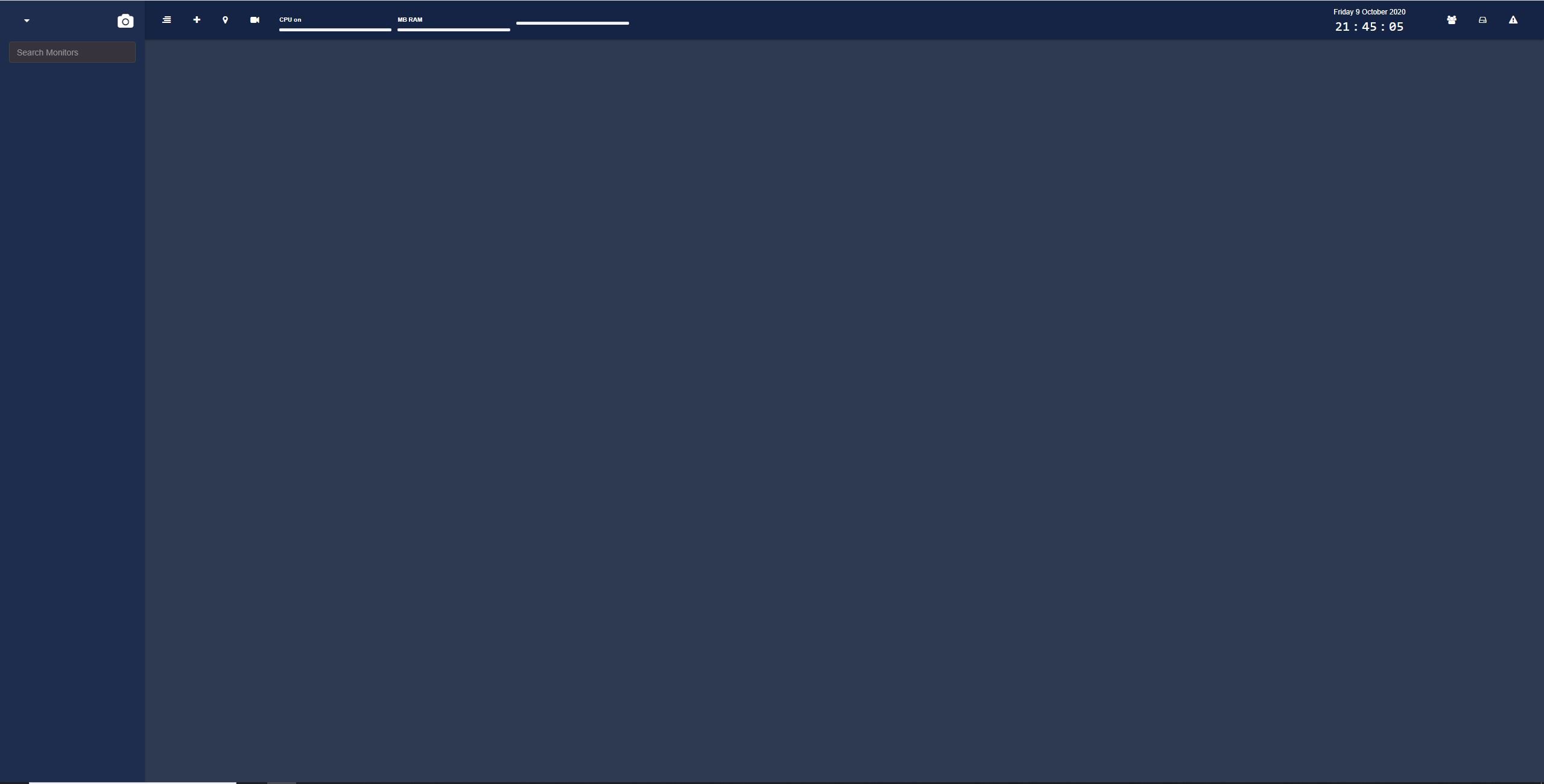

Has anyone have issues just trying to get the webUI to load correctly? I installed Shinobi a few weeks ago and everything worked great at first but I've recently had issue where monitors would not load (black screen), or the camera image would stutter or have a lot of artifacts in the image.
Like many others here I am running Reolink cameras, and when I have the issue in Shinobi I login to the cameras webUI to see if that has any issues and it never does. Now I regularly get a partially loading Shinobi webUI at times. My server is running deal Xeons with 32GB of DDR4 so I don't think its may hardware not keeping up. I'm currently only running two cameras but I want to add more soon.
Just trying to see if this is a me thing or if others are having these issues.
Also wondering what the e's are at the bottom of my log file.
