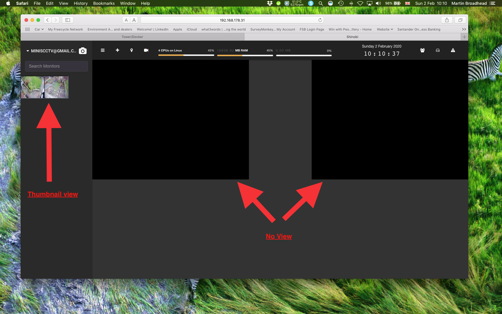

Hi Guys
    Can you please help i have followed Spaceinvaderone video on how to set up Shinobi pro at home. I have a pair of Anran 1080p Wifi enabled cameras on my house which I can view using Ispy connect running in a windows 10 vm however I would like to use them directly through Shinobi Pro for the reasons described in Spaceinvaderonevideo. The problem I have is I can view both cameras with a thumb nail however when when i have clicked on the thumbnail all i get is a blank screen (see attached) has any one got any ideas?
On 2/2/2020 at 10:22 AM, Martintheshred said:
Hi Guys

For black images, if you dont use sound (jpeg mode stream does not support sound) a work around is the following:
1) On each camera setting in shinobi (all of the cameras) enable jpeg api. Set a reasonable FPS like 3-5 depending on CPU.
2) In the top left menu under your name, scroll down and turn on jpeg mode.
This will allow any issues with the streaming protocol to fall back to jpegs while your recording is left untouched.
You can also use this setup if you want the recording to be h.265 while still being able to stream the image in a browser via jpeg mode.

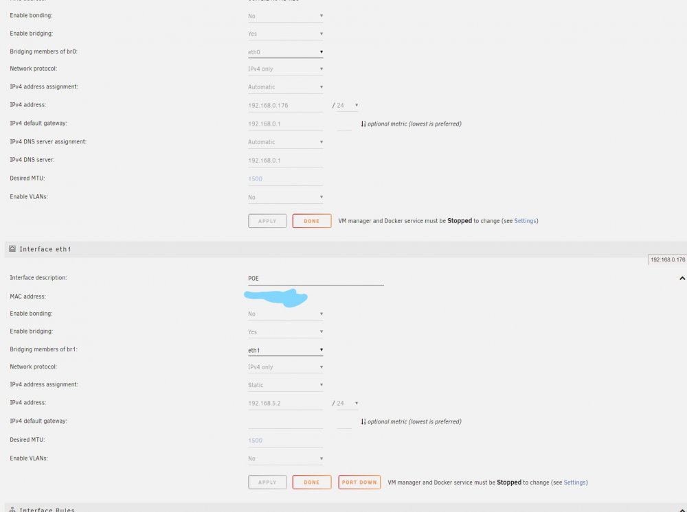

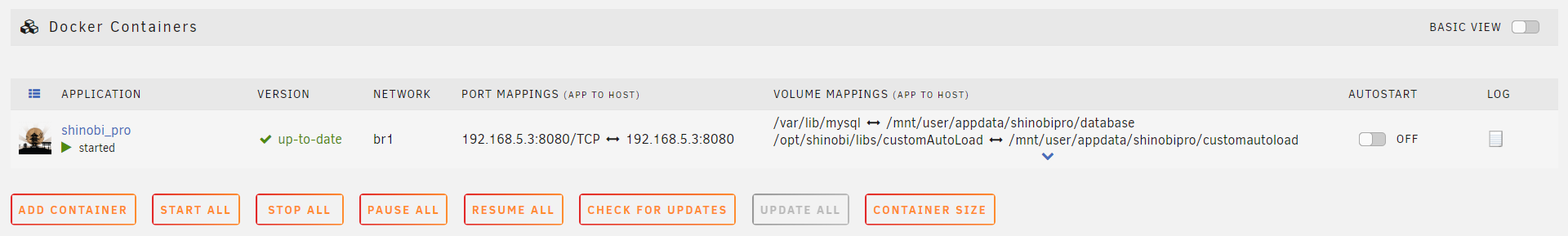

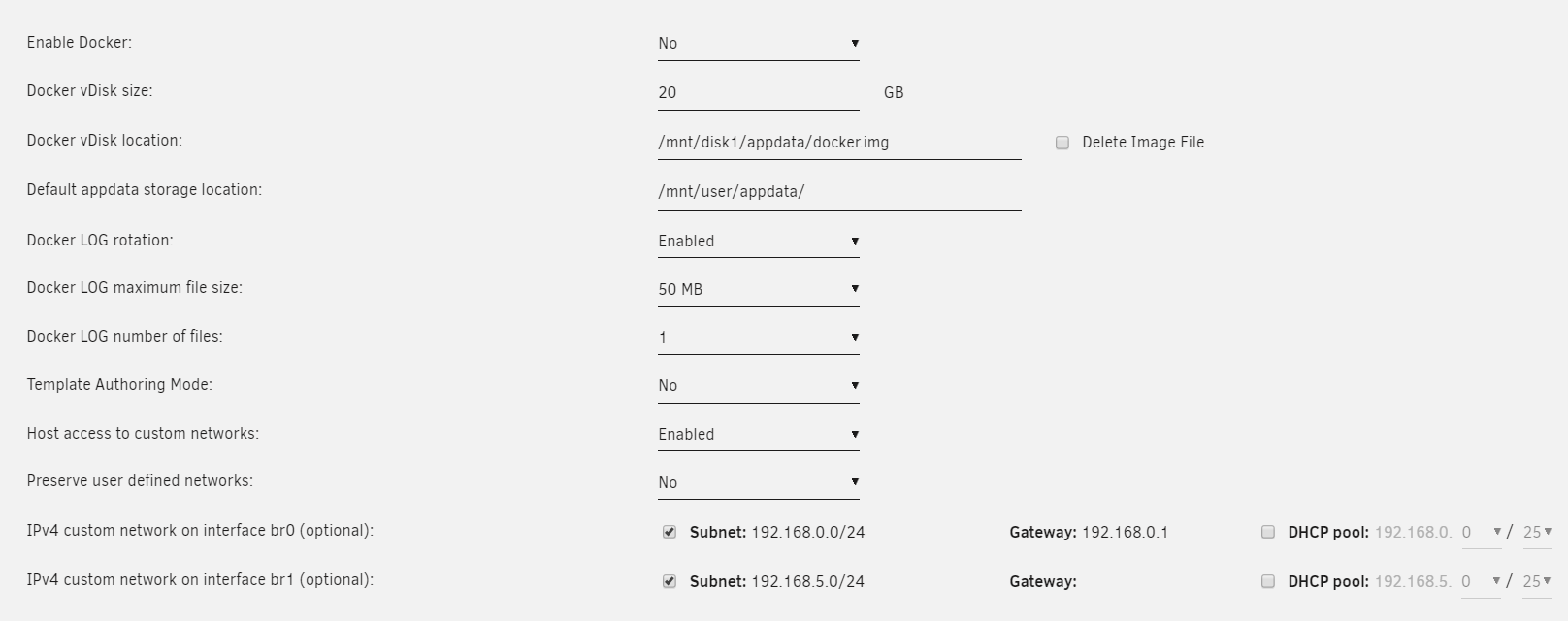

Has anyone managed to get the two NIC's option spaceinvader referenced instead of the VLAN to work properly?  I followed his video and couldn't get it to work.  I have two NIC's (eth0 or Br0 and eth1 or Br1) and I have set docker to use the Br1 custom network I created.  When I open the WebUI for Shinobi in the browser it times out and won't connect to the IP.  I wanted to have my cameras on a separate network isolated from my main that has my home devices and internet access as was mentioned in the YT video.  I currently have eth1 connected to an old router set to the 192.168.5.0 range and from there a POE unmanaged switch powering my IP cameras.

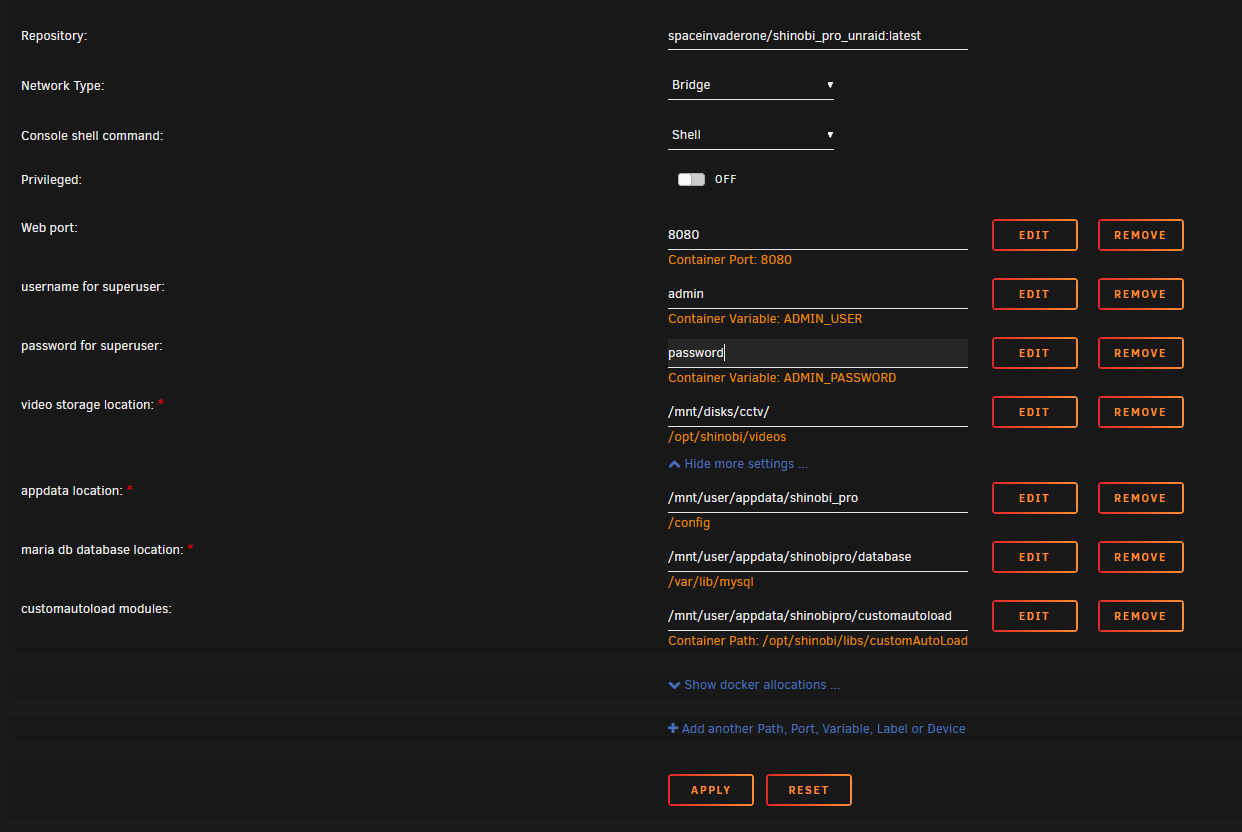

I followed the video instructions and this is what I get.
Copy custom configuration files ...
cp: cannot stat '/config/*': No such file or directory
No custom config files found.

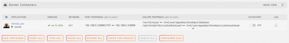

Hi Everyone,
I keep getting a cannot resolve host error when I connect Shinobi to the vlan 50 address.
fatal: unable to access 'https://gitlab.com/Shinobi-Systems/Shinobi.git/': Could not resolve host: gitlab.com
When I connect it to the bridge or proxynet networks it is successful and works. I have built my vlan on pfsense and it is giving dhcp leases and connecting to the internet. I have deleted Shinobi and I have followed Spaceinvaderone's directions, many times over, and get the same results.  Many thanks Sir for your awesome videos!
    Vlans is enabled in eth0 with number 50.
    Docker is configured with br0.50  and address is 192.168.50.0 with 192.168.50.1 set for the gateway
    Shinobi pro  container is configured 192.168.50.10 using port 8080
    Ping from Unraid terminal to 50.1 successful
    Ping form Unraid terminal to 50.10 fails
    Ping from Pfsense Lan and cctv interfaces to 50.1 successful
clearly the container is not connecting to the 50.0 network, or it is being blocked, I do not know how to proceed from here.
Any help resolving this deserves great gratitude.
Thank you

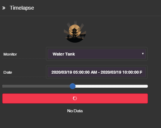

I keep trying to export the Timelapse but it seems to get stuck and never creates the export.

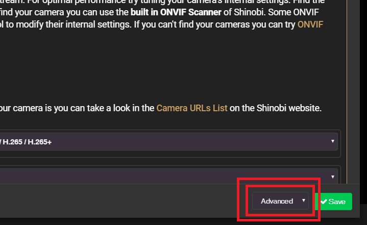

Anyone got a guide to installing object detection ?
When editing a monitor/camera, be sure to turn on Advanced Settings:

On 3/7/2020 at 2:27 PM, dawhit said:
Hi Everyone,
Thank you
Did you setup a DHCP server with your VLAN 50?  Make sure the static ip you gave to the shinobi pro container is outside the DHCP range.  If thats not the problem, the next thing I would check is your firewall settings on your router.  I was getting that same error and it turns out the firewall was blocking traffic on that VLAN.
Hope this helps.
Dan
     Thanks Dan,
Yes, I have the DHCP server enabled on the vlan 50 network.  I also have 4 cameras working on this vlan. I can access the cameras from the lan interface with ease. Wondering if my nic can cause this problem. It is only running at 100 speed and half duplex. It should be at gig speeds. I'm still trying to resolve this issue.
Thanks for your help
