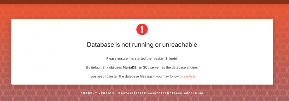

  • I got this figured out and am able to use the MariaDB inside the container to make this work. No need to run a dedicated MariaDB docker instance.   First, make sure the shinobipro docker con
  • SpaceInvaderOne
    SpaceInvaderOne
    July 29 2020 On new installs it is now necessary to manually install the database files on first run. Going to http://xxx.xxx.xxx.xxx/8080/super  and logging in you will see this

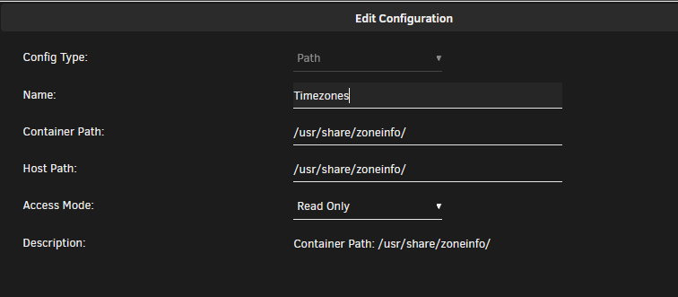

As far as the wrong time zone, mwells suggestion works but it is not persistent across reboots of the container.
I have added the following path to the container. This seems to have fixed the problem with time.

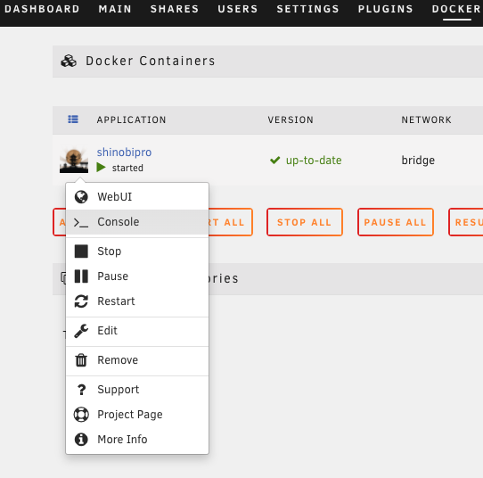

If having the problem with untracked working tree error then please do the following (very similar to what @Raf02suggests - thanks Raf)
(New installs wont have this problem)
Goto Unraid webui and click on icon to open terminal prompt
Run the following command
find /var/lib/docker/btrfs/subvolumes/*/opt/shinobi/package-lock.json -delete
Then in the Unraid 'Docker' tab, enable the 'Advanced view' (top right) after which you will see force update available for each container. Force update your shinobi container.
