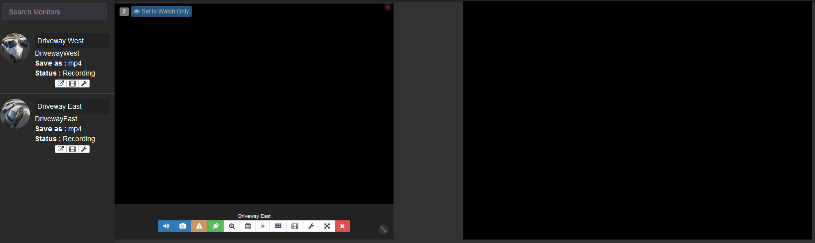

When i leave my Shinobi open, my camera monitors suddenly turns black after 7 minutes, is this normal?

Also, when i used any sort of HW acceleration setting, the Monitor windows are all black.

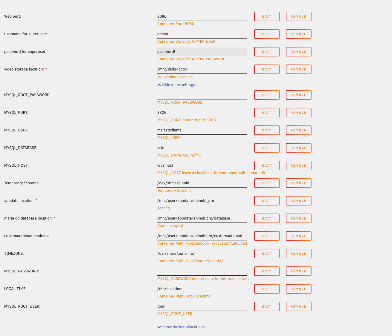

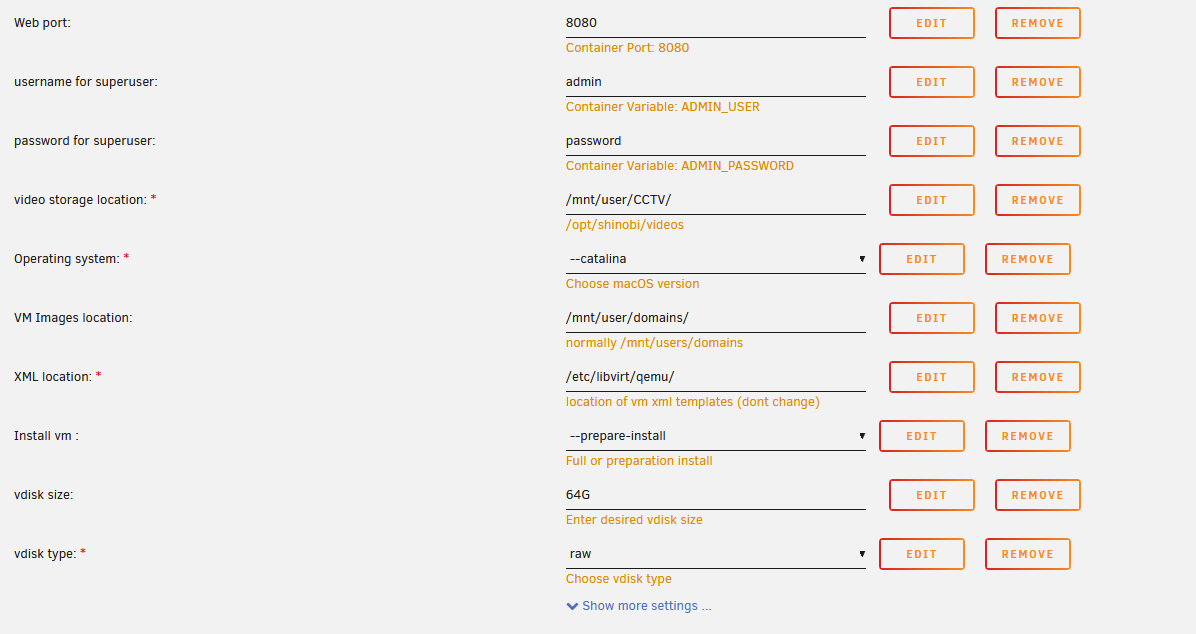

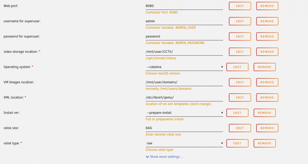

latest update break the docker, config seem to ave more thing now, @SpaceInvaderOne might need to make a new tutorial for all the new option :)
@Ong Hui Hoong  your template seems very strange it is not the correct one for some reason. it should look like this now
949156705_ScreenShot2020-05-13at22_42_45.thumb.png.d26141d821689d18a0d288e0cde69a30.png
You will not need to change any settings for your Shinobi to continue working. These are all additional extra settings
mainly only if you want dont want to use the built in mariadb server in the container but would like to use a separate
msql outside of the container.

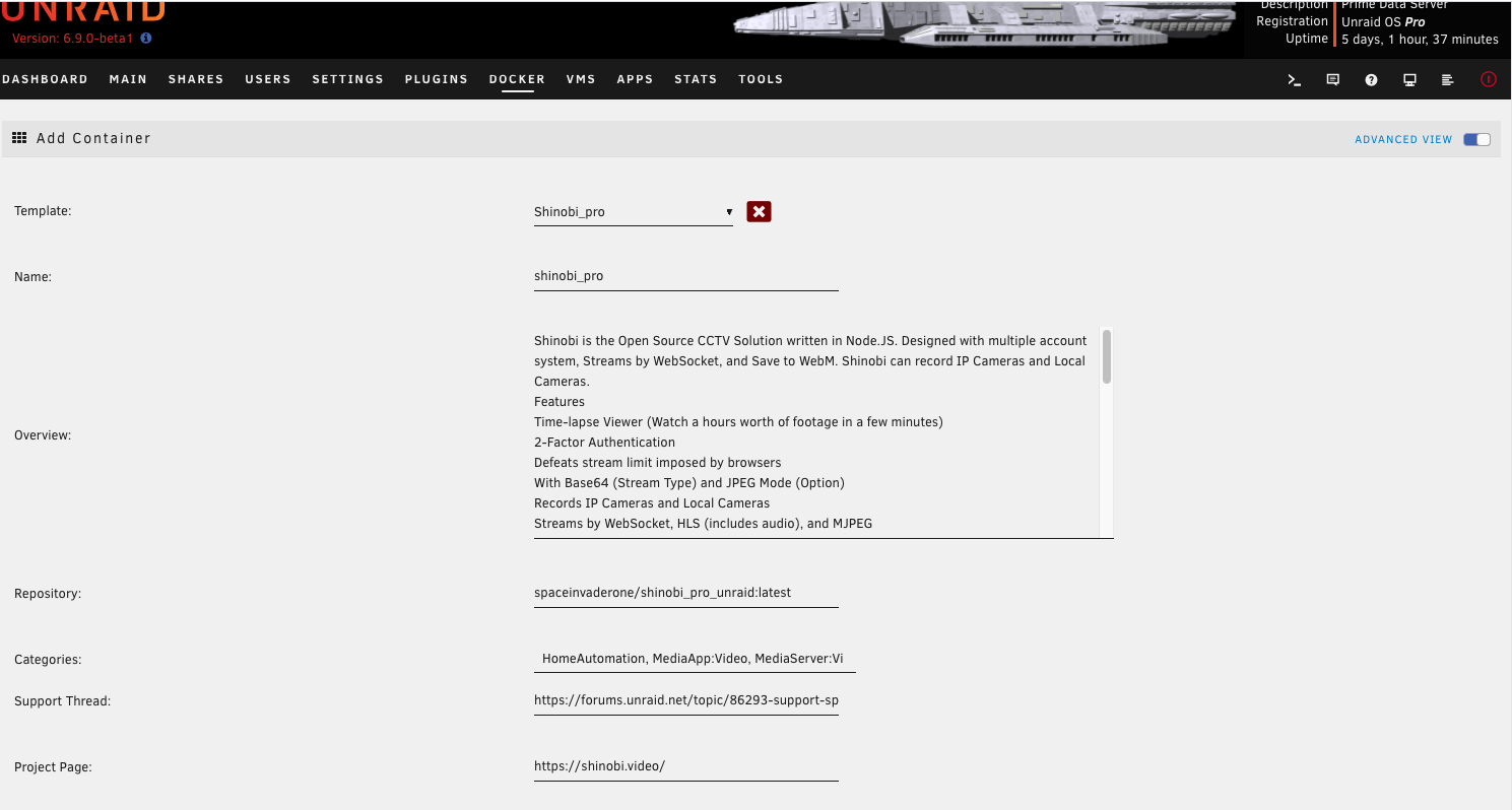

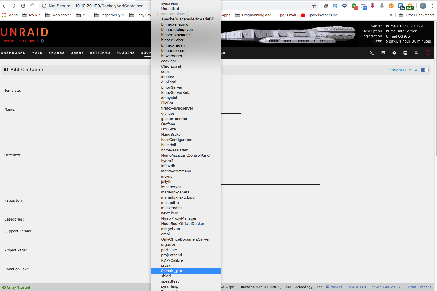

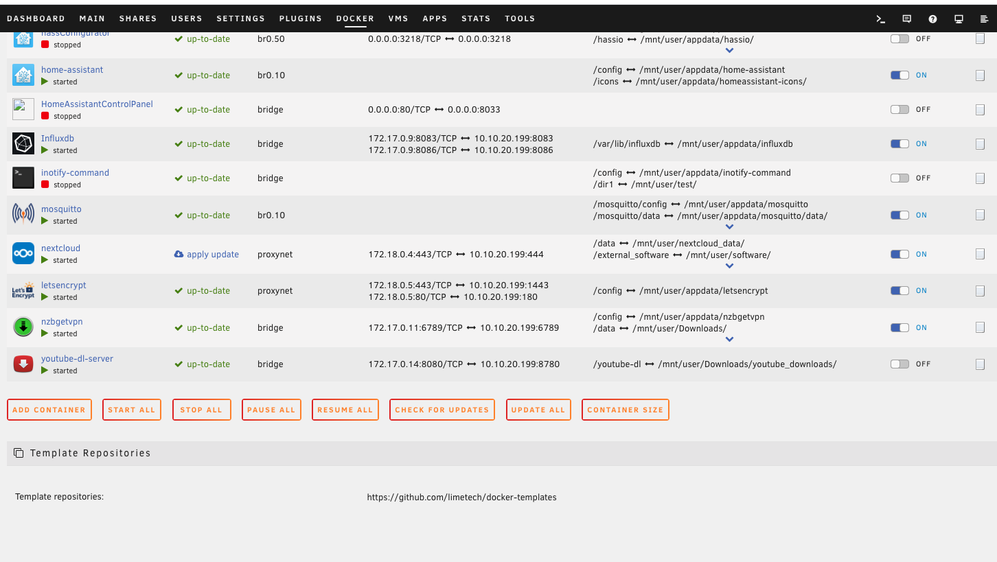

Anyway you will need to delete the template that you have. (just make a note of your video storage location path as after deleting you will need to put  that back in)
please do these steps.
1. Stop and delete the container.
2. On the docker page goto the bottom and click add container.
1646204648_ScreenShot2020-05-13at19_51_48.thumb.png.04ee419ad4ec63d48874cc7a968494f3.png
Then find the shinobi pro template that is stored locally on your server here.
762446795_ScreenShot2020-05-13at19_52_30.thumb.png.d1304941d265ed9cc403ef3876d1a148.png
Select it now click on the red cross to delete the template.
53508337_ScreenShot2020-05-13at19_52_57.thumb.png.04e2403983cc449d67222a1a9aa4f8f4.png
Now you can goto CA and search for shinobipro and redownload the container. Just put back in your video location in the template and pull down the container.
All the appdata will still be there as well as all your recorded footage.
Hope thsi helps :)
