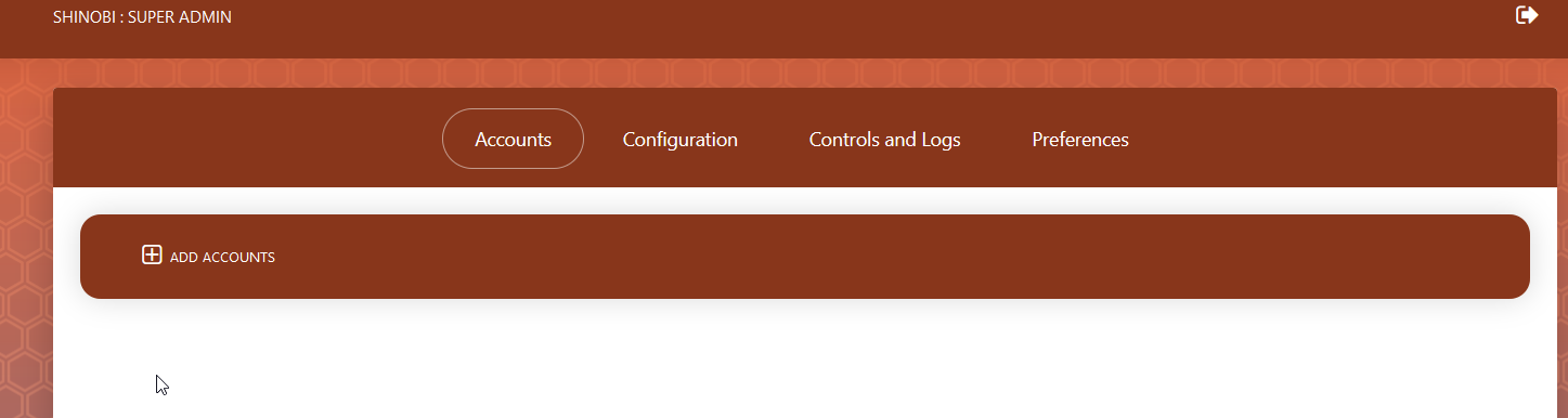

I had to reinstall today and it seems there's a few problems.
  1. install scripts are not creating db (few posts above describe this)
  2. I'm not able to add this user:
When i click add account, populate all the information and save, it doesn't do anything at all. No errors in UI or logs, no indication of saving.  Refreshing the doesn't show the user I attempted to create.
Noticed the author updated a day ago and also know that gitlab upgraded today.   <maybe that's it>
Try doing it with the JavaScript Console open and see if you see any errors. It's generally under the Developer menu for most browsers.
