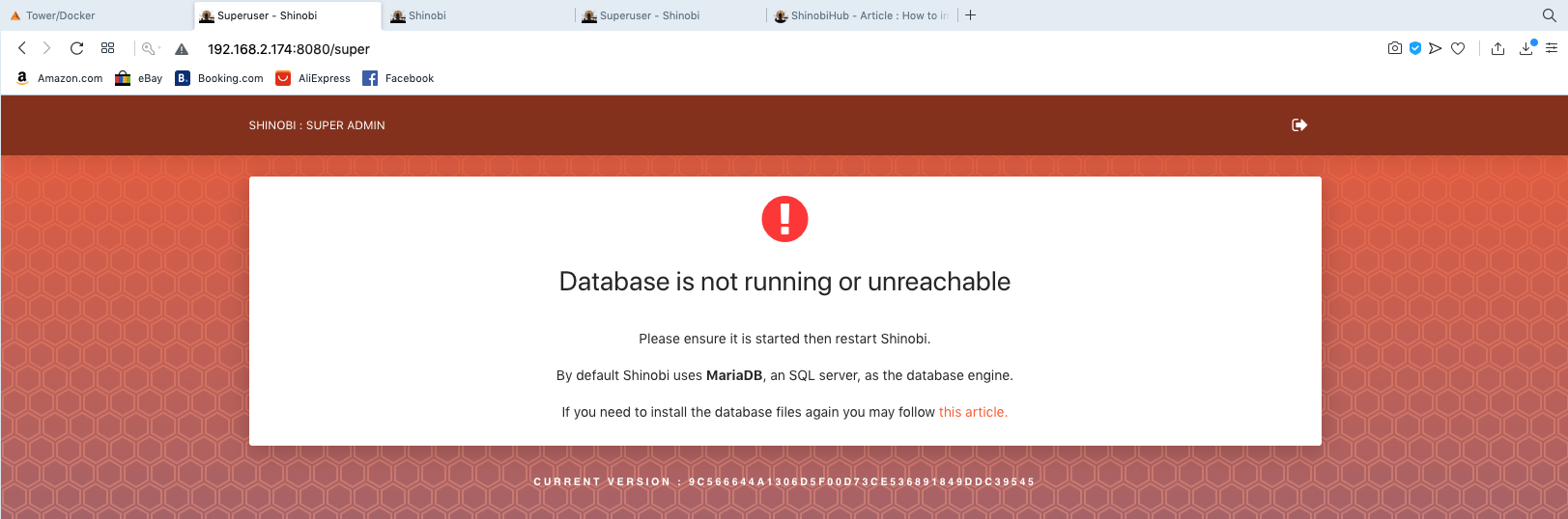

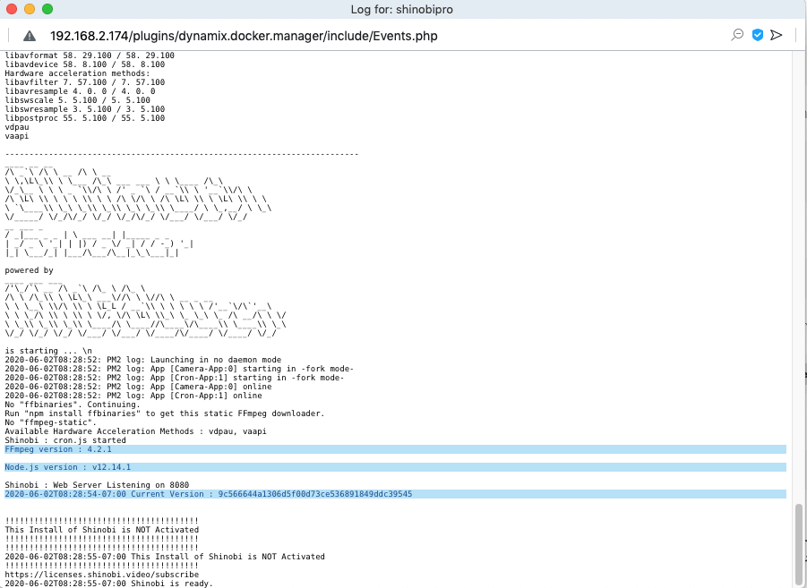

Hi all, I installed shinobi pro, but at the end of the installation, I get all kinds of errors.
Here is my installation log:
Any tips?
Any tips?
look up a few posts about manually running sql in the container.

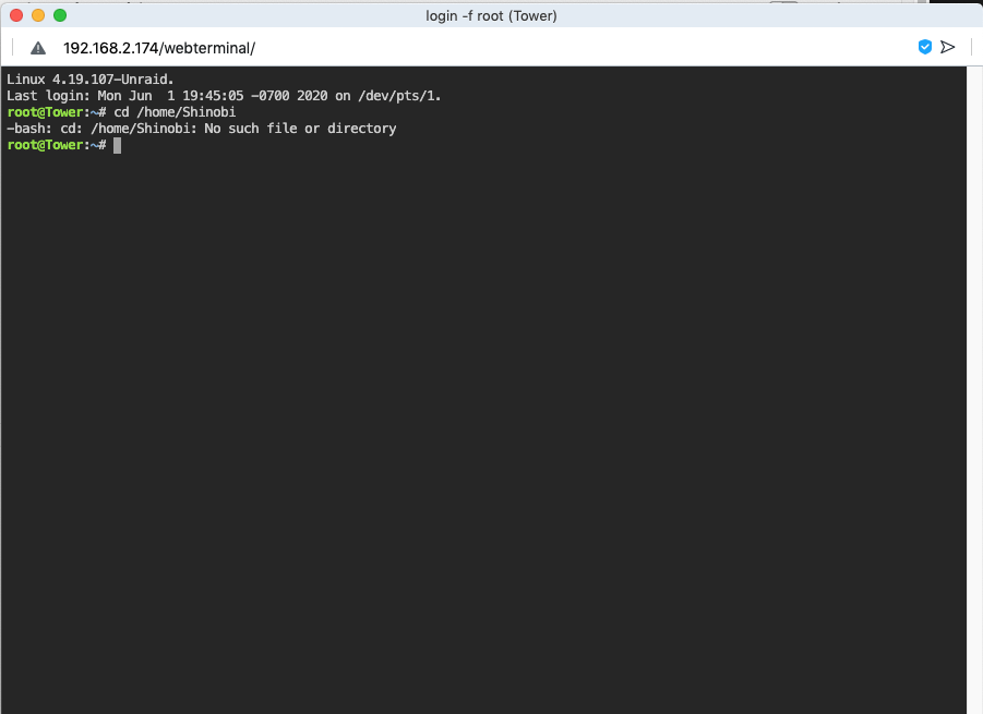

3 hours ago, repomanz said:
rajorrala. follow this instruction
  On 5/17/2020 at 7:29 PM, runraid said:
I got this figured out and am able to use the MariaDB inside the container to make this work. No need to run a dedicated MariaDB docker instance.
First, make sure the shinobipro docker container is running. Log into the console of the container, either by using the unraid feature or by this command:
docker exec -ti shinobipro sh
Next, create the database and tables...
mysql source sql/framework.sql; source sql/user.sql; exit
Now restart the container and it will work.
Thanks a lot for your patience and your time.

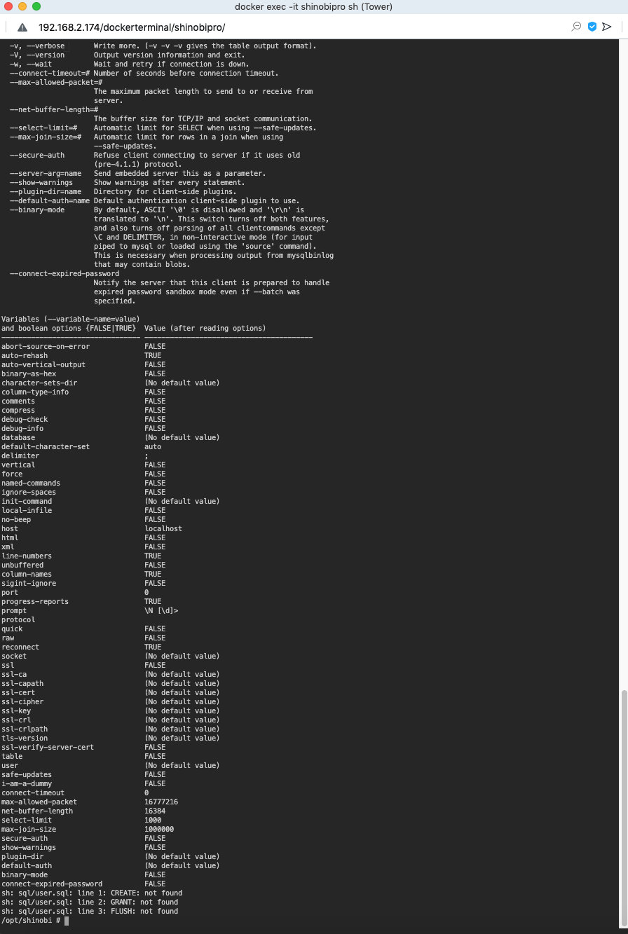

I did as you said, but, I guess it didn´t work. Here is the terminal window print. At the end it reads :
sh: sql/user.sql: line 1: CREATE: not found
sh: sql/user.sql: line 2: GRANT: not found
sh: sql/user.sql: line 3: FLUSH: not found
Here is the screenshot:
35485691_ScreenShot2020-06-02at10_09_23AM.thumb.png.68d6c0bb54a01057041f3c0c94680863.png
Thank you for your valuable time.
Ok, many thanks repomanz!
I din't get it at the first time.
This is what I did and I hope it help others:
I tryed to open the terminal window from the container, it said that it did not exist. So I went to the main console and wrote the first instruction:
"docker exec -ti shinobipro sh" - If I'm not misstaken (sorry I'm not an IT guy or I understand a lot of linux) this instruction created the docker console for shinobi.
The next instructions you gave me ( mysql source sql/framework.sql; source sql/user.sql; ) didn't work, I don't know why. But now that the docker console was created I could log in and from ther I could do the steps mentioned in the shinoby article in this webpage:
https://hub.shinobi.video/articles/view/wcz3OabYEfOhS7h
If you don't want to go to the webpage, here are the instrucions:
Installing the database for MariaDB/MySQL
1. Navigate to your Shinobi directory
cd /home/Shinobi
2. Open the MariaDB/MySQL Terminal client.
mysql
3. Load the SQL files. framework.sql is the database architecture. user.sql are the credentials for Shinobi to connect to the database.
4. Exit the SQL client
exit;
4. If you need to enable the mysql database type you can run the following.
node tools/modifyConfiguration.js databaseType=mysql
5. Restart Shinobi
pm2 restart all.
I have to tell you that I got some errors, but then I went and check shinobi's log, I finally got Shinobi up and running:
So now I can continue configuring my shinobi, and I hope that you can too.
Thanks a lot for your patience and understanding, I don't know what I did wrong when installing Shinobi, that its docker console wasn`t created, thus, the database wasn´t created either rendering my shinoby useless.
I'll see you around because I know I will have more doubts!
Cheers

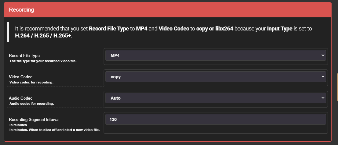

I just moved over from using Monitioneye to Shinobi and I have ran into a few issues, which I hope are easy fix's
First.  is there a way to get the time and data, displayed on the feed and then record. as I have my recording 24/7  with 120 mins segments, but I can't find were to set the time and data 'Watermark'
also I seen that my saved files re jumping all over the place from 2gb to 5.5gbs and I don't know why. when my settings are as follows.
@SpaceInvaderOne first I would like to say that I love your videos and they are informative and clear to follow.

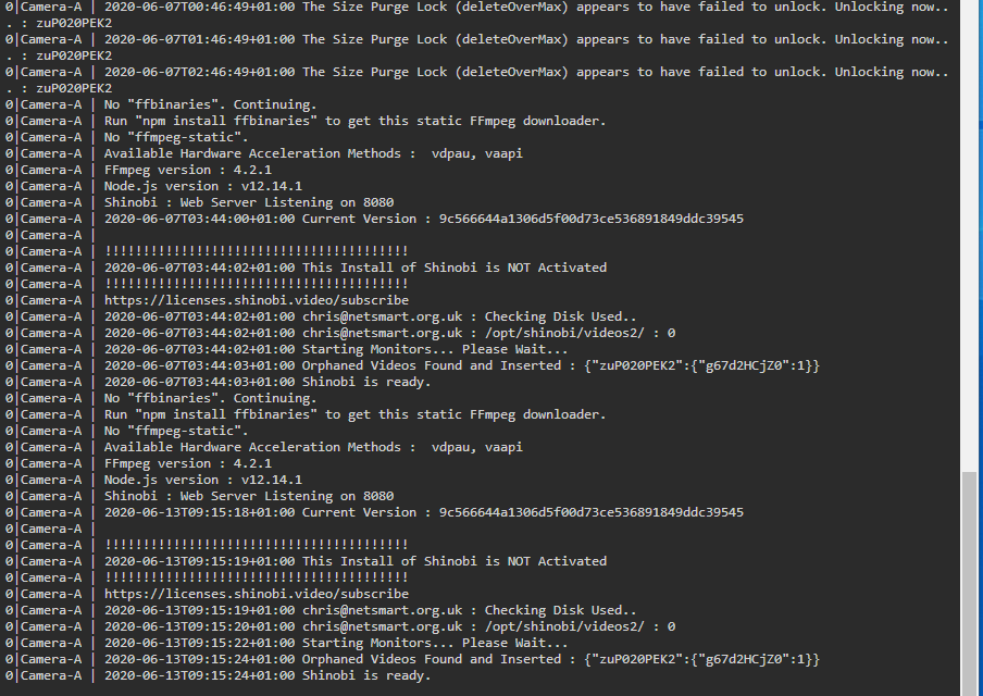

I got the same problem, and trying to understand the instructors is confusing.
so I did a install of the docker application, and now when I try and find the " /home/Shinobi" within the docker or within Unraid I am inform that it can't be found
I also try some of the offer commands and get the same issues no like sh: source: can't open 'sql/framework.sq': No such file or directory.
so can someone please write a dummy step by step so that we can get this docker up and running.

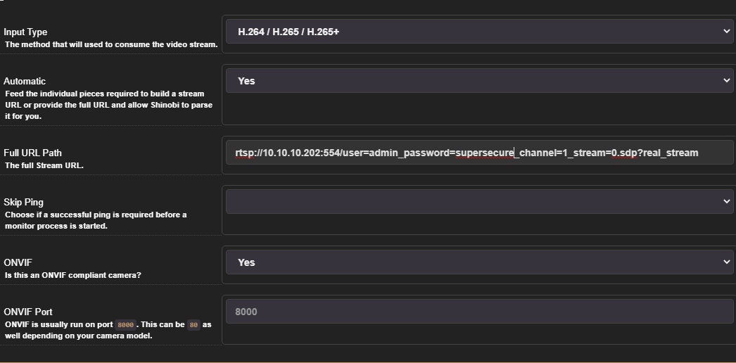

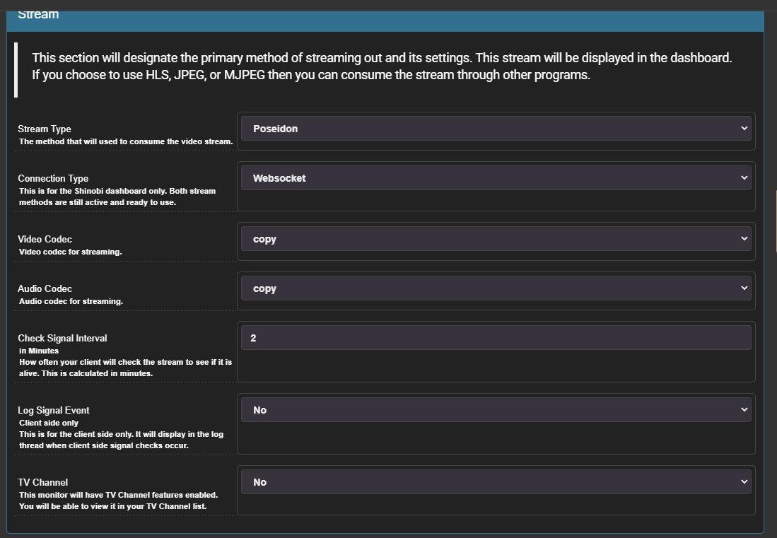

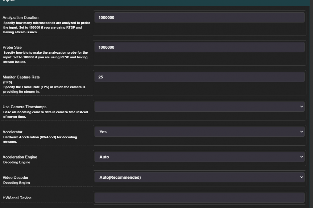

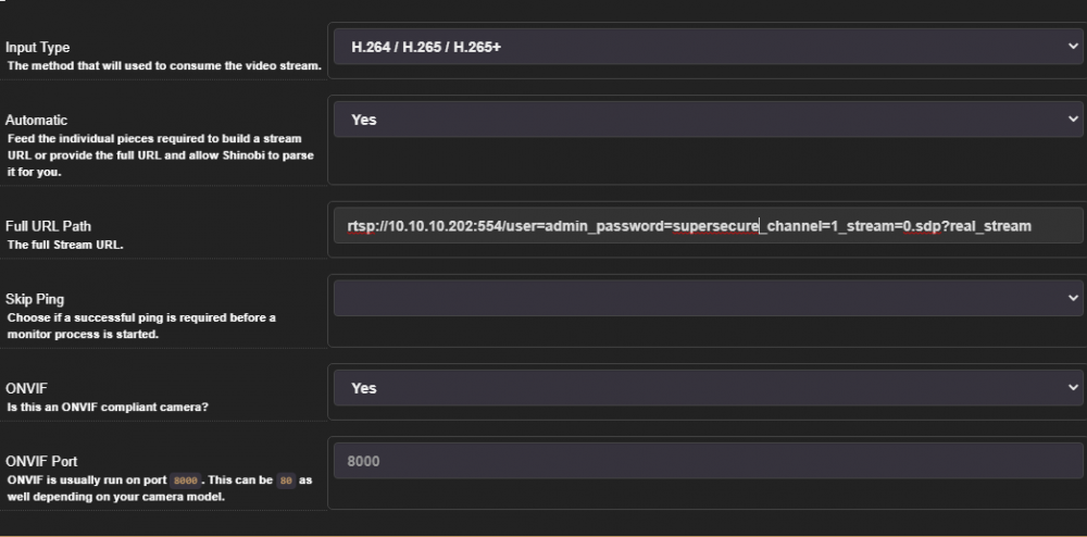

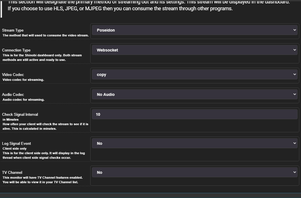

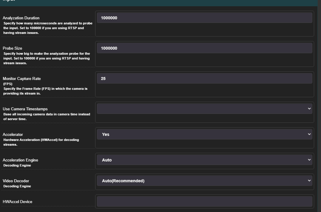

Hello, i'm setting up Shinobi but i'm having some delay issues.
I have 3 ip cameras. which i have added to shinobi with an rtsp link
They are outputing 1080p - 25fps - 4mbit bitrate - h265x (dont know what x means, probably +?)
On shinobi i have Analyzation Duration and Probe Size at 1000000 (changing them doesn't affect the delay)
Right now i have about 30sec delay. And streams some times freeze for 10 sec or so.
I use Poseidon - Websocket  - copy codec on stream settings.
All 3 cameras are on the same local network (gigabit) and accessing shinobi webui locally (not through reverse proxy or anything).
if i use the same rtsp url on vlc. i get less than a second delay. (almost realtime)
Also changing cameras even to 15 fps makes little to no difference in delay...
Is this something that i can fix?
Thanks!
Please let me know if you need more info...

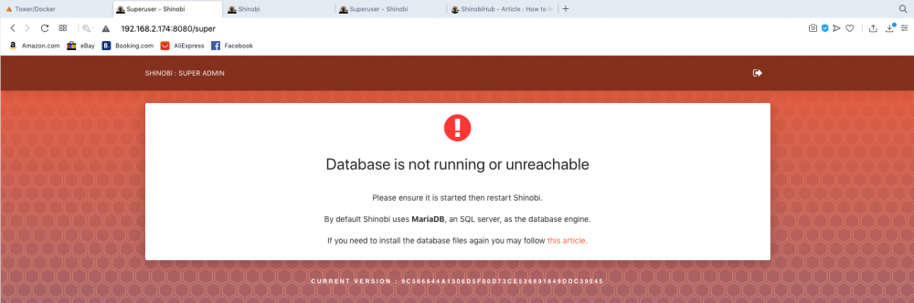

I just installed this docker and was having the same issue as chris_netsmart.  Went to Shinobi's website and read their installation instructions.  Discovered if you login to the console of this docker and perform the following that you will be able to login with the docker's default username and password.  I was then able to create my own username/password.  Wondering if there is something wrong with the template that is not inserting the values that we define at docker install/creation.
Set up Superuser Access
Rename super.sample.json to super.json. Run the following command inside the Shinobi directory with terminal. Passwords are saved as MD5 strings. You only need to do this step once.
cp super.sample.json super.json
Login at http://your.shinobi.video/super.
Username : [email protected]
Password : admin
You should now be able to manage accounts
Here is the direct link for the above....go to account management section:  https://shinobi.video/docs/start
