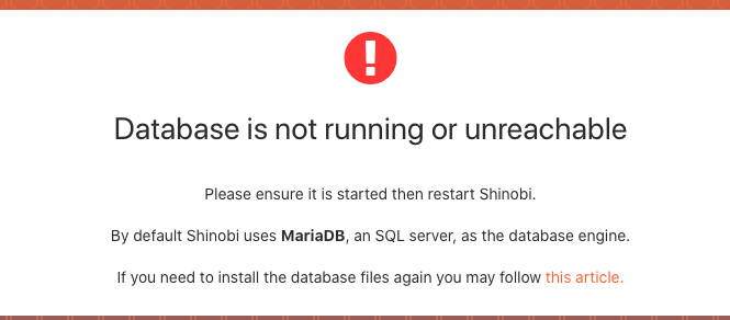

On 5/18/2020 at 1:29 AM, runraid said:
I got this figured out and am able to use the MariaDB inside the container to make this work. No need to run a dedicated MariaDB docker instance.
First, make sure the shinobipro docker container is running. Log into the console of the container, either by using the unraid feature or by this command:
docker exec -ti shinobipro sh
Next, create the database and tables...
mysql
source sql/framework.sql;
source sql/user.sql;
exit
Now restart the container and it will work.
I have just go through the fourm chat and I found the above steps, and it looks like it resolve the SQL DB Issue.

I got the DB errors resolved using this info, which should definitely be included in the first post and app instructions.
Also, I tried installing this container and got to the Shinobi Web UI, but it's complaining about lack of MariaDB:
I thought MariaDB/MySQL was included as part of the container and created automatically? What am I missing?

On 5/28/2020 at 4:00 PM, Phoenix Down said:
Make sure the Shinobi docker is running, then open a console for the docker (click on the Shinobi icon, then choose "Console"), then run the following:
mysql
exit
Brilliant!!  Thanks!!!
