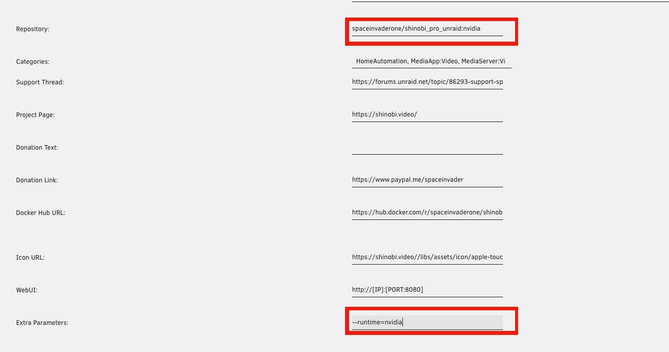

July 31, 20206 yr Hi, I want to install a gpu in my Shinobi to relieve some workload from the GPU, I've been searching and I found a document on Shinobi with some instructions for adding an Nvidia card to work with Shinobi, have any of you installed a GPU with these instructions? https://shinobi.video/docs/gpu Thanks in advance.

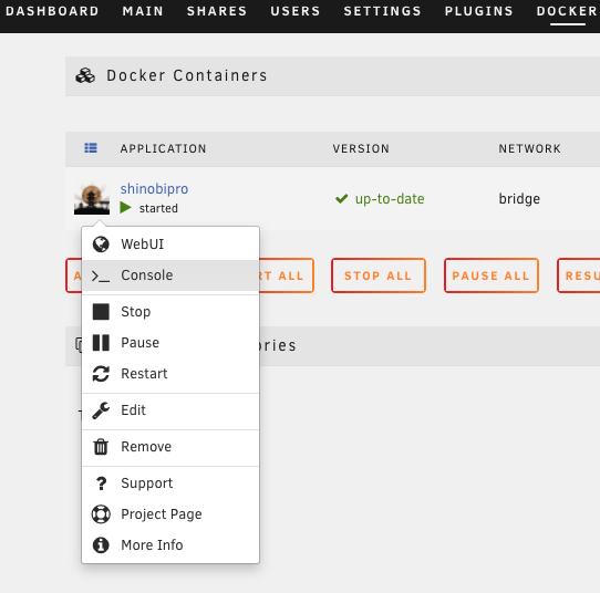

August 2, 20206 yr 1 hour ago, pepbill said: I can't seem to figure out where to run: cd /home/Shinobi node tools/modifyConfiguration.js addToConfig='{"dropInEventServer":true, "ftpServer":true}' I don't use this but I assume you would have to go to the command line inside the container. Click on the icon for the container and select Console

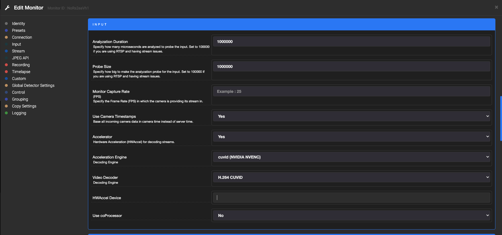

August 6, 20206 yr I'm looking for some guidance on using shinobi. I have experienced lots of issues actually running the intreface in a browser. Using chrome and firefox on Ubuntu/Windows, is extremely laggy, and buggy. I watch CPU usage skyrocket on single cores, and modifying regions for recording is impossible. Frequently it misses movements and doesn't record. This is all done with 16GB of ram and 8 cores, and dedicated GPUs. This isn't a resource problem but my environment is unstable. Followed the guide to the letter. Anyone else experienced this ?
August 6, 20206 yr 27 minutes ago, bobo89 said: I'm looking for some guidance on using shinobi. I have experienced lots of issues actually running the intreface in a browser. Using chrome and firefox on Ubuntu/Windows, is extremely laggy, and buggy. I watch CPU usage skyrocket on single cores, and modifying regions for recording is impossible. Frequently it misses movements and doesn't record. This is all done with 16GB of ram and 8 cores, and dedicated GPUs. This isn't a resource problem but my environment is unstable. Followed the guide to the letter. Anyone else experienced this ? Sounds like you might be transcoding the video stream, which always requires a ton of CPU power and is just not worth it IMHO. Find out what format video stream your IP cam produces, and then set the video format in Shinobi to match. For me, it's H.264. During active recording, my 8 core CPU uses less than 1% utilization for 2 cameras. In this case, Shinobi is just taking the video streams from the cameras and saving them to disk, which takes very little CPU power. Edited August 6, 20206 yr by Phoenix Down
August 6, 20206 yr Sounds like you might be transcoding the video stream, which always requires a ton of CPU power and is just not worth it IMHO. Find out what format video stream your IP cam produces, and then set the video format in Shinobi to match. For me, it's H.264. During active recording, my 8 core CPU uses less than 1% utilization for 2 cameras. In this case, Shinobi is just taking the video streams from the cameras and saving them to disk, which takes very little CPU power.Good idea. I tried that. 2 cameras are h264 the other are h265. Does the selection of of which streaming protocol matter? Poseidon? H265? Just using the whole Web app jokes my browser up. It almost feels like it's a client issueSent from my SM-N960W using Tapatalk
August 6, 20206 yr 30 minutes ago, bobo89 said: Good idea. I tried that. 2 cameras are h264 the other are h265. Does the selection of of which streaming protocol matter? Poseidon? H265? Just using the whole Web app jokes my browser up. It almost feels like it's a client issue Sent from my SM-N960W using Tapatalk Check out this guide: https://hub.shinobi.video/articles/view/DmWIID78VtvEfnf

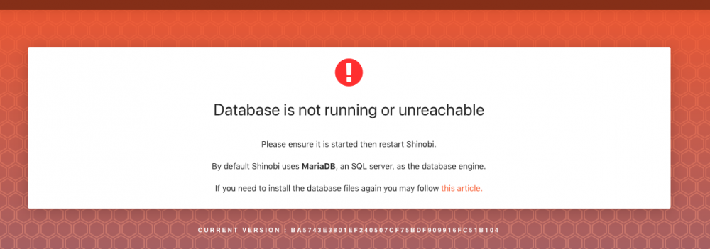

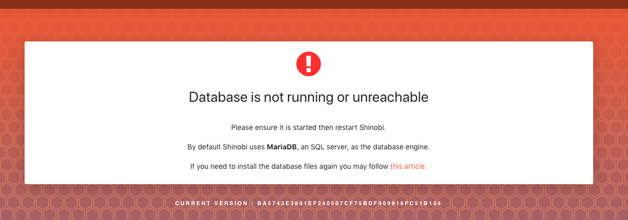

August 13, 20206 yr On 12/18/2019 at 2:09 PM, SpaceInvaderOne said: July 29 2020 On new installs it is now necessary to manually install the database files on first run. Going to http://xxx.xxx.xxx.xxx/8080/super and logging in you will see this Now goto the docker tab and select the shinobipro container and click console. This will open a terminal inside of the container. Now run these commands below mysql source sql/framework.sql; source sql/user.sql; exit Now close terminal window and restart the container. ---------------------------------------------------------------------------------------------------------------------------------------------- NVIDIA UNRAID USERS ONLY You can use your gpu to do the encoding when you are using Linuxserver's Nvidia Unraid build. To do this you will need to make some changes to the template when you install the container. You will need to change the view to advanced view then 1. Change the tag on the repository from :latest to :nvidia as below spaceinvaderone/shinobi_pro_unraid:nvidia 2. Under Extra parameters add --runtime=nvidia Lastly you will see 2 parts in the template relating to Nvidia Driver capabilities set to all GPU is set to the ID of your nvidia gpu as shown in the Unraid nvidia plugin Well, Thanks for the info, but there is no way I can make this work. I had shinobi pro installed, so I changed the name of the repository to "nvidia" and it downoaded like 2 Gigs and the CPU usage never came down and the GPU usage remained in 0%. By the way, I didn't get the 2 options: Driver Capabilities and GPU ID. I had added them as variables in my last attempt. So I deleted the container, installed it again and the last 2 options appeared (Driver capabilities and GPU ID). I did not make a lot of configurations because Shinobi was configured as I had it (I don´t know why) So I ran it again, and set up my cameras to access the Hardware, and nothing happens. Take a look at this: The HWAccel Device is blank, I have tryed to type my hardware ID and it completely ignores it...and Regarding the CoProcessor I don't even know what that is. I asked for a manual to Shinobi support and they did the same as their software (exactly: ignore me). Here is a screenshot of my dashboard running a VM Windows 10 VM (@ idle by the way). My DHCP Server and Shinobi with only one camera with a still image in my Xeon E5 2403 ( pretty useless by the way) . My CPU is at 37% while my GPU is on vacation zipping some margaritas at the beach! (I'm being sarcastic by the way) So, I hope you can give me a bit of help on this one because I'm loosing my hair on this. Any kind of help will be very appreciated it. Thanks in advance

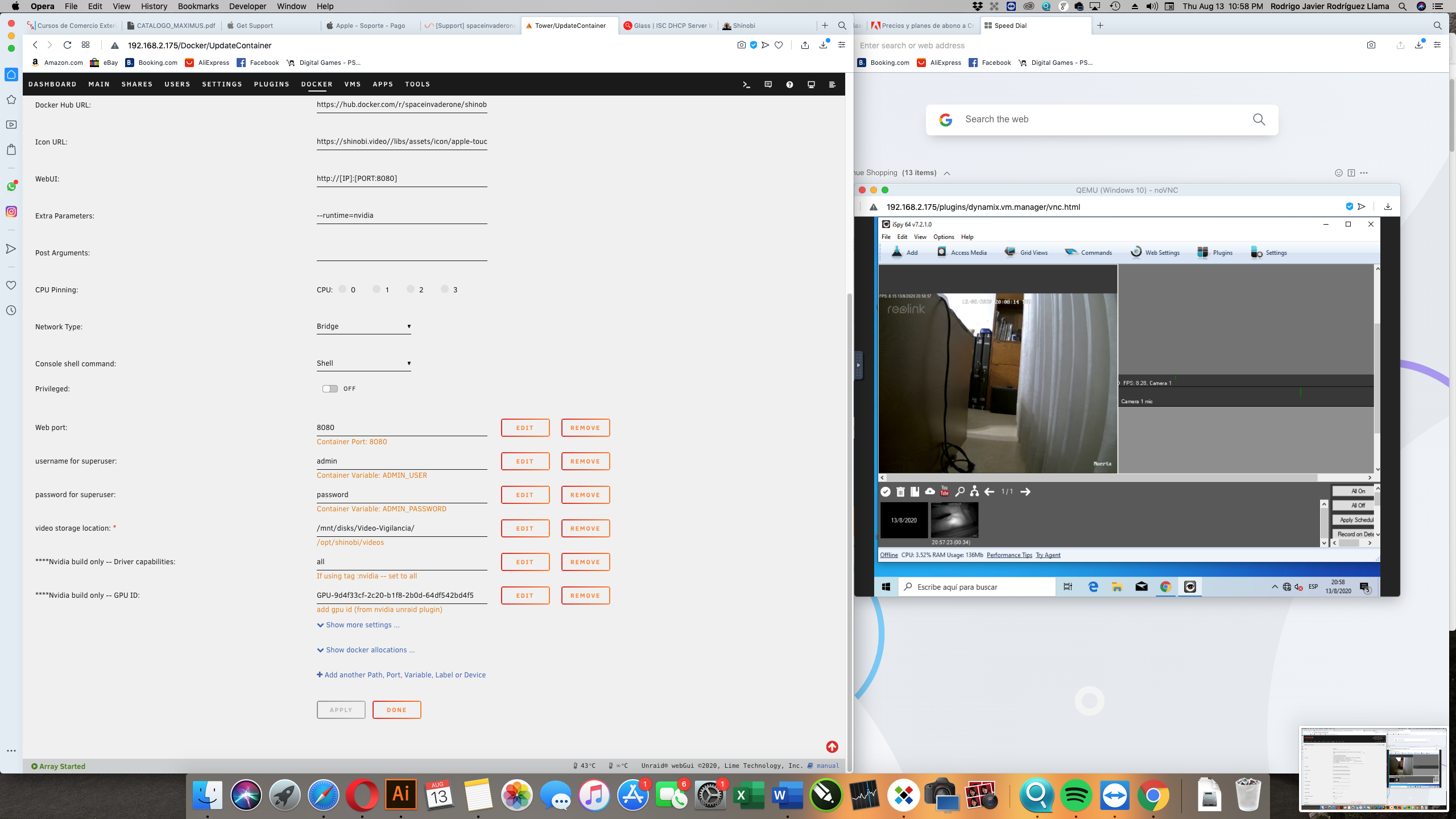

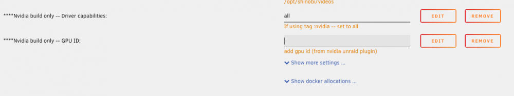

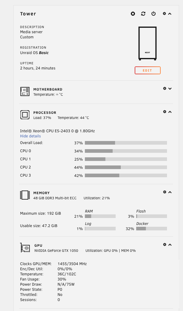

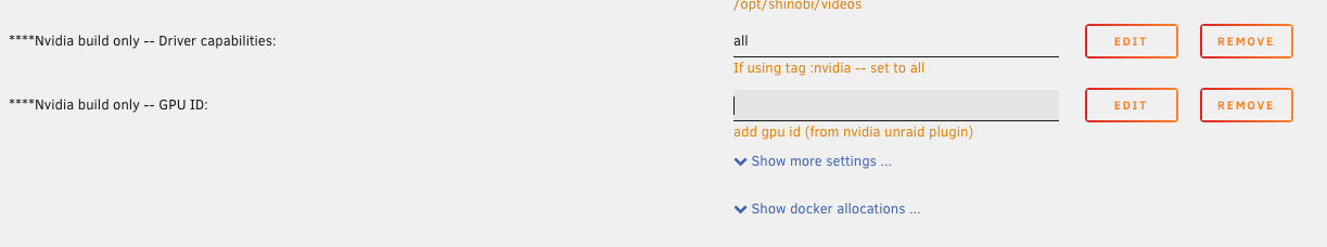

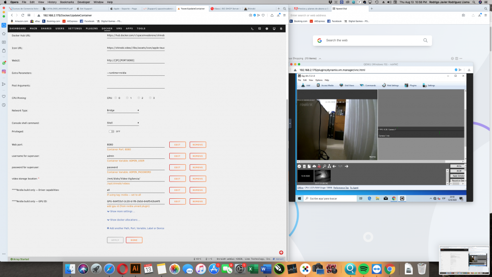

August 13, 20206 yr Author 16 hours ago, rojarrolla said: So, I hope you can give me a bit of help on this one because I'm loosing my hair on this. Any kind of help will be very appreciated it. Thanks in advance Yes the extra variables in the template may need you to delete the old template from the server so the new one is pulled down from community applications if on updating the container it doesnt change. So you have filled in the 2 variables driver capabilities to all and the id number of your gpu from the nvidia plugin. But you didnt say if you set the extra parameter (advanced view) to --runtime=nvidia If all these are set then please post screen shots of how the template is filled in.
August 13, 20206 yr I have given up on shinobi. It's all too flaky. What is working well for me is Blue Iris 5. Well worth £60. It is even running well with 6 camera's in a Windows 10 VM on an unraid box with an I7 4790k.
August 14, 20206 yr 6 hours ago, SpaceInvaderOne said: Yes the extra variables in the template may need you to delete the old template from the server so the new one is pulled down from community applications if on updating the container it doesnt change. So you have filled in the 2 variables driver capabilities to all and the id number of your gpu from the nvidia plugin. But you didnt say if you set the extra parameter (advanced view) to --runtime=nvidia If all these are set then please post screen shots of how the template is filled in. Dear Edward, Thanks for replying, I always try to do everything as you say. To answer your question, yes I did set the extra parameter: --runtime=nvidia. Here are some screenshots, at the left there is shinoby working and on the right is my virtual machine running Ispy on windows 10. (I set this as you said in your video) I have set at this moment 2 cameras, (The other 4 were reconnected back to my noisy and lousy Reolink NVR ) 1 is broken and only streams a gray screen, the other... well I thought it was dead, but now is working again and is streaming part of my studio. Here is my dashboard, the GPU is at 0% while the CPU only with shinobi, The VM only recording the stream is 58%. Here is the template top part The rest of the template. Thanks a lot!

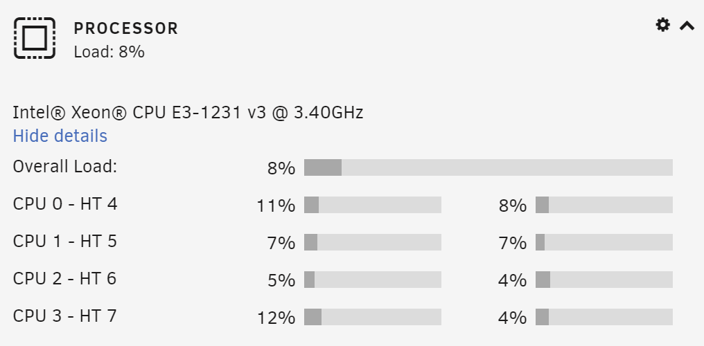

August 15, 20206 yr On 8/13/2020 at 5:53 PM, Dragosani said: I have given up on shinobi. It's all too flaky. What is working well for me is Blue Iris 5. Well worth £60. It is even running well with 6 camera's in a Windows 10 VM on an unraid box with an I7 4790k. I agree with you, Shinobi is way difficult to setup. What CPU usage do you get with that setup? And what resolution are you using?

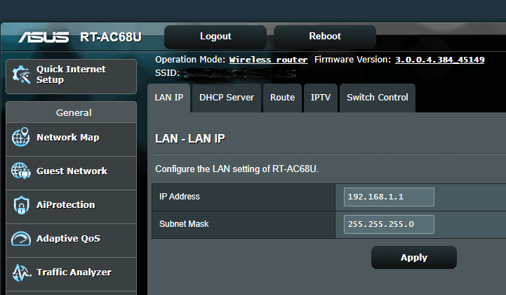

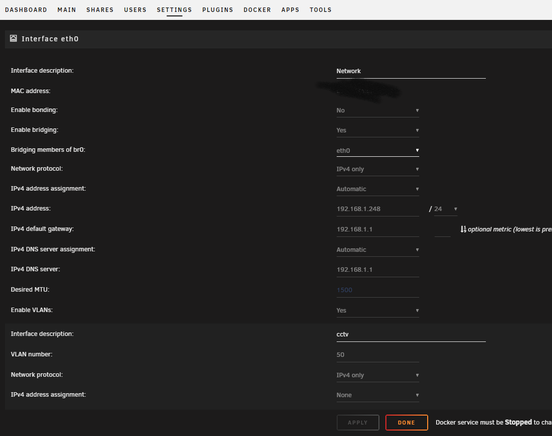

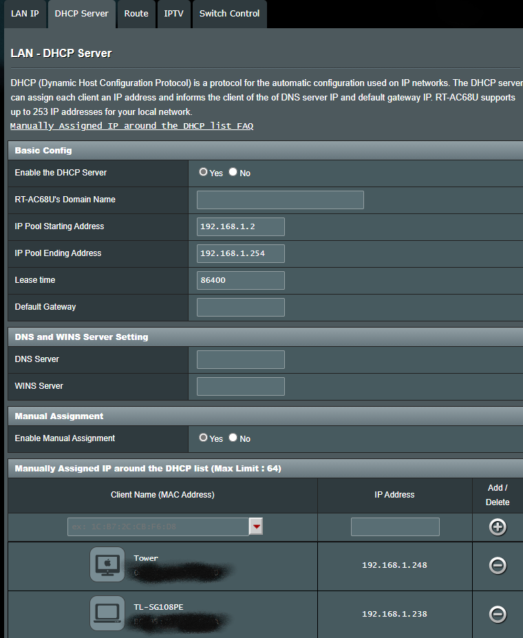

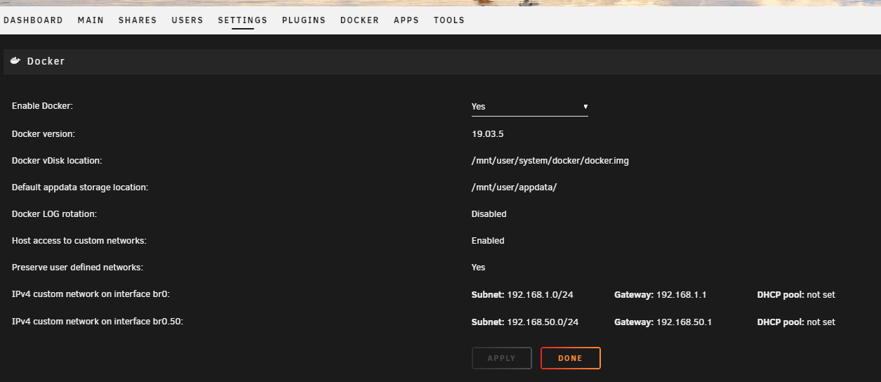

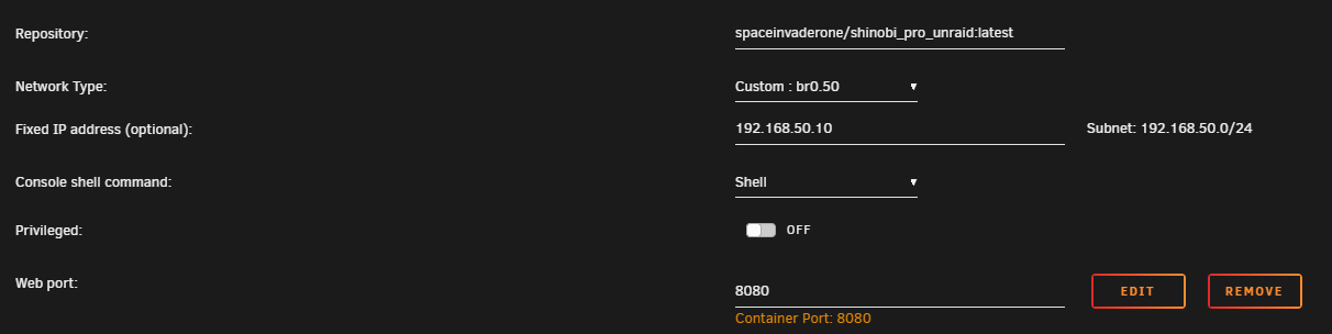

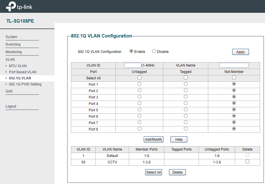

September 1, 20206 yr Hello, I am in need of assistance trying to get all this working with a VLan. I'm trying to follow the videos from @SpaceInvaderOne. Here is my setup: Wireless Router I bought a tp-link TL-SG108PE managed switch. This is how I've set it up: Finally, here are my Unraid settings. Network Docker Finally, my Shinobi docker settings From my Unraid tower, I'm able to ping the Shinobi IP of 192.168.50.10. However, when I try to launch the GUI, it just spins and finally states that it can't reach the page. Prior to trying to set up the managed switch & VLAN, I was able to get to the gui when everything was connected/set-up using the normal network. I know in the videos SpaceInvaderOne did mention that he was going to have another video showing the VLAN setup but I can't find it. Also, I'm not currently using PFSense. I don't know if my current setup (Asus wireless router) supports the VLAN. Any assistance with this would be greatly appreciated. I'm trying to set this up in a secure setup. Thanks
