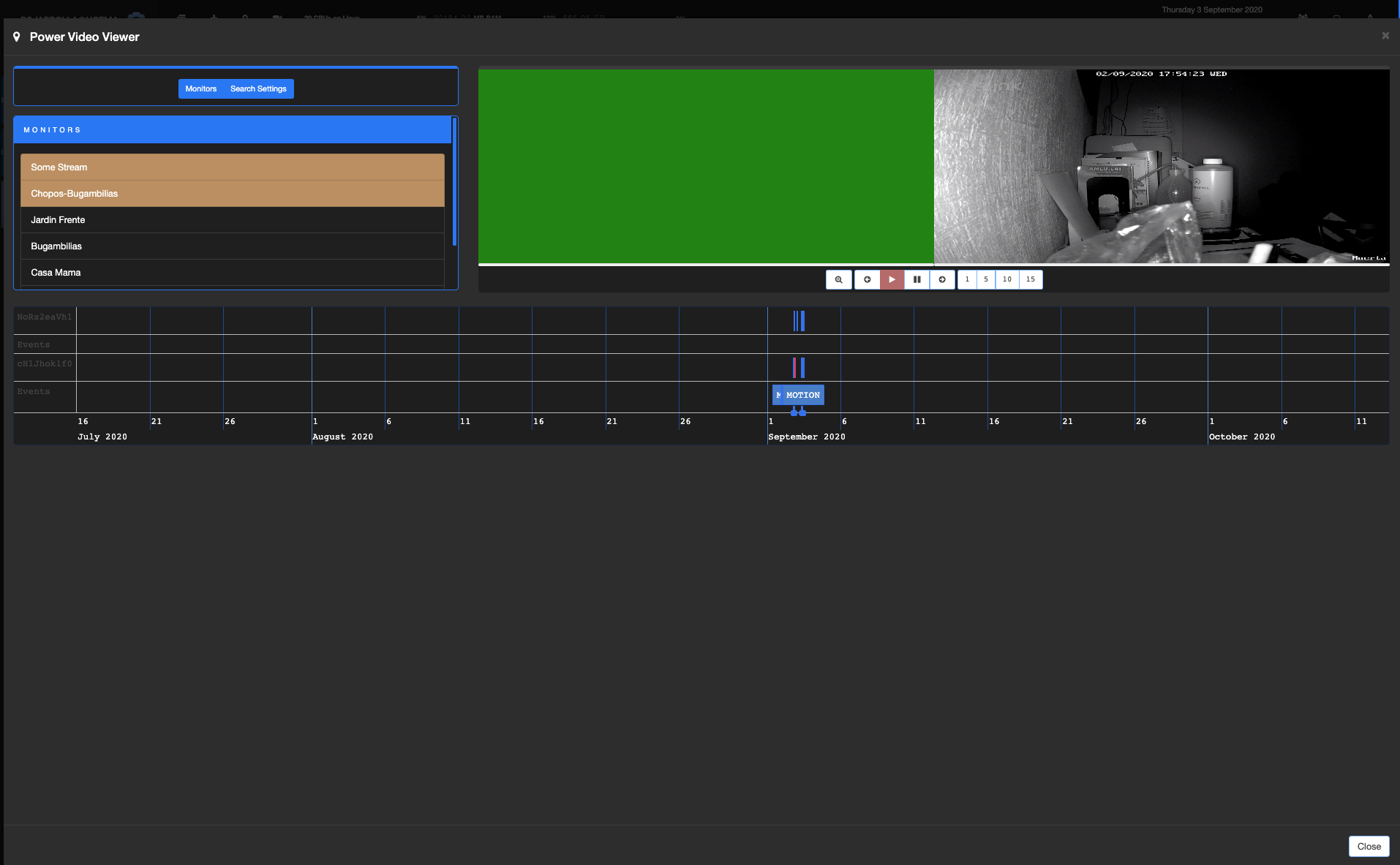

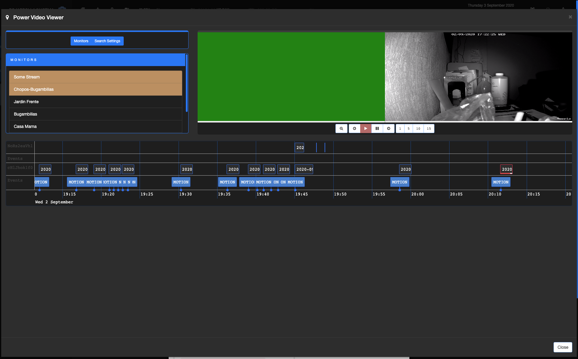

Now posting from my concerns. I will leave the "hardware acceleration" issue aside I ended up upgrading my crappy E5 2403 to an E5 2470 V2 and so far it runs way better.
However, I Still have issues with the playback, and I don't know why I can only see 2 days of videos. The videos are in the hard drive, but the video player does not see them. In the admin settings, they are set to store up to 40 days.
Here are some screenshots you like:
The second issue, as you may have noticed is that one of the "test" cameras only show a green screen in the recording (very useful by the way in a surveillance system).
So, here are my new 2 questions:
1.- Why can't I see more than 2 days in the video player?
2.- Has the green screen occurred to you ? My cameras are Reolink RLC410 and Reolink and RLC410 5 MP.
Thanks in advance for your valuable input.

I had some issues like yours, even I got green screens instead of images, (look for my previous post) I also have reolink cameras.
I don't know if I fixed it, but at least, I don't get green screens anymore, or at least haven't got them and I have turned off my server for two weeks while I was looking for answers at the shinobi forums.
Go to your camera, and in the admin screen look for the advance properties tab, there and look for the option to reset your camera to default settings. I think It will help you with your ghosting.
I hope it helps!
I hope it helps!
Cheers!
