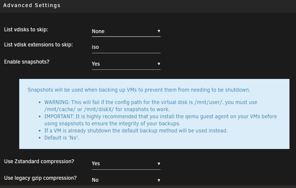

I wouldn't have a clue how to get to that share in terminal. I can do it through my regular windows explorer no problem, and I can get to it via MC by browsing to the disk it physically resides on, but beyond that I'm a bit lost, sorry.
I looked at the logs, and it's weird. The actual log files show that there was an error, but not what it was specifically. I've attached them for your perusal.  If I open the [show log] in the GUI, then it shows mostly the same info, except that I see the actual error I asked about. No idea why they would be different.
Here's a clip of the relevant part of the on-screen log, showing the error and surrounding info...
2021-12-06 02:00:02 information: can_backup_vm flag is y. starting backup of BlueIris Server (W10) configuration, nvram, and vdisk(s).
sending incremental file list
BlueIris Server (W10).xml
sent 6,671 bytes received 35 bytes 13,412.00 bytes/sec
total size is 6,550 speedup is 0.98
2021-12-06 02:00:02 information: copy of BlueIris Server (W10).xml to /mnt/user/Backup/xVM Backups/BlueIris Server (W10)/20211206_0200_BlueIris Server (W10).xml complete.
1f335446-855e-7049-961e-043582ac2630_VARS-pure-efi.fd
sent 131,247 bytes received 35 bytes 262,564.00 bytes/sec
total size is 131,072 speedup is 1.00
2021-12-06 02:00:02 information: copy of /etc/libvirt/qemu/nvram/1f335446-855e-7049-961e-043582ac2630_VARS-pure-efi.fd to /mnt/user/Backup/xVM Backups/BlueIris Server (W10)/20211206_0200_1f335446-855e-7049-961e-043582ac2630_VARS-pure-efi.fd complete.
2021-12-06 02:00:02 information: able to perform snapshot for disk /mnt/cache/domains/Windows 10/vdisk1.img on BlueIris Server (W10). use_snapshots is 1. vm_state is running. vdisk_type is raw
2021-12-06 02:00:02 information: qemu agent found. enabling quiesce on snapshot.
error: internal error: missing storage backend for 'file' storage
2021-12-06 02:00:02 failure: snapshot command failed on vdisk1.snap for BlueIris Server (W10).
2021-12-06 02:00:02 failure: snapshot_fallback is 0. skipping backup for BlueIris Server (W10) to prevent data loss. no cleanup will be performed for this vm.
20211206_0200_unraid-vmbackup_error.log 20211206_0200_unraid-vmbackup.log

I think the issue may be that you have it shutting down your VM and it is NOT shutting down. Notice the 2nd line below in logging. I may be reading the log message incorrectly though.
Did you install the Virtio drivers on the VM? That is the easiest thing to check/do first and may resolve it. I would install that and allow the backup to run without shutting down the VM.
Also- where is your VM image (disk) file stored? See message below-
That's the thing, I don't have it set to shut down. I selected the snapshot option, which should not be trying to shut down.  Before I enabled the snapshot, I tested it the default way (shut down) and it worked fine. I just want it to use snapshots so that it won't take down my camera server while it's doing the backups.
Yes, the VirtIO drives are installed.
Yes, I read the help info, and my vdisk paths are specified as on cache, as noted in the help tip.
The clip you included is from the actual log file. That's what I said is odd, since it doesn't show what the error actually is. Only the on-screen log shows the "internal error" that references the file system thing. I can't figure how or why the logs wouldn't reflect all the info, but here we are. lol

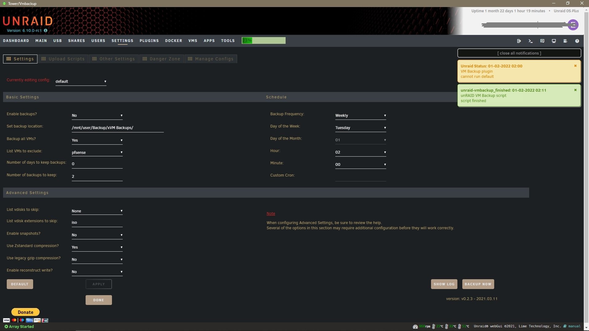

So something is suddenly broken, and I don't know how to go about figuring out what.
VM Backup has been running fine for a while, but in the past couple weeks, I've started getting a pop-up notification on the dashboard:
"Unraid Status: 25-01-2022 02:00
VM Backup plugin
cannot run <myprofilename>"
If I go to the plugin page and try to open the logs, I just get a blank window. It never populates.
If I run the job manually, it works just fine, except that it fails to backup one of my Windows VMs that is currently paused. Is that a known bug?
What gives?

Is there anyway to setup to perform a backup without shutdown the windows? Or a way to properly shutdown it?
Thanks!

I have never used this to shut down my Win10 VM- but I can tell you that snapshots DO in-fact work. I would adjust that setting to 'yes' and see where it gets you.  Maybe try it without compression first so you don't have to deal with that headache.
Edit- also, did you install VirtIO drivers on the VM itself?

45 minutes ago, Elmojo said:
How do you use the plugin, if it doesn't shut down and restart running VMs?
If you set 'enable snapshots' to yes it will backup your VM after powering down and restore it back to the original state once completed. See the 'danger zone' tab of the plugin, you can see additional options including the 'restore to original state' and other shutdown/restart selections.  The problems I have had with it doing the shutdown during backup were resolved by updating the VirtIO drivers. Also, you should find a logging file included in the destination directory even if it fails. Maybe post that so people can review.

Good news/odd news? lol
Good news: my backups completed successfully last night, as expected.
Odd news: it reported the error "cannot run default"
Umm...okay? Default is disabled, it's not supposed to run. Why am I getting this message now? I don't recall ever seeing it previously.
Otherwise, the plugin seems to be running fine. No errors in the log. :)
