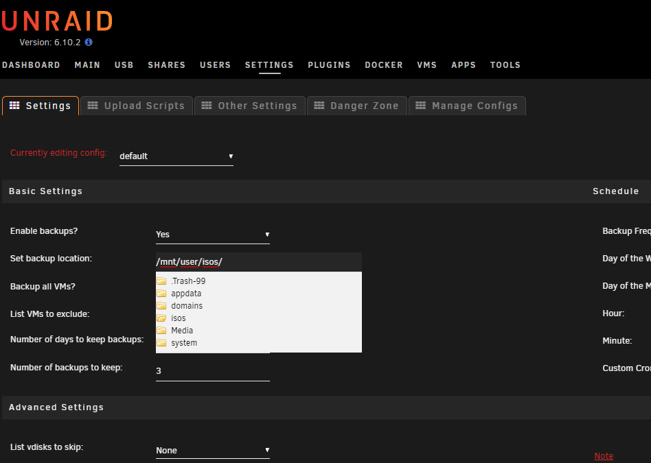

My config menu it doesn´t show Unassigned Devices... I would like to safe the backups to a external drive.
Any one can help me please?
Thanks
Thanks
image.png.30e0b7eefb5d2268b06b995755b13917.pngimage.png.bad2e49618adc42df720bca1d8b905ed.png
I pasted/write the UD Path manually. I have the same Issue. Only Local/Array Path are showed.
Just manually add the share folder to your external disk. /mnt/disks/external_ssd (in my case!)

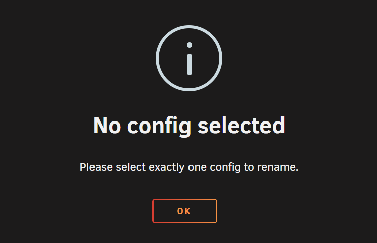

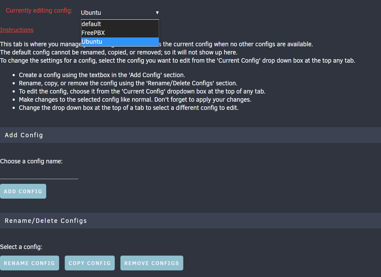

A really great plugin to backup VM. Used with restore script and all is working perfectly! That's great!
I have just one small problem.
In Manage Configs section, i can add a new config but i cannot copy/rename/delete because no configs are showed (see attached image). I think there is something wrong with this function
$("#select_configs_div").fileTree()
Inside file
/usr/local/emhttp/plugins/vmbackup/include/javascript/vmbackup.js
Of course i could be wrong about that function and that file.
Tested with Chrome, Firefox and Edge. No select appears and so i cannot copy/rename/delete.
Any suggestions?

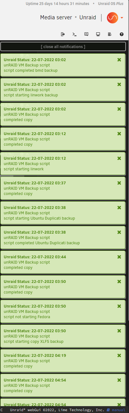

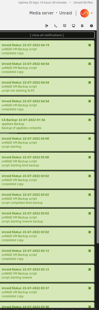

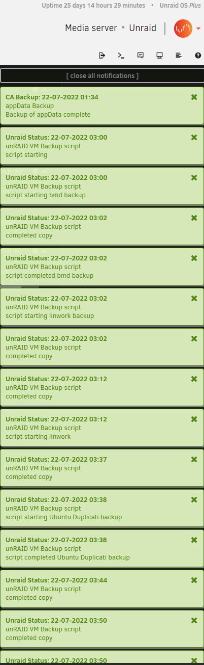

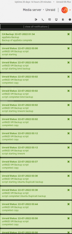

VM Backup often running v0.2.3 - 2021.03.11
Seems to me like the VM Backup is running multiple times in the backup queue. I think this started before upgrading to UR 6.10.3.
Before it took about 45-60 minutes zu backup the few VMs, now it is doing so multiple times taking, maybe 4,5 hours.
now I remember: before updating unraid I tried to initiate a manual backup and that didn't start, then, over a couple of minutes I hit the backup button multiple times and that seems to have gone into the scheduled behaviour.
where might I see where those (redundand?) backup tasks are stored, since this behaviour endures an unraid restart.
p.s. as last user postet: Great Job - I've been using your script for a while and it save me a lot of time. Thanks for that!
