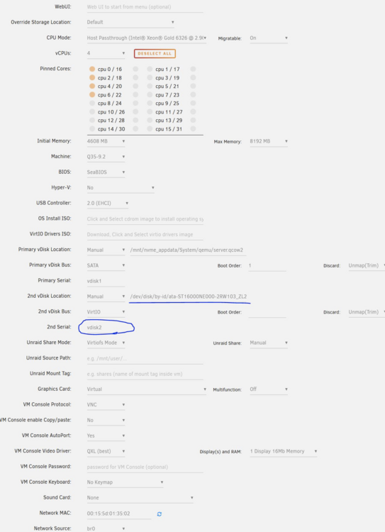

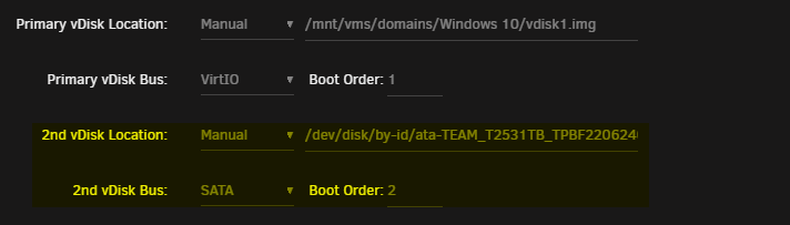

No, just exclude one of the disks. I'm passing through a 1TB drive and I believe that drive is causing the snapshot to fail. I don't want to backup the 1TB drive either, just the main virtual disk.

Pretty sure that's not possible with this plugin, it only expects vdisks...
Does it actually fail or just skips this disk? I have a VM where I have only a passed through drive and it complains with an error that there's no vdisk but still backs up the xml.
I'm not sure on that one. Looks like it's saving an .fd and .xml file. Just not the vdisk. Here's the part of the long for that VM. Not sure if that's helpful at all.

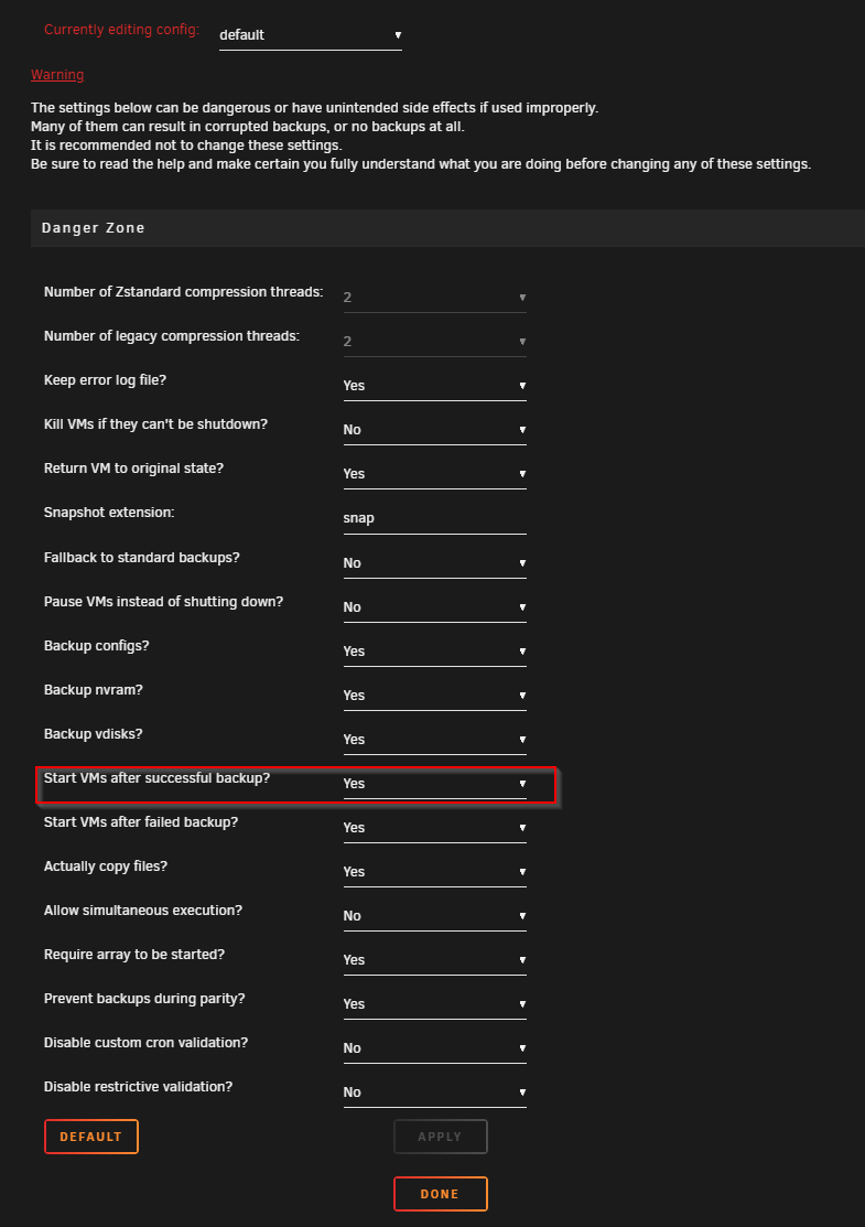

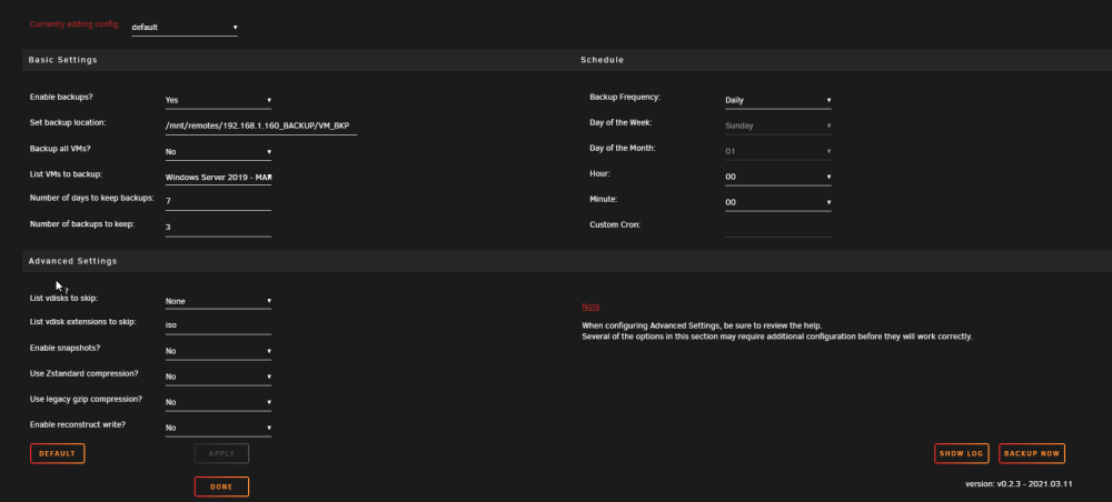

Anyone knows why the VM doesn't start back after backup?
v0.2.3 - 2021/03/11
So, the backup runs as planned, finishes but the VM does not start again - I have to do it manually.
At first it wasn't working for couple of days then it started working by its own (the VM started after backup) then I had to backup another VM so I just selected that one, finished the backup then reverted backing up only this one - after that it stopped starting after backup.
Any ideas?
Here are the configurations:
v0.2.3 - 2021/03/11
Any ideas?
I'm having the same issue. Started happening last saturday 26.11.

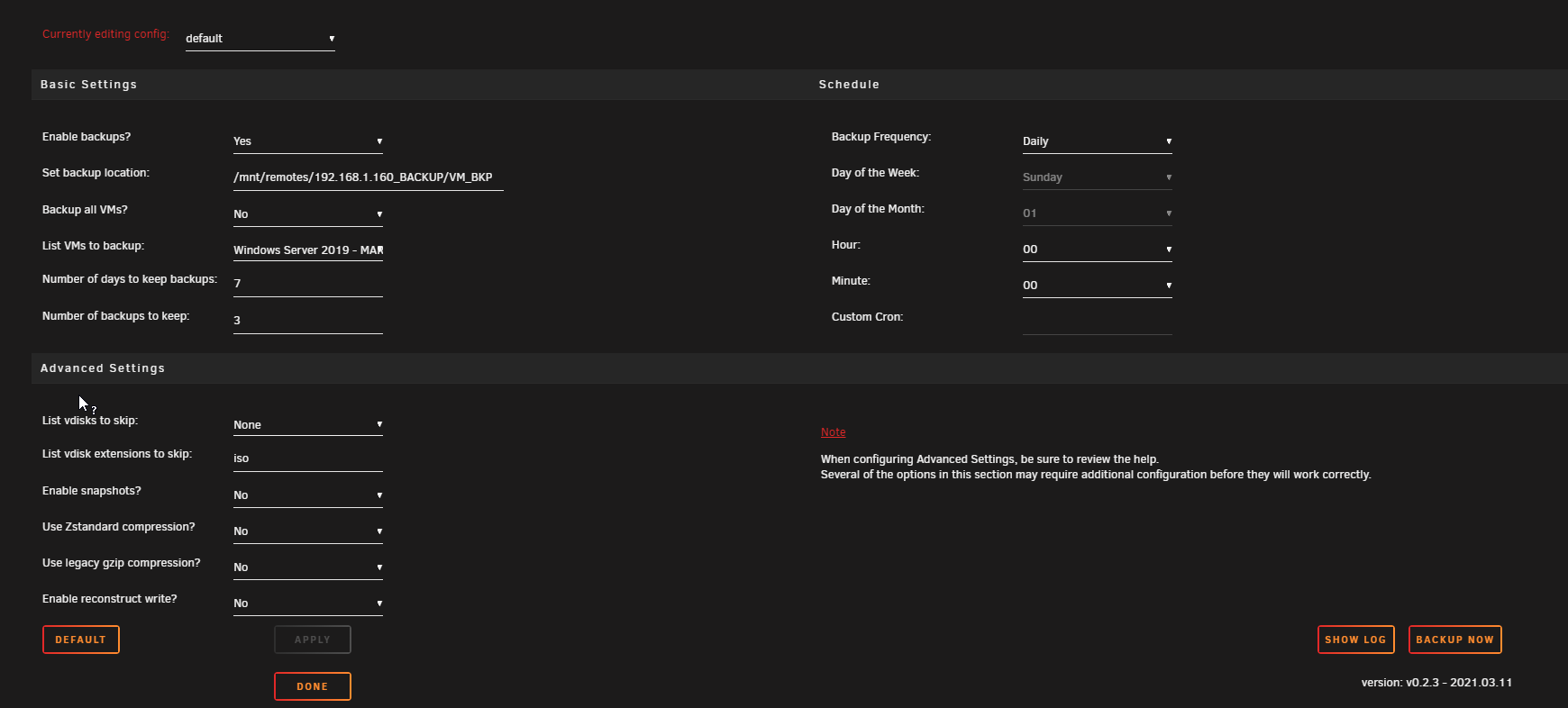

So I thought I had this worked out, but I guess not....
Mine was running fine until recently, where it's stopped backing up automatically. If I run the backup manually, it works fine. All VMs stop, backup, and restart as expected.  However, if the job runs as scheduled, it fails and I get a notification on the dashboard that the backup failed to run, but it doesn't say why.  l've tried looking at the logs, but they are set to clear after 1, and I had already run a manual backup, so I have to wait until it fails again, which I believe will be tomorrow.
Any idea what would cause a failure when scheduled, but work fine when run manually?

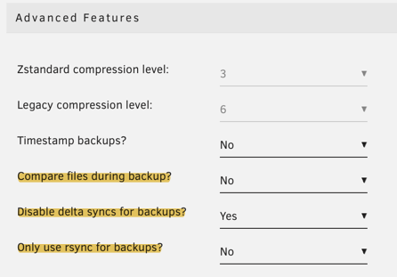

On 8/23/2022 at 6:10 AM, IronBeardKnight said:
I have discovered what I think may be a bug with this plugin.
I'm sure this one could be a simple fix but its possible I might be missing something.
Using 2 for this field allows the plugin to work as expected.
for some reason I cannot select 1 backup for the amount of copies as I only want one backup and then I use other tools to ship a copy encrypted offsite.
Please see below how it turns read then will not allow you apply 1 even thought the vm only has 1 vdisk.
I have this problem as well. I ended up editing the number_of_backups_to_keep var in the user-script.sh script directly.
You cannot proceed and press apply when its red.

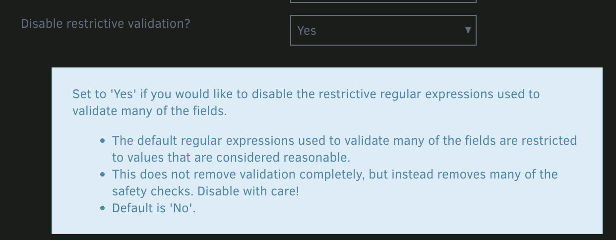

@ncohafmuta and @IronBeardKnight you can bypass pretty much every safety check that won't actually break the script in the Danger Zone tab.
Scroll all the way to the bottom and look for Disable restrictive validation and set it to Yes, after that you can set Number of backups to keep to 1 without the script complaining (screenshots attached).
I am intending to update the help to note which fields can be deactivated and where to do that in a future update, but for now hopefully this helps.
fwiw, the plugin is very customizable and I didn't want to prevent anyone from doing something just because I considered it non-standard (this is one of my biggest pet-peeves with software!). Because of that, I made sure to include options to disable anything that wasn't explicitly breaking. The only reason it doesn't let you do it out of the box is because it is too easy for someone who just wants an easy-to-use backup plugin to make a mistake that doesn't protect them or causes data issues.
I highly recommend reading through the help for the more advanced options if you ever run into something like this again... or even just for good measure - there may be other useful things in there you want to use!
Edited by JTok
thank you very much. i'll try this out

On 12/20/2021 at 4:21 AM, dja said:
HOW TO RESTORE!!!!
Option 1- Script:
Use the great script from @petchav, many thanks! See the video below for a guide on how to use this.
Option 2- Manual restore:
You will need:
1.  Your backup .img file (after extraction)
2.  Backed up XML file
3.  Your backed up .fd file
Step 1- In terminal, extract img file from .zst backup. Example below. Replace with your .zst file name.
zstd -d -C --no-check 20211114_0300_vdisk1.img.zst
You will likely get the error below IF you run the command above without --no-check
 Decoding error (36) : Restored data doesn't match checksum
*Note, -no-check option MAY NOT be supported by Unraid.  If this doesn't work in terminal, try Cygwin (Windows) and run it. https://www.cygwin.com. Place your .zst file in the c:\Cygwin folder.  With Windows you can now also install a Linux environment as well. (Beyond scope of this guide!) Copy the backup to the local machine or it will take forever!
ALSO- you can backup WITHOUT compression and save yourself some grief!!! (See options)
Step 2- Place .img file back into directory where it was backed up from. Look in the backed up XML file for the following line and ensure that YOUR path AND files exist:
Step 3- Place backed up .fd file to: (file name may vary)
/etc/libvirt/qemu/nvram/4a2b120f-0ea9-846a-6e11-f097002e442d_VARS-pure-efi.fd
You may need to remove the 14 character timestamp at the start of the filename!!
For example, remove 20211205_0300_
20211205_0300_4a2b120f-0ea9-846a-6e11-f097002e442d_VARS-pure-efi.fd
Step 5- verify ALL files are where they were BEFORE the backup.  Look at XML file for file locations.
Step 6- Open  your .xml file. Copy the contents. Don't mess with it!
Step 7- Create a new VM in Unraid.  When asked, it does NOT matter what type, (Win11, 10 etcetera..) just pick one. Once you do that and BEFORE hitting "Create", you will have the VM options page. Select the "Form View" button at top right of screen. Change to  XML view. Select all contents and delete. Paste contents of backed up XML in. Select create and away you go!
Came across the VM backup plugin, doing tests with it n so far me likes it. As for restoration I'd rather go the second option-it's far less technical than the script way. I feel the script is better for batch restores.

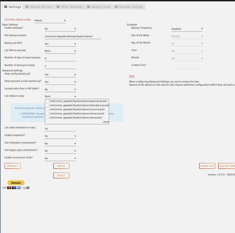

There doesn't seem to be anyway to disable this plugin other than perhaps removing it. I have tried setting backup frequency to "Disabled" and also setting enabled to "No".
1529259675_Screenshot2023-01-23at8_28_34PM.thumb.png.76f468f140bd44d951375b324a362593.png
If I apply the setting and then return to the settings menu later they are reset to "weekly" and "Yes".
755394671_Screenshot2023-01-23at8_29_05PM.thumb.png.1a1a6efb39231cf336db0ed041626c53.png
Am I missing something?
I ran into a similar issue eventually re-installing it.  However- I believe you can set 'back up all VMs' to 'no' and make sure no VMs are selected.
Thanks. I wound up just deleting the plugin since I don’t currently have any VMs installed anyway. I really think that setting enabled to “No” should have disabled the plugin though.

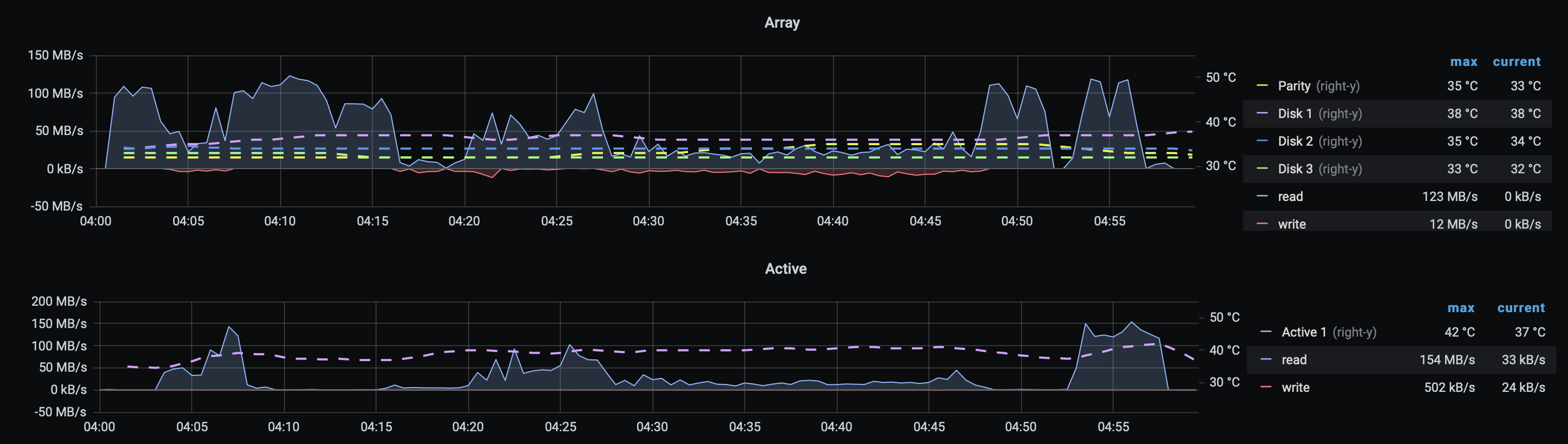

At some point in the last couple/few months my backups started taking longer e.g. it takes about 40 minutes to copy this 50GB disk image:
1642109712_Screenshot2023-01-30at11_59_08AM.thumb.png.c31721b73f358b190318c70b9dabadeb.png
I remember fixing this a year or two ago by disabling rsync to the extent possible.
It's still disabled:
But the log entry above and grafana, which shows mostly reads on both the source (as expected) AND destination (Active -> Array) during the backup period, suggests it's using rsync.
156079559_Screenshot2023-01-30at12_16_05PM.thumb.png.44967b6d3660f4582c00931e1daac4fe.png
Any ideas? I have reconstruct write enabled but even if reporting tracks that as reads I doubt the above shows a copy operation. 12MB/s write is well below my array's capacity.
Edited by CS01-HS
