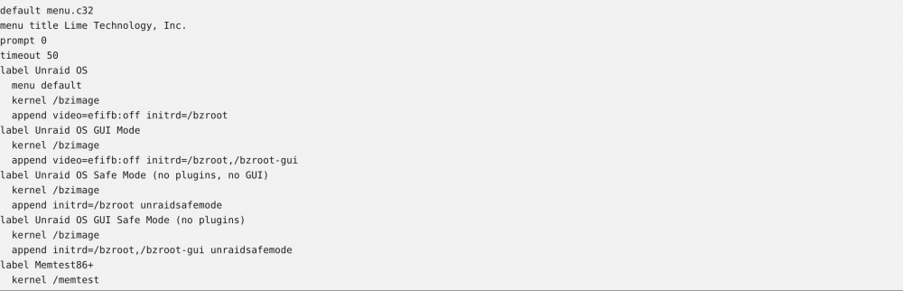

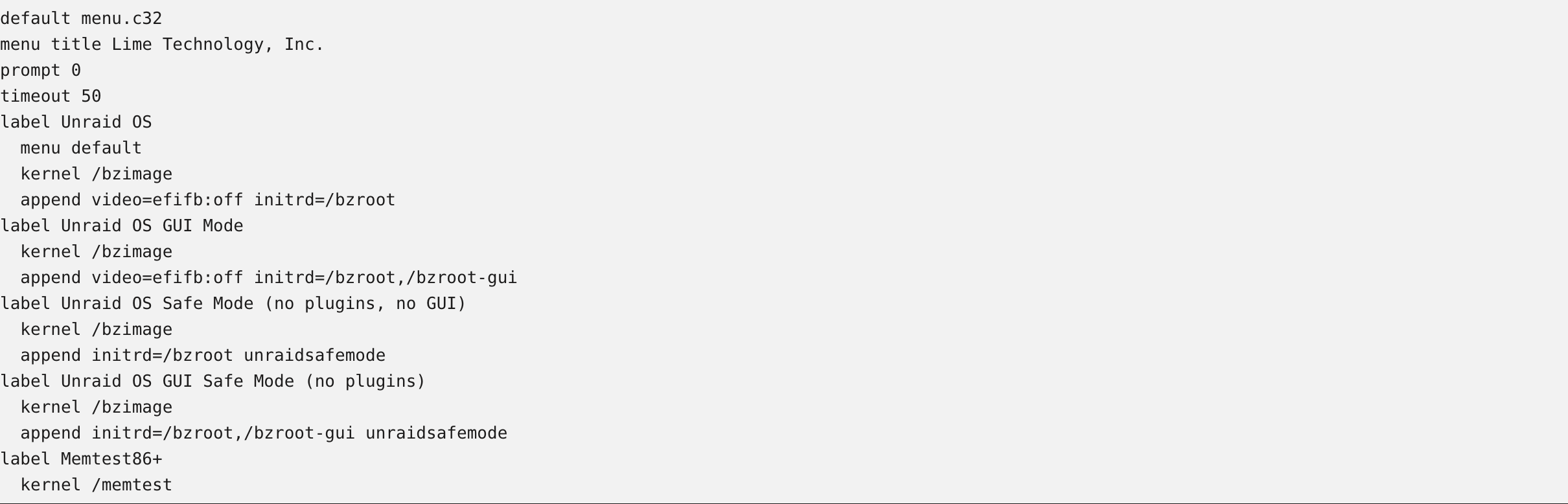

Passing kernel parameters is something I have a hard time finding examples/instructions for, so I'm not sure I'm doing it right...
With this I no longer get the Linux install log and prompt on non-GUI Mode or the single blinking dash on GUI Mode, it just freezes after Loading /bzroot(-gui)...ok
Still perfectly accessible through WebGUI. Again, is this expected behavior due to only having one GPU?

No installer, straight to UEFI Shell. The reason I'm reluctant to run with SeaBIOS, which does give me an installer and does seems to work fine otherwise, is because OVMF worked for Windows at first. I've tried starting from scratch on a new vDisk numerous times and assure you I can't create a new stable baseline as things stand, not with OVMF.
That's why I'm just about ready to throw in the towel and stick with SeaBIOS for Windows. Because I don't think I'd lose much, if anything, besides forwards compatibility to a UEFI-based config.

Did you ever get this working? I have the same issue, I have a Win 10 install running on an NVMe passed through to the VM. With VNC it works fine, with my Radeon RX570 passed through I just get a UEFI shell. My unraid is running in UEFI mode.
