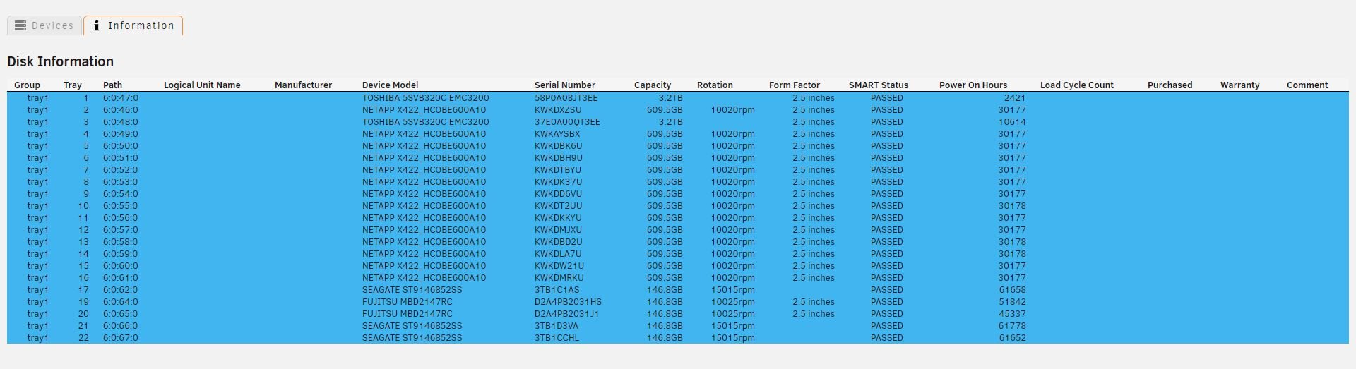

I have managed to install UnRaid on dell R510 and can see and use all 12 disks that are in the drive bays.  I have also attached a 24bay Netapp disk shelf which is connected with a Netapp 10GB HBA.  Unraid picks up the Netapp HBA and seems to be able to see all the disks in the disk tray,  However I can't seem to be able to add the disks to a new array.  See below:
Disk Information
GroupTrayPathLogical Unit NameManufacturerDevice ModelSerial NumberCapacityRotationForm FactorSMART StatusPower On HoursLoad Cycle CountPurchasedWarrantyComment
tray116:0:47:0TOSHIBA 5SVB320C EMC320058P0A08JT3EE3.2TB2.5 inchesPASSED2421
tray126:0:46:0NETAPP X422_HCOBE600A10KWKDXZSU609.5GB10020rpm2.5 inchesPASSED30177
tray136:0:48:0TOSHIBA 5SVB320C EMC320037E0A00QT3EE3.2TB2.5 inchesPASSED10614
tray146:0:49:0NETAPP X422_HCOBE600A10KWKAYSBX609.5GB10020rpm2.5 inchesPASSED30177
tray156:0:50:0NETAPP X422_HCOBE600A10KWKDBK6U609.5GB10020rpm2.5 inchesPASSED30177
tray166:0:51:0NETAPP X422_HCOBE600A10KWKDBH9U609.5GB10020rpm2.5 inchesPASSED30177
tray176:0:52:0NETAPP X422_HCOBE600A10KWKDTBYU609.5GB10020rpm2.5 inchesPASSED30177
tray186:0:53:0NETAPP X422_HCOBE600A10KWKDK37U609.5GB10020rpm2.5 inchesPASSED30177
tray196:0:54:0NETAPP X422_HCOBE600A10KWKDD6VU609.5GB10020rpm2.5 inchesPASSED30177
tray1106:0:55:0NETAPP X422_HCOBE600A10KWKDT2UU609.5GB10020rpm2.5 inchesPASSED30178
tray1116:0:56:0NETAPP X422_HCOBE600A10KWKDKKYU609.5GB10020rpm2.5 inchesPASSED30177
tray1126:0:57:0NETAPP X422_HCOBE600A10KWKDMJXU609.5GB10020rpm2.5 inchesPASSED30177
tray1136:0:58:0NETAPP X422_HCOBE600A10KWKDBD2U609.5GB10020rpm2.5 inchesPASSED30178
tray1146:0:59:0NETAPP X422_HCOBE600A10KWKDLA7U609.5GB10020rpm2.5 inchesPASSED30178
tray1156:0:60:0NETAPP X422_HCOBE600A10KWKDW21U609.5GB10020rpm2.5 inchesPASSED30177
tray1166:0:61:0NETAPP X422_HCOBE600A10KWKDMRKU609.5GB10020rpm2.5 inchesPASSED30177
tray1176:0:62:0SEAGATE ST9146852SS3TB1C1AS146.8GB15015rpmPASSED61658
tray1196:0:64:0FUJITSU MBD2147RCD2A4PB2031HS146.8GB10025rpm2.5 inchesPASSED51842
tray1206:0:65:0FUJITSU MBD2147RCD2A4PB2031J1146.8GB10025rpm2.5 inchesPASSED45337
tray1216:0:66:0SEAGATE ST9146852SS3TB1D3VA146.8GB15015rpmPASSED61778
tray1226:0:67:0SEAGATE ST9146852SS3TB1CCHL146.8GB15015rpmPASSED61652
Has anyone been able to attach a Netapp disk tray and then be able assign the disk to the array so you can use the storage.
