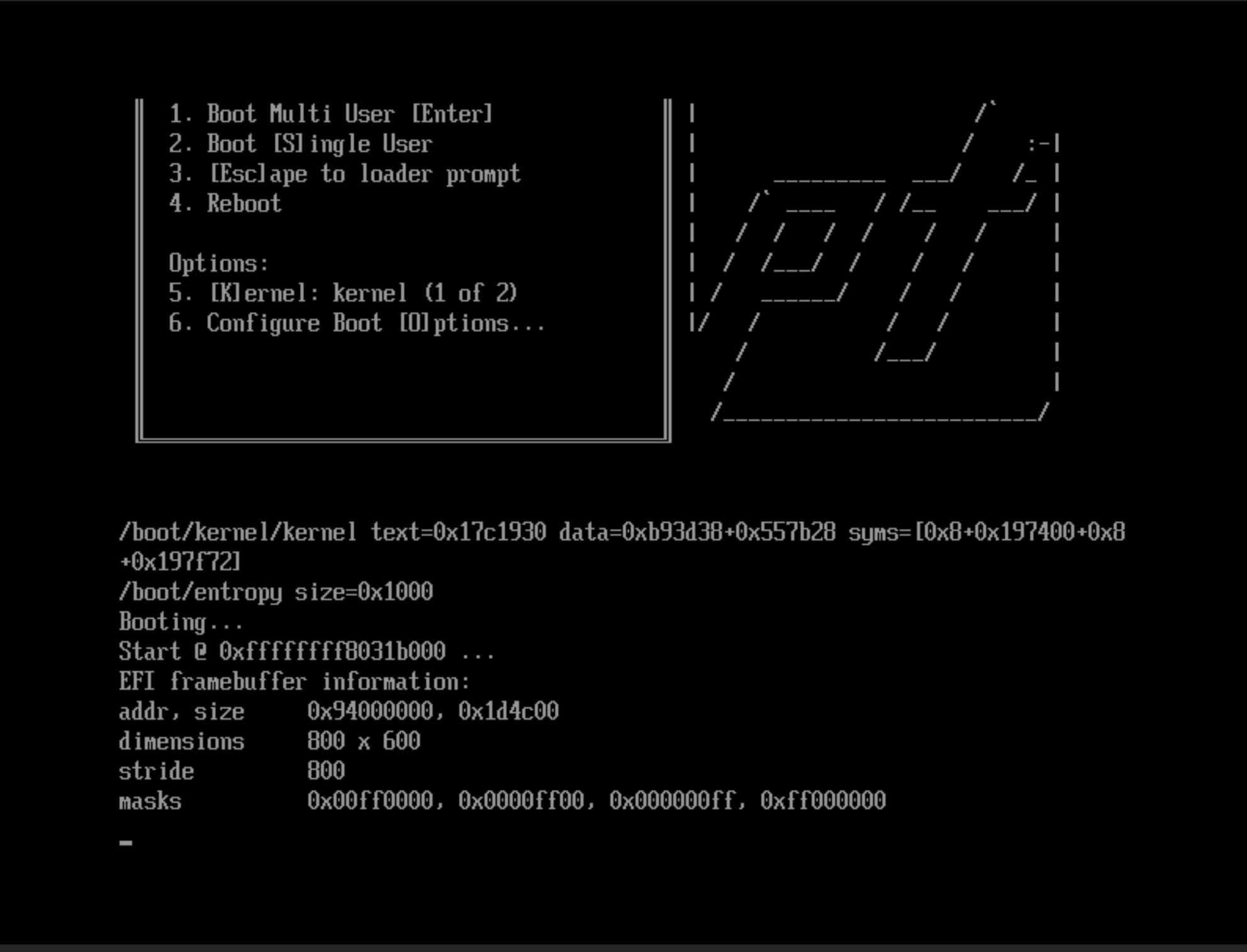

I took that line out.  Here are the Unraid 6.8 diagnostics.  pfsense is still not booting up in 6.8.  I've shared a screenshot on where it is stuck.  Regarding using my backup pfsense box, it seems to be the culprit to accessing docker containers through letsencrypt.  I don't know why as the configs are the same.  I guess I'll post in the netgate forum.
diagnostics.zip
This thread has the fix for pfsense vm booting,
