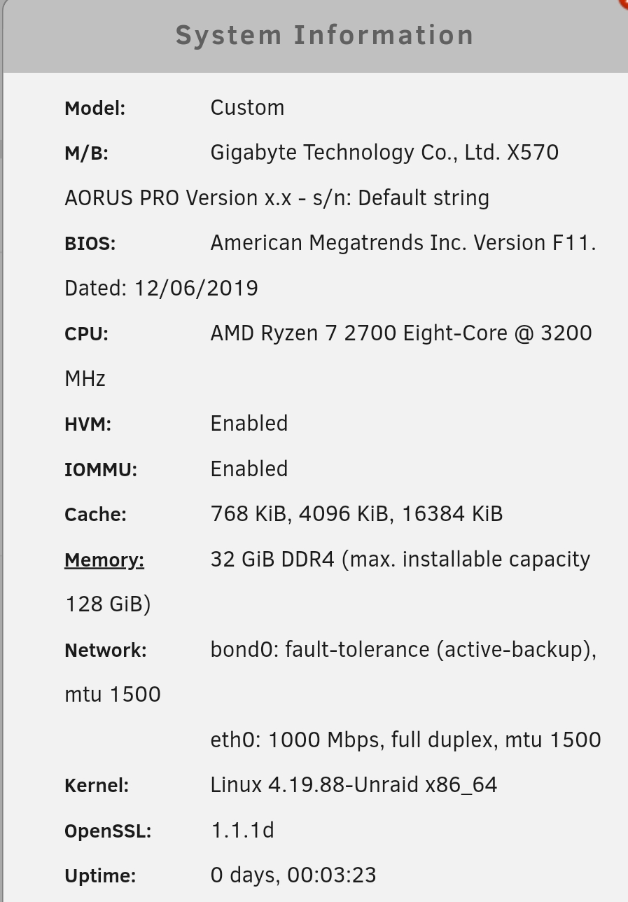

My hardware:
CPU: AMD Ryzen 7 2700 Eight-Core 3.20 GHz
RAM: 32GB DDR4 3600-16 Trident Z Neo
Motherboard: X570 AORUS PRO
Hard disk: Samsung 970 EVO NVMe M.2 1TB
Graphics card1: NVIDIA NVS 300 1GB
Graphics card2: Radeon RX 570 4GB
Of course I own two graphics cards, because Unraid claims one only for itself. I want someone who doesn't know anything about the VM to not notice that my Windows is running on a VM. This means using Array Autostart, VM Autostart, On Board Sound Card and of course the automatic detection of USB devices.

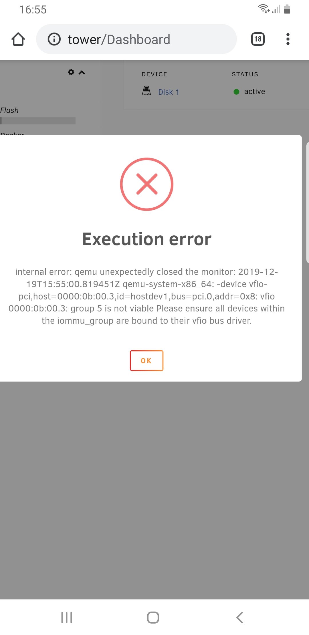

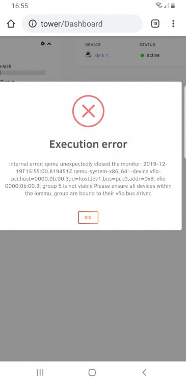

Now I have already encountered two problems during the first test. With the sound card I was shown the following: See picture at the end.
The second problem is the graphics card:  After I installed Windows 10 and Windows tries to install the graphics card driver the picture freezes and the ram goes to maximum load + one core goes to 100%. This happens even when I manually try to install the graphics card drivers. I've read about this problem with some others as well. But if there is now a real solution I have not found out yet.
The VMs are not usable after they get into this freezing mode and you can delete them.

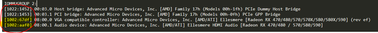

Here's one of your problems, the GPU is not isolated in its own IOMMU group;

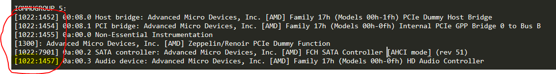

And here, your on-board audio is also not isolated, and will not pass through;
If you can solve those issues, you'll be well on your way.

That looks much better. Your GPU is in its own group, so should pass through for you now.
The onboard audio looks good, but you'll need to block it from loading on system boot.
Check out this thread for details;

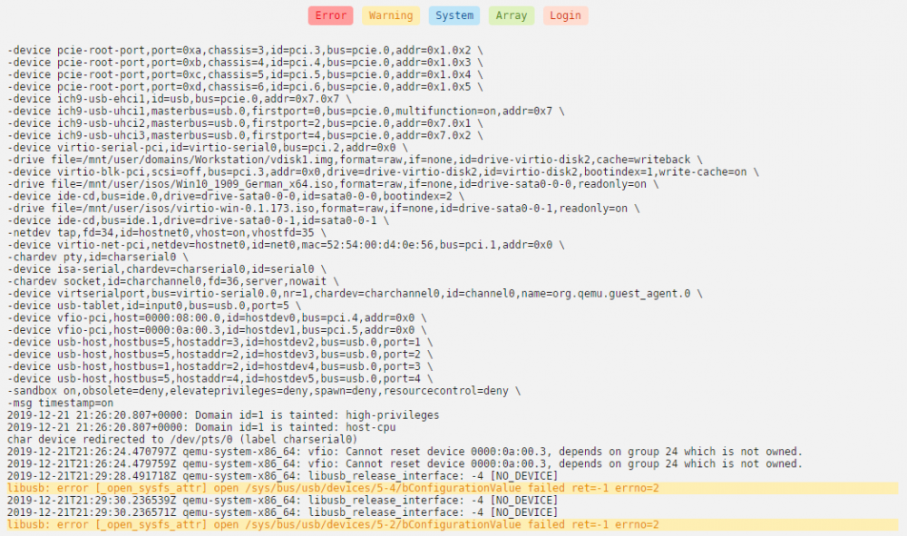

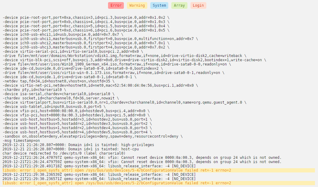

I have now tried to run unraid with only 1 graphics card. For this I have edited in the syslinx.cfg
append initrd=/bzroot
to
append initrd=/bzroot video=efifb:off
This should make it possible to use a VM assigned to the graphics card with a screen in a normal way. I made a VM in autostart and you can see that when Unraid is loaded. Something happens but then I have only a black desktop.
I also added acpi_enforce_resources=lax to the config to see how fast my fans run. For this I also edited the /boot/config/go file. Extended with this line.
modprobe it87 force_id=0x8628
To be able to use my USB slots later normally, I created a new file /boot/config/vfio-pci.cfg
There then the Ids from the IOMMU group from my USB controller integrated.
BIND=05:00.0 05:00.1 05:00.3

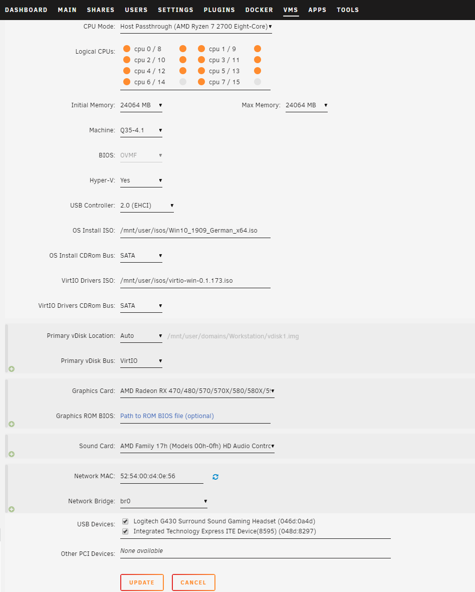

So now I have all changes here. Maybe someone knows if I made a mistake or if something is not working together.

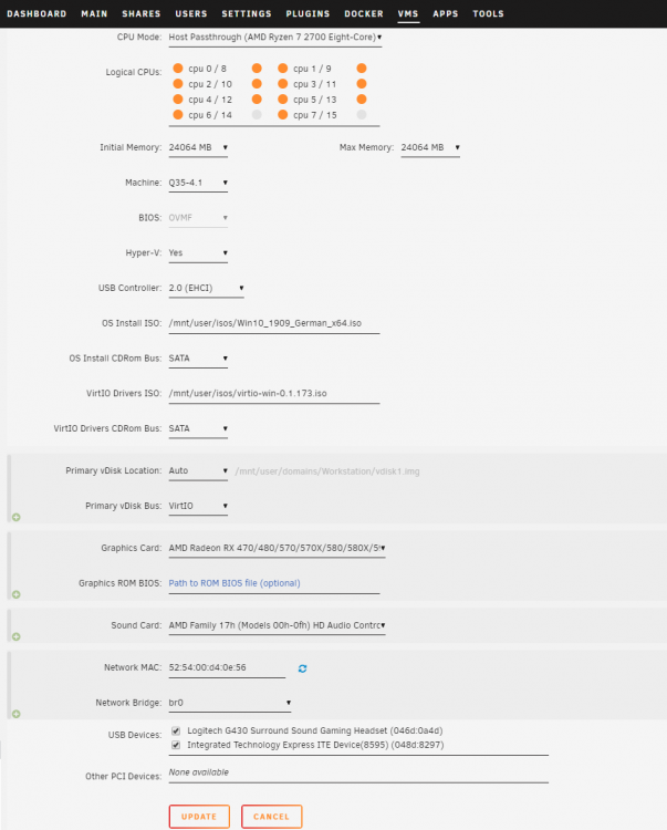

VM Settings:
VM Logs:
System  Logs:
