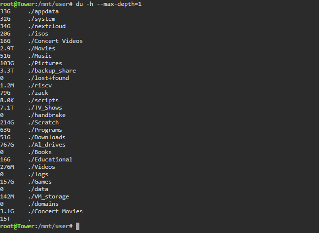

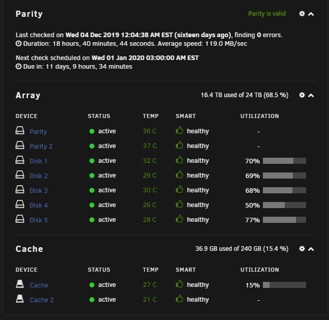

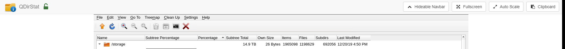

I was using QDirStat to help prune some data off of my server and I noticed that the total size of /mnt/user was 14.9TB. This does not match the 16.4TB that the unRAID dashboard is reporting. I checked these results in the terminal by using 'du -h --max-depth=1' in /mnt/user and it returned 15TB (within margin of error of the 14.9TB reported by QDirStat). This is on versions 6.7.2 and 6.8.0. Has anyone else seen this?
Is du / QdirStat using TiB vs TB (which the dashboard uses)?
That is the issue. I was doing the TB to TiB math wrong. That's what was confusing me.
