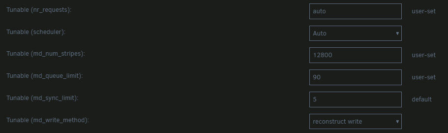

If Unraid without tuning disk parameters setting then it perform quite slow, but you also need understand Unraid array pool not use RAID, so array pool performance often lose if compare to other solutions.
You need do more research on how to make Unraid give you magic ( also the limitation ). I also a QNAP fans before but no more for longtime.

It was mentioned tweaking settings, any suggestion on tweaks I can make to help things? Again, I'm new to the OS and really happy with it. I just want to be able to pull all the performance I can out of my configuration. So just trying to learn what to do better. I looked at https://wiki.unraid.net/Improving_unRAID_Performance but appears to be dated and the tweaks mentioned either did not apply or make much of difference.
The biggest boost in writing to the array is Turbo (reconstruct) write. See this thread for an explanation of the 2 different methods for updating parity and their tradeoffs:
https://forums.unraid.net/topic/50397-turbo-write/
There is a plugin that enhances this somewhat by automating that setting. Search the Apps page for turbo.
And, you should make sure your dockers and VMS are running on SSD cache instead of the array. You do this by making sure that appdata, domains, and system shares are all on cache with nothing on the array, and configured to stay on cache (cache-prefer or only). You can see which disks each user share is using by going to User Shares and clicking Compute... for the share. What commonly happens is people will enable dockers and VMs before actually installing cache, so they get created on the array and get stuck there because open files can't be moved.

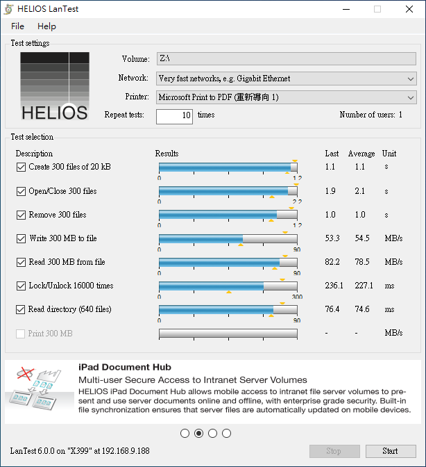

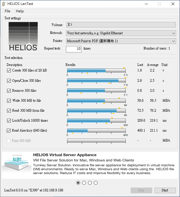

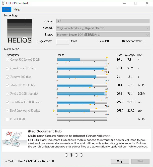

I haven't note ( not browse the URL ) you are talking about random access performance, in fact, I seldom focus on this area.
HELIOS seems a good tools, so may be a time to got some test about random access. Below are result FYR. ( all test not SSD )
You also may ref. tweak as below

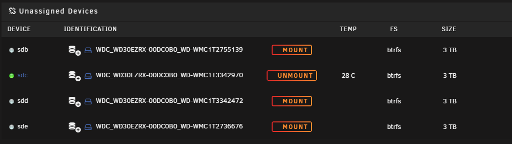

TS-851, Unraid with two 3TB disks mount by UD in RAID0
TS-251+, QTS4.4 with two 6TB disk in RAID1
DIY Unraid build and test a 8TB disk in array pool.
Edited by Benson
