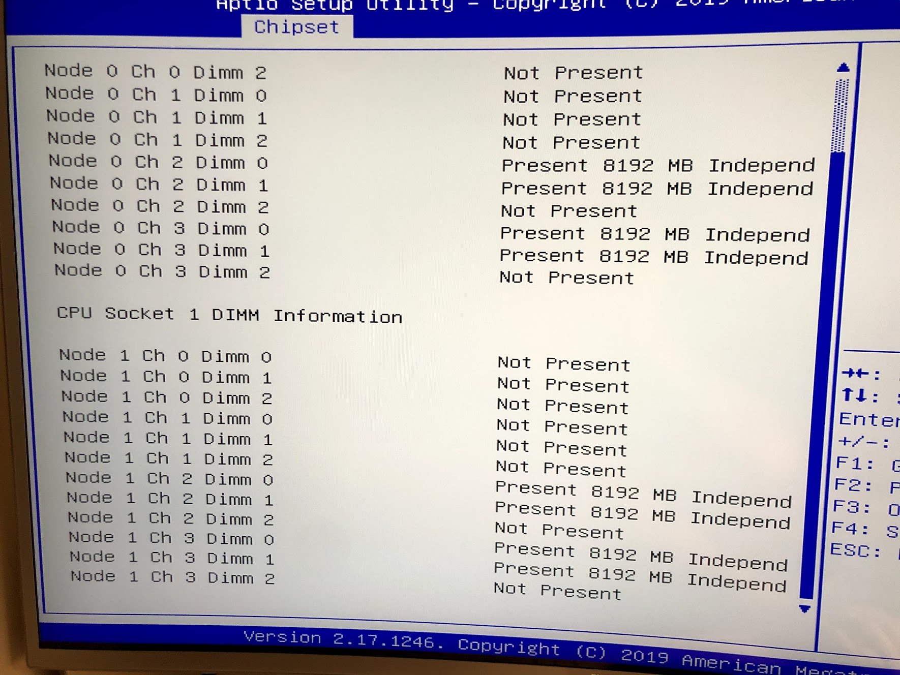

I have installed unRAID on a server based on a chinese motherboard form huananzhi (x79 8d) with two xeon e5 2670 CPU:s and 64GB of ECC DDR3 memory. I really like the simplicity of unRAID so far and I am running several fun apps 😃

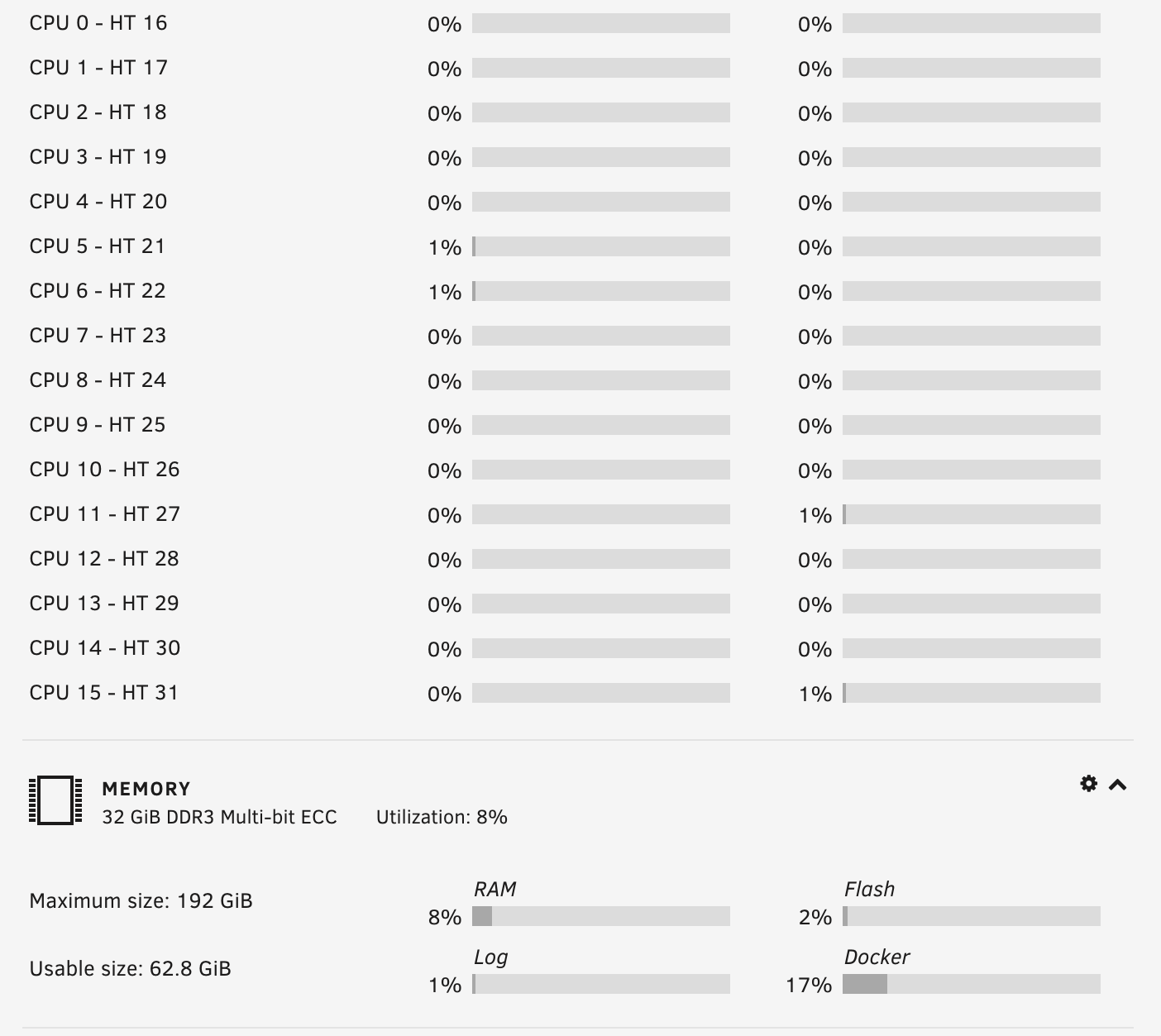

Now to my problem. The system information page and "dashboard" only shows 32GB of RAM, even though I see all 64GB in BIOS and when I execute "top" and "free" commands in the console. I can also allocate up to 64GB of RAM when creating a VM.

See the attached images for dashboard and BIOS.
I think that the BIOS in my huananzhi motherboard is a bit strange. It looks like it shows a lot more DIMM slots than are actually physically on the board (8 slots). See attached image. Perhaps this is the reason that unRAID does not include all RAM in the system information? This is not a huge issue, but a bit annoying to me as a perfectionist 😃
Also the system information only shows one CPU even though there are two of them, the dashboard shows all 16 threads / 32 cores accurately however.
Is there a way to make unraid detect all my RAM in the system information?
Unraid relies on what your BIOS is reporting.
Ok, so why is not all RAM detected then? My BIOS reports 64GB.

/Erik
Are you able to resolve the issue, for me its showing only 16Gb, Where as actual installed ram in 64 GB.
Bios shows 64 GB Ram installed. But Unraid is shoiwing 16GB Only
Hi!
i have not resolved the issue unfortunately. Any suggestions would be much appreciated.
I am thinking of switching to a supermicro motherboard instead but it is a lot of work and some money as well so I am hesitant.
