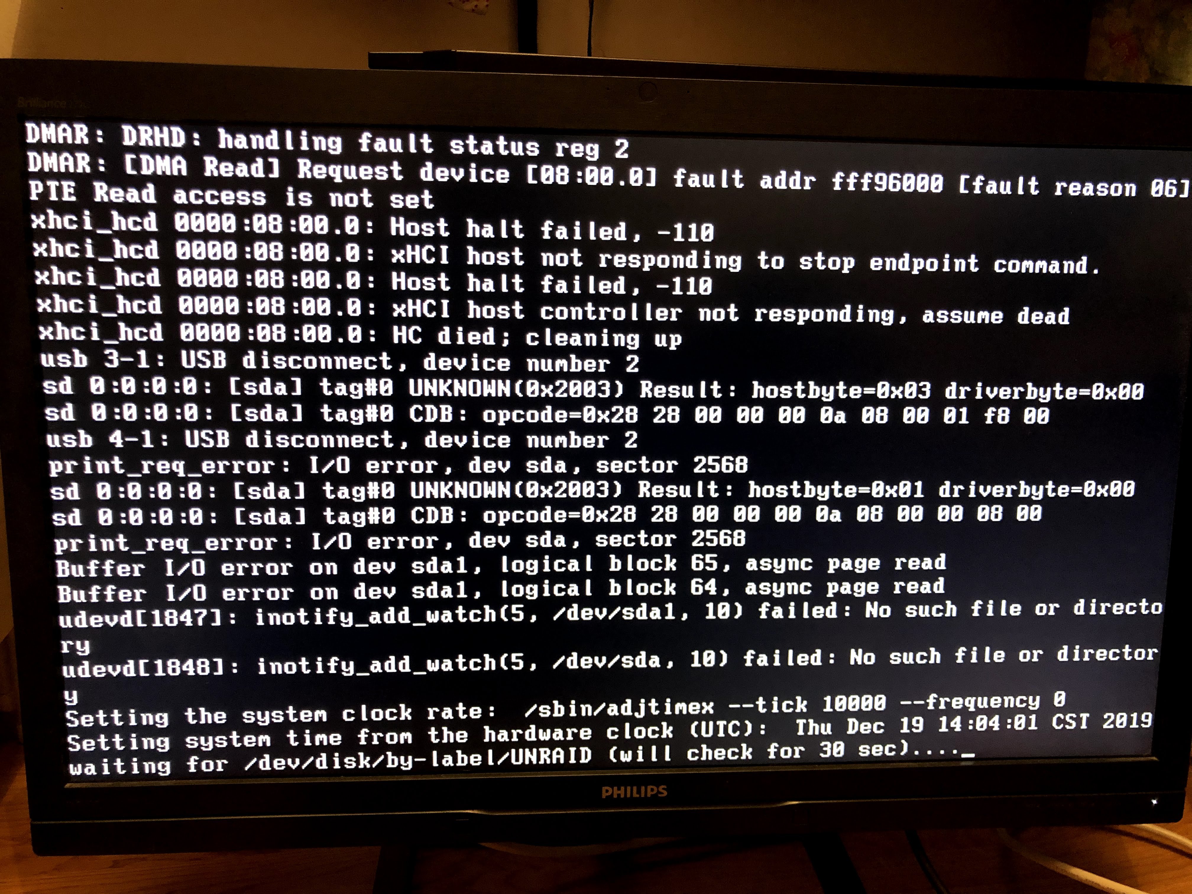

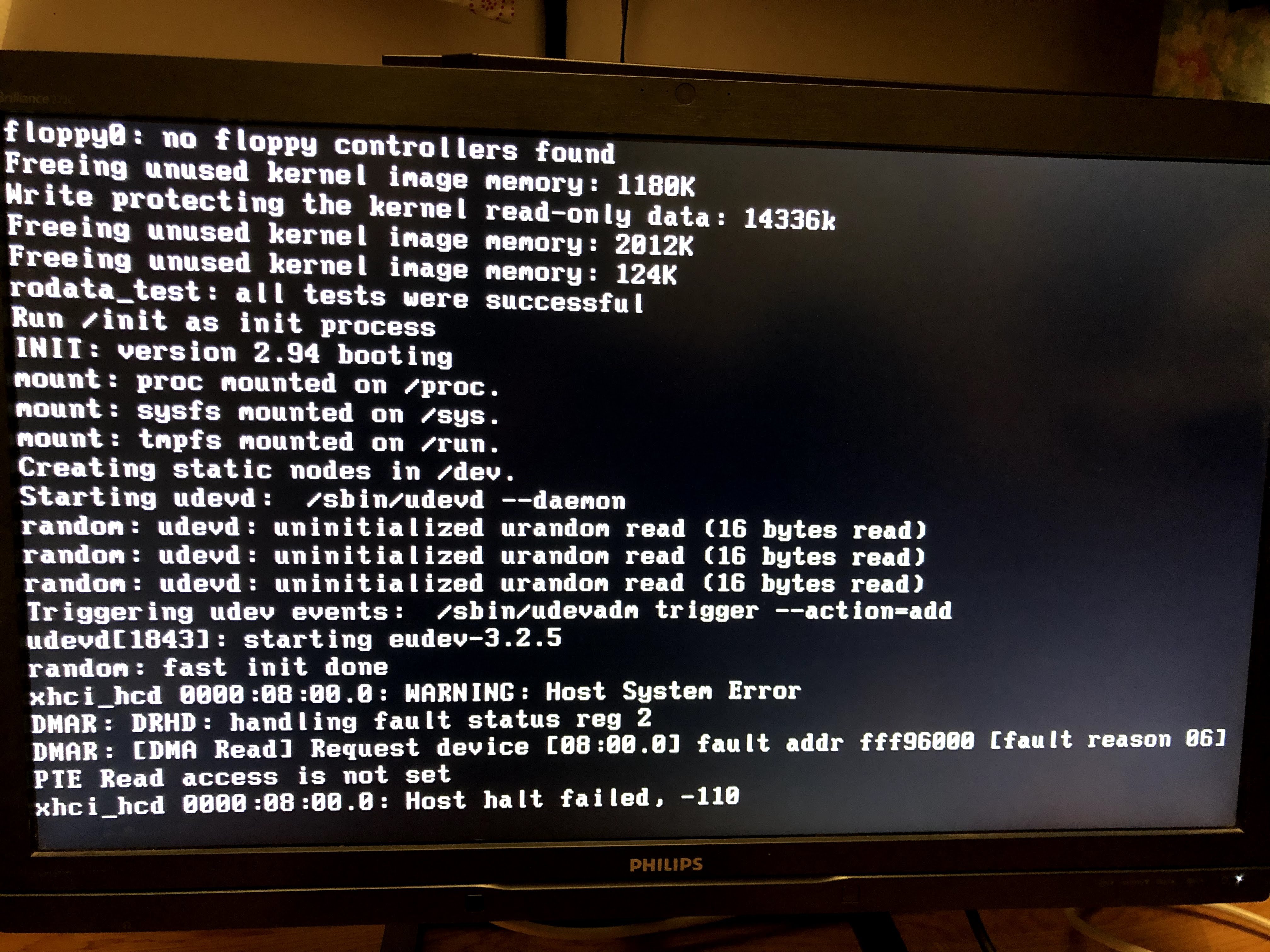

I would like to try to pass through a GPU to a windows 10 VM and turned on intel virtualization in the BIOS settings. However, when I do this, unRAID does not load normally. I have attached some screenshots.

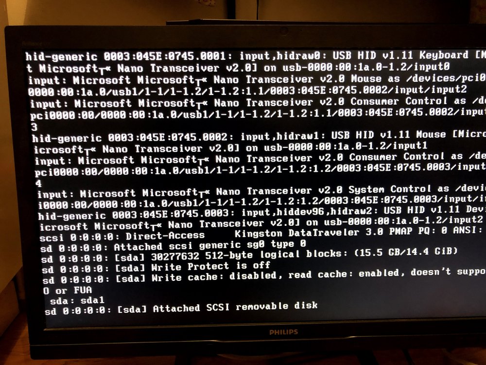

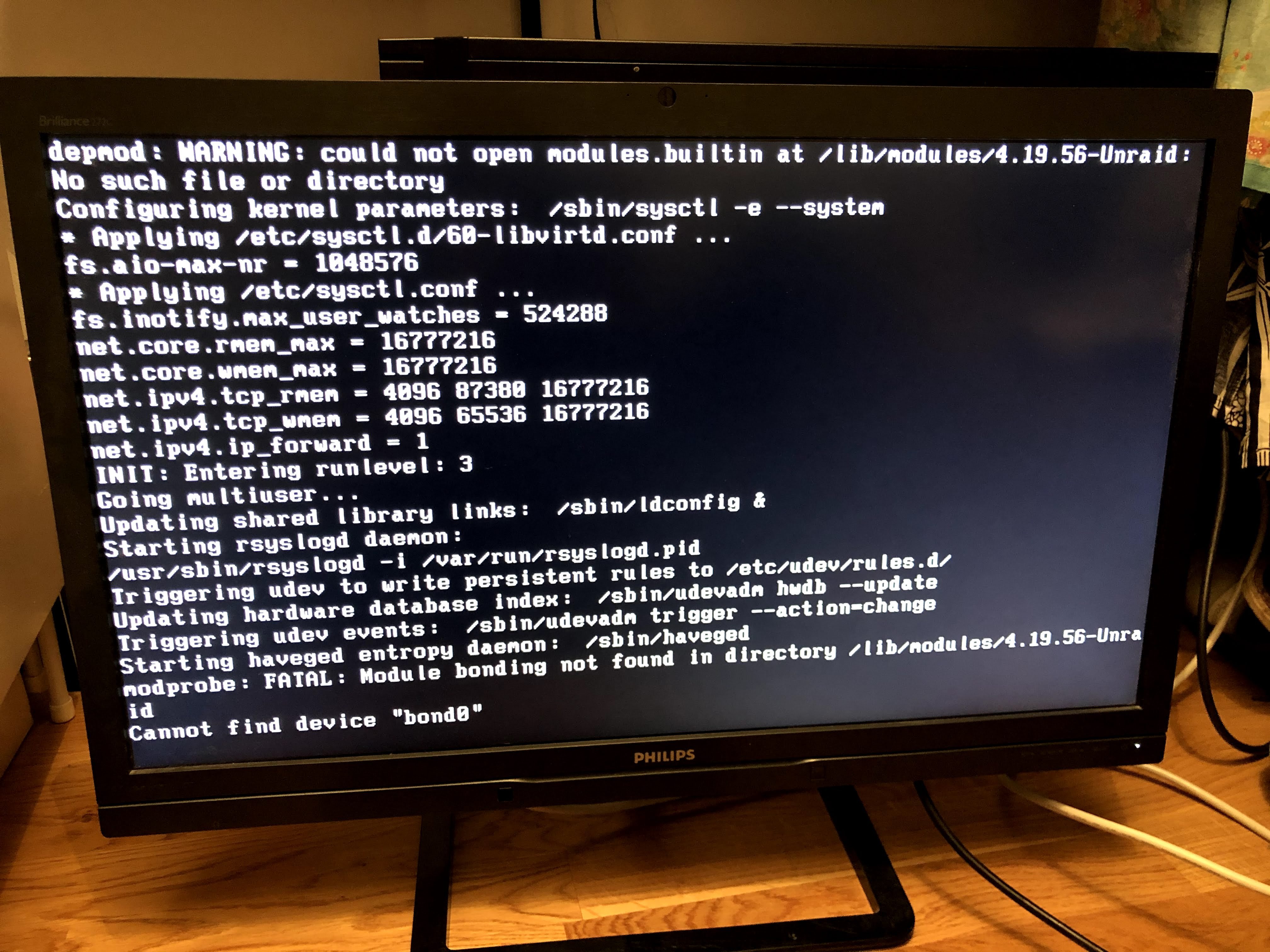

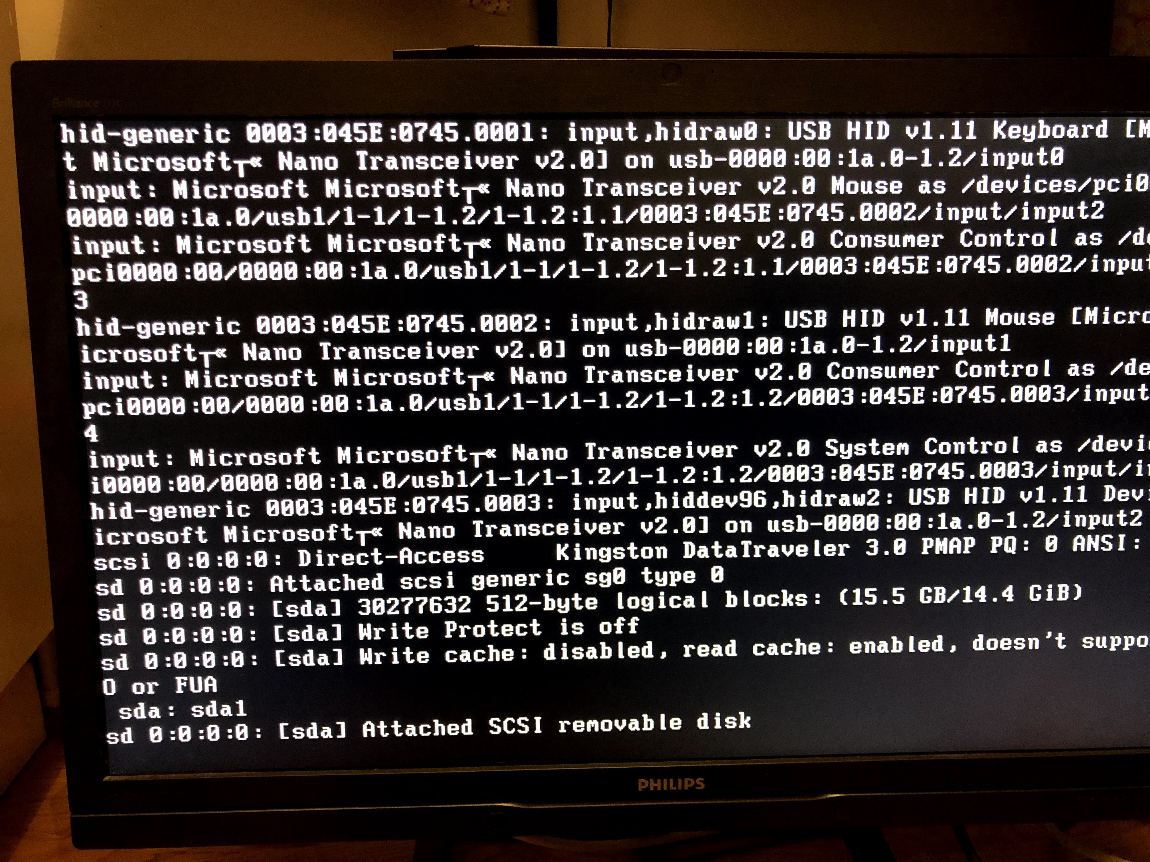

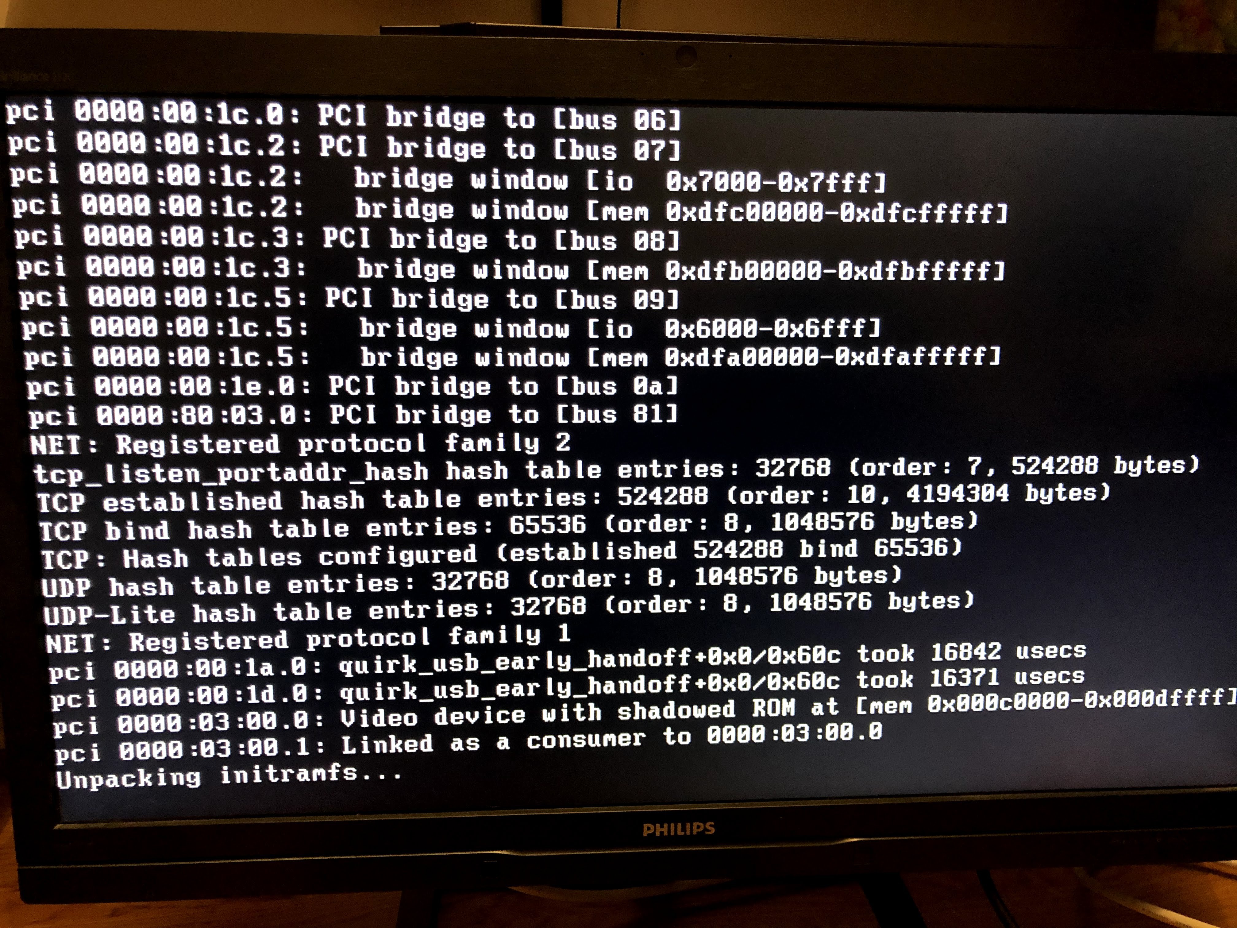

It seems to be unable to find some hardware. For example, I get one of those IP addresses beginning with 169.x.x.x that you get when there is no connection to a DHCP server. I also attach som pictures I took during the boot process of unRAID.
If I turn of intel virtualization unRAID boots normally and functions fine, but I can only assign VNC graphics to the VM:s.

An update: I got it to work by moving my Unraid USB to a USB2 port as suggested elsewhere in the forum.
