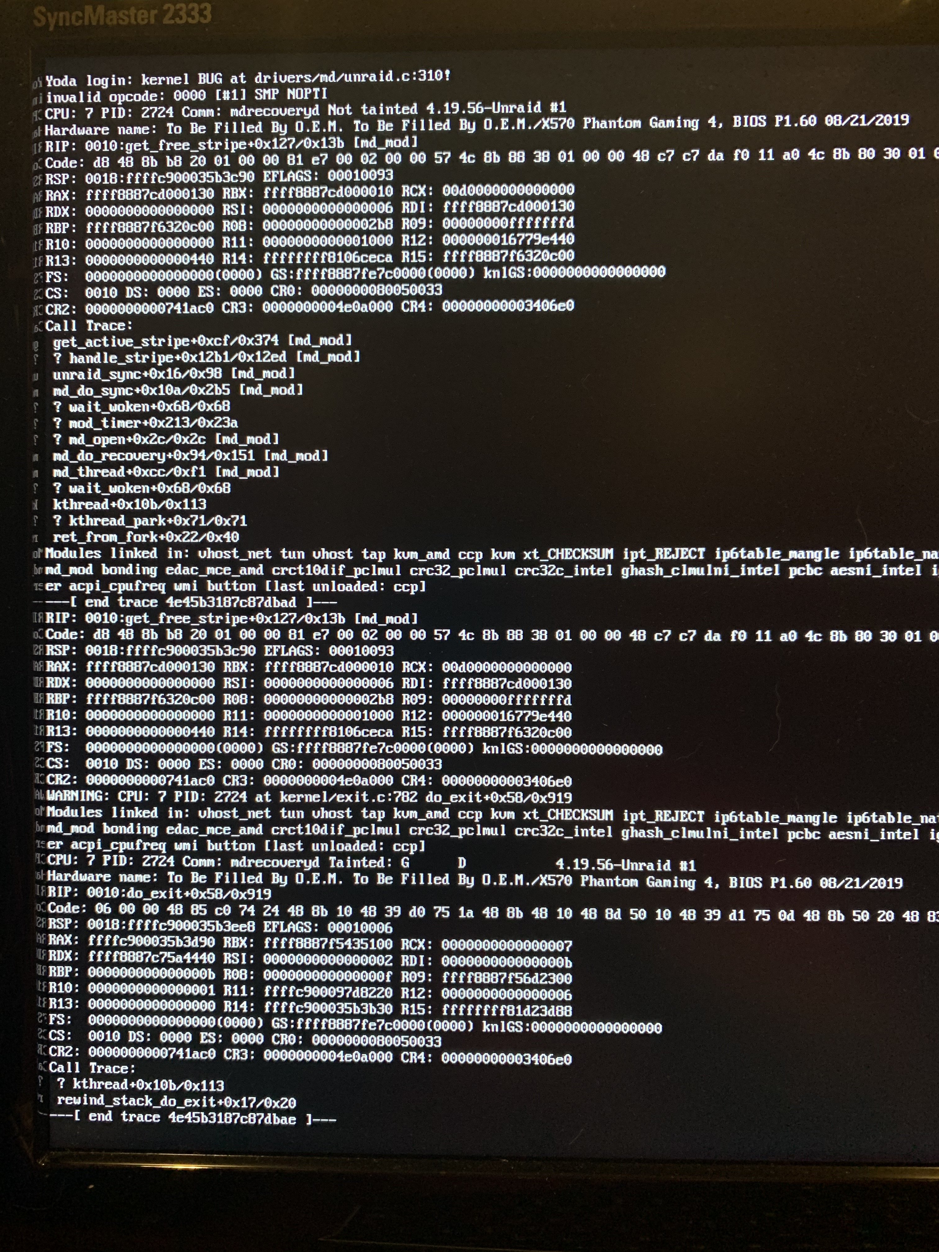

Very new user here.  I installed Unraid last night on a newly built server. I followed all the instructions I could find online on initial setup.  Server seems to work fine only to find that I cannot connect to it through the web browser after it's been running for a few hours.  I attached a picture of the screen I have every time it crashes.  I really have no idea where to go from there.  Any help is tremendously appreciated.
I have a 6 HDD setup (2 for parity) all the same model, with 2 nvme drives for cache. Brand new mobo, CPU, RAM, etc.

Memtest will only work if booting legacy, not UEFI, also Ryzen on Linux can lock up due to issues with c-states, make sure bios is up to date, then look for "Power Supply Idle Control" (or similar) and set it to "typical current idle" (or similar), or completely disable C-sates.
